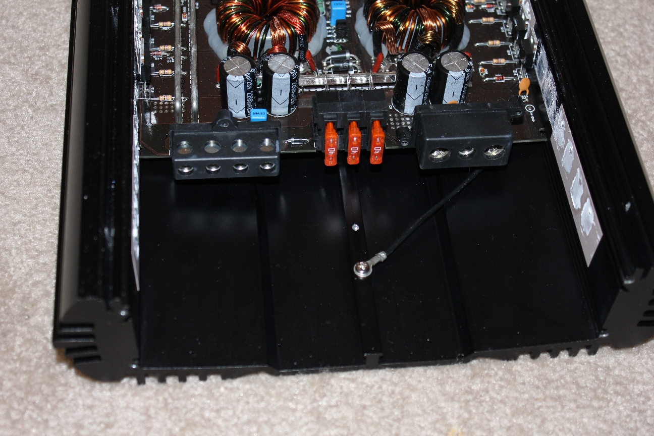

So I popped the back cover off and started inspecting.

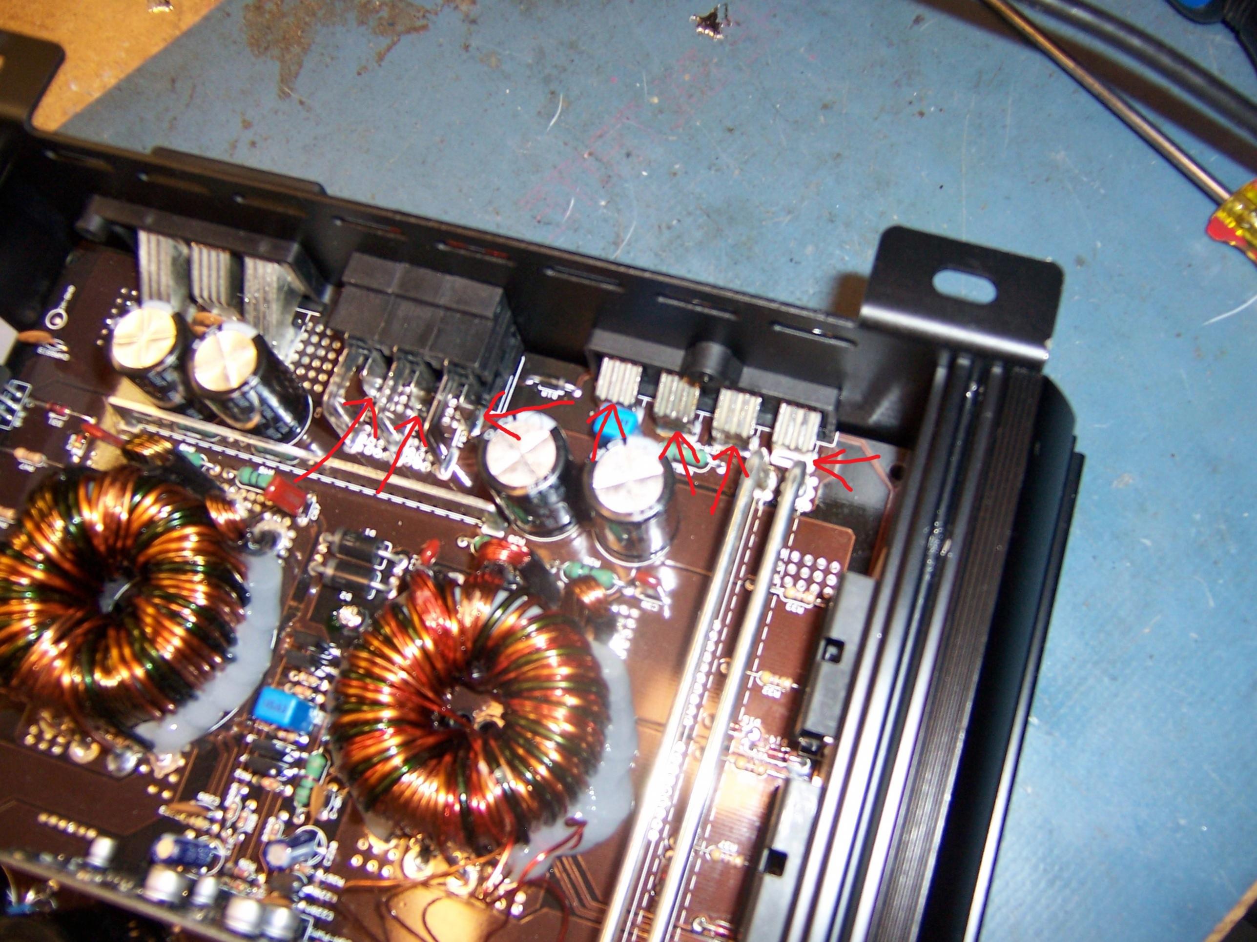

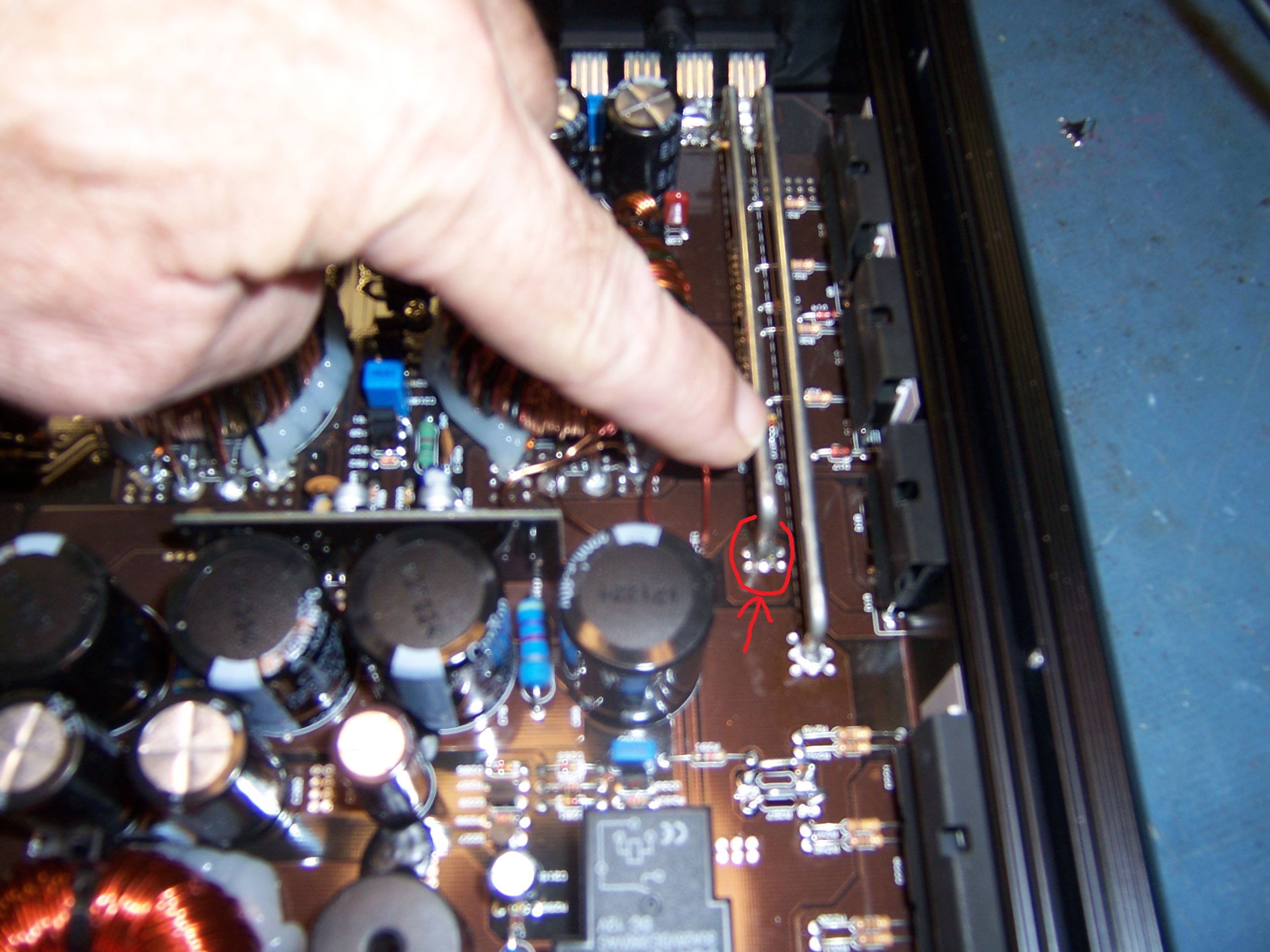

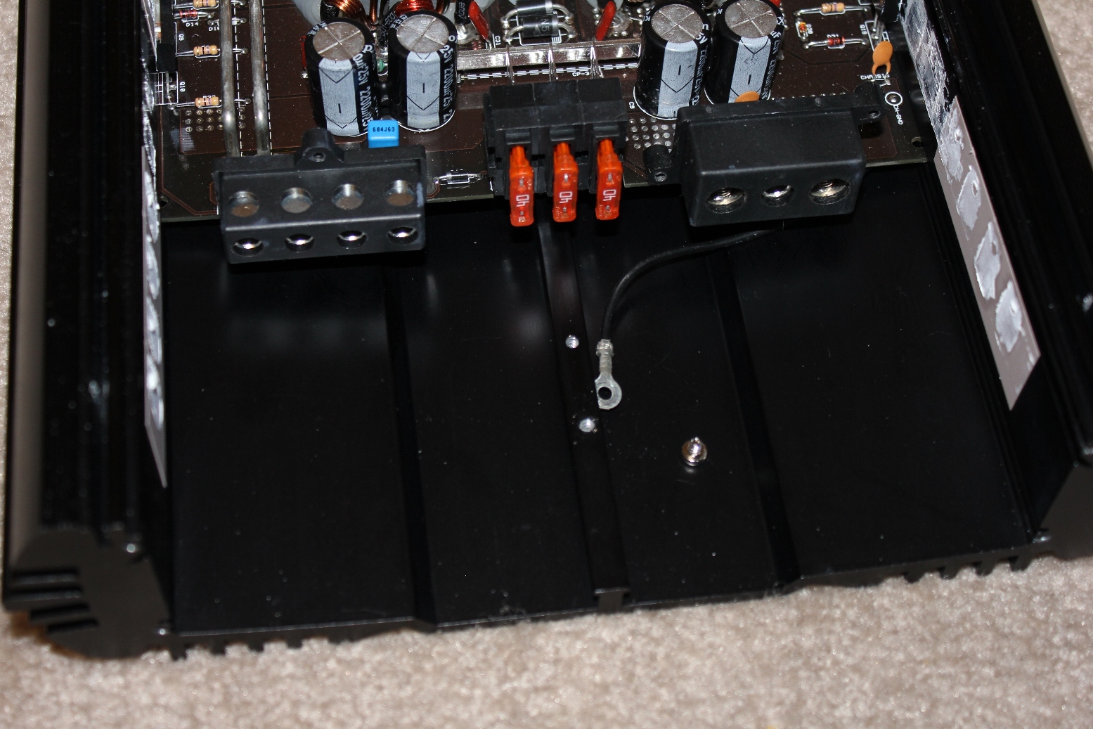

I found the negative speaker feed buss bar very loose, I could move it about 1/4 inch back and forth. The solder job was very poor, they shouldn't have soldered it at all.
Second thing I found was the fuse holder legs, just the back row, that are connected to the board, barley had any solder on them. So up to 120 amps going through a very small conduction area, hmm.
Third thing was the speaker output connector legs that are connected to the board had very little solder on them and I could see through the holes were solder should be. Again, very small conduction area, hmm.
I re-soldered all of these issues and it has a lot more punch. Seems to keep up with the soundstream now.
So the load was trying to suck current through these weak areas...
Wonder how many have this problem. If you own one, you may want to check these areas for this issue.

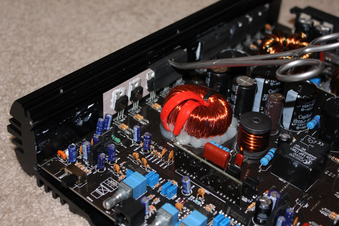

Update
I decided to take this amp apart to see anything wrong. I will post pics.

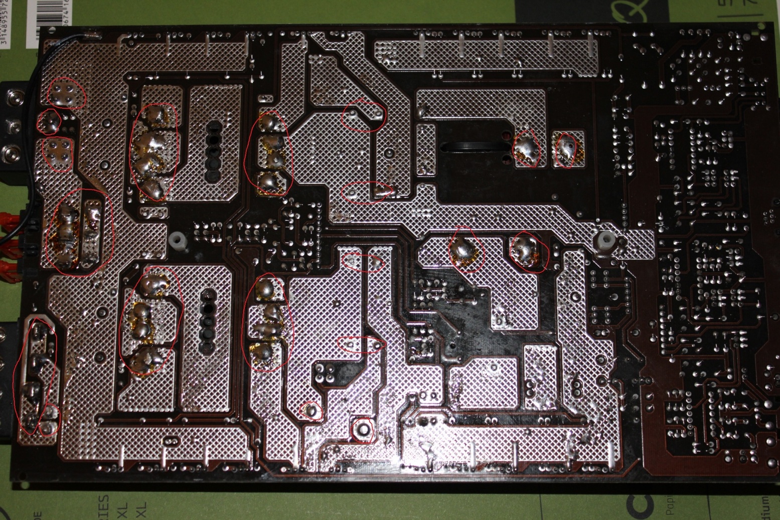

I re-flowed all the heavy solder joints and inspected all the mosfets and dual diodes for broken legs, everything was fine.
I was quite impressed that they used decent mosfets in the power-supply!
On my bench... It seemed to work great then I plugged the remote gain control in... That's when I started getting lots of rumble and noise until I bumped and moved the plug at the amp end. So the main problem is the remote.
I've had it in my car for a week now, without the remote, and it's doing a fantastic job. If I plug the remote in, things go south.
So re-flowing some solder joints and disconnecting the remote, there seems to be zero issues with this amp.
So now I have to chase down the problem with the remote.

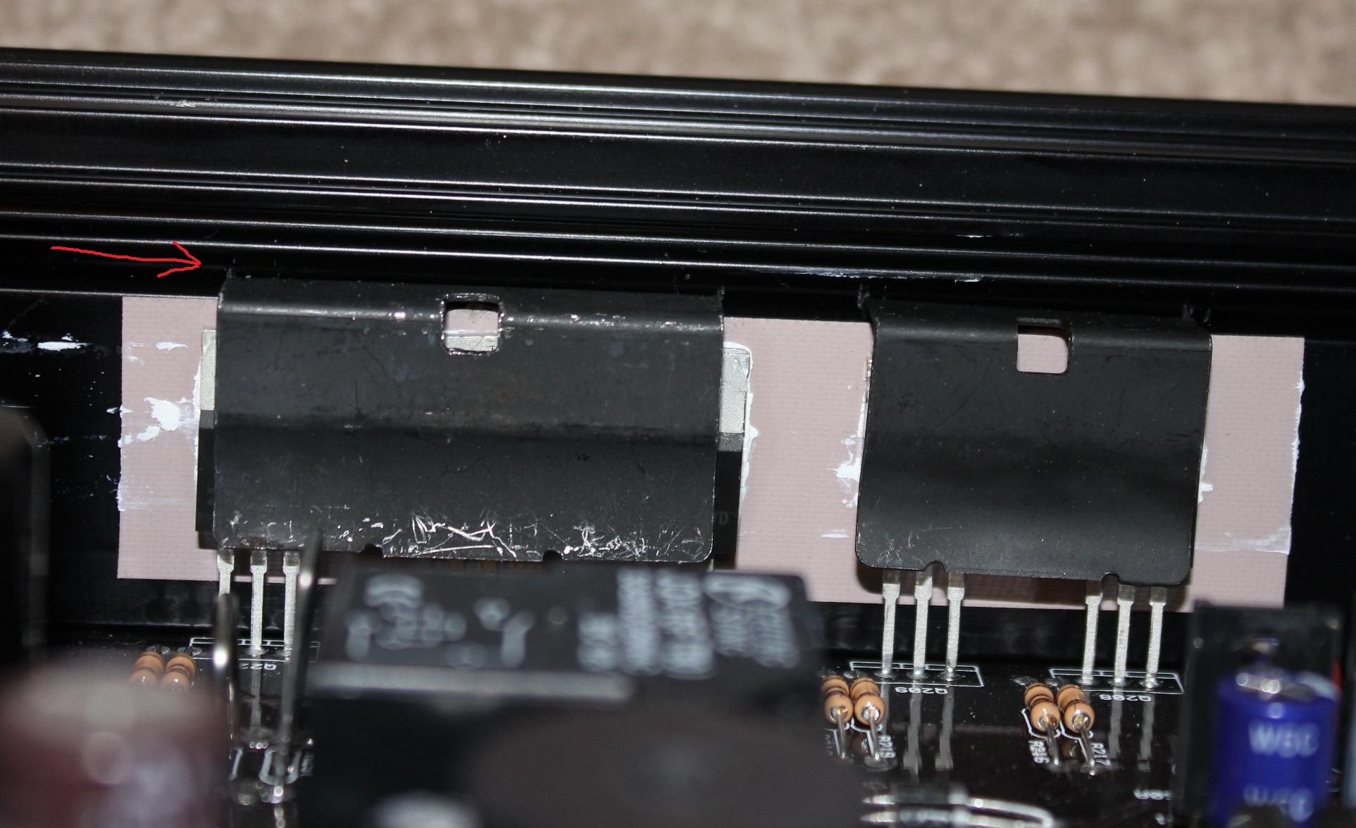

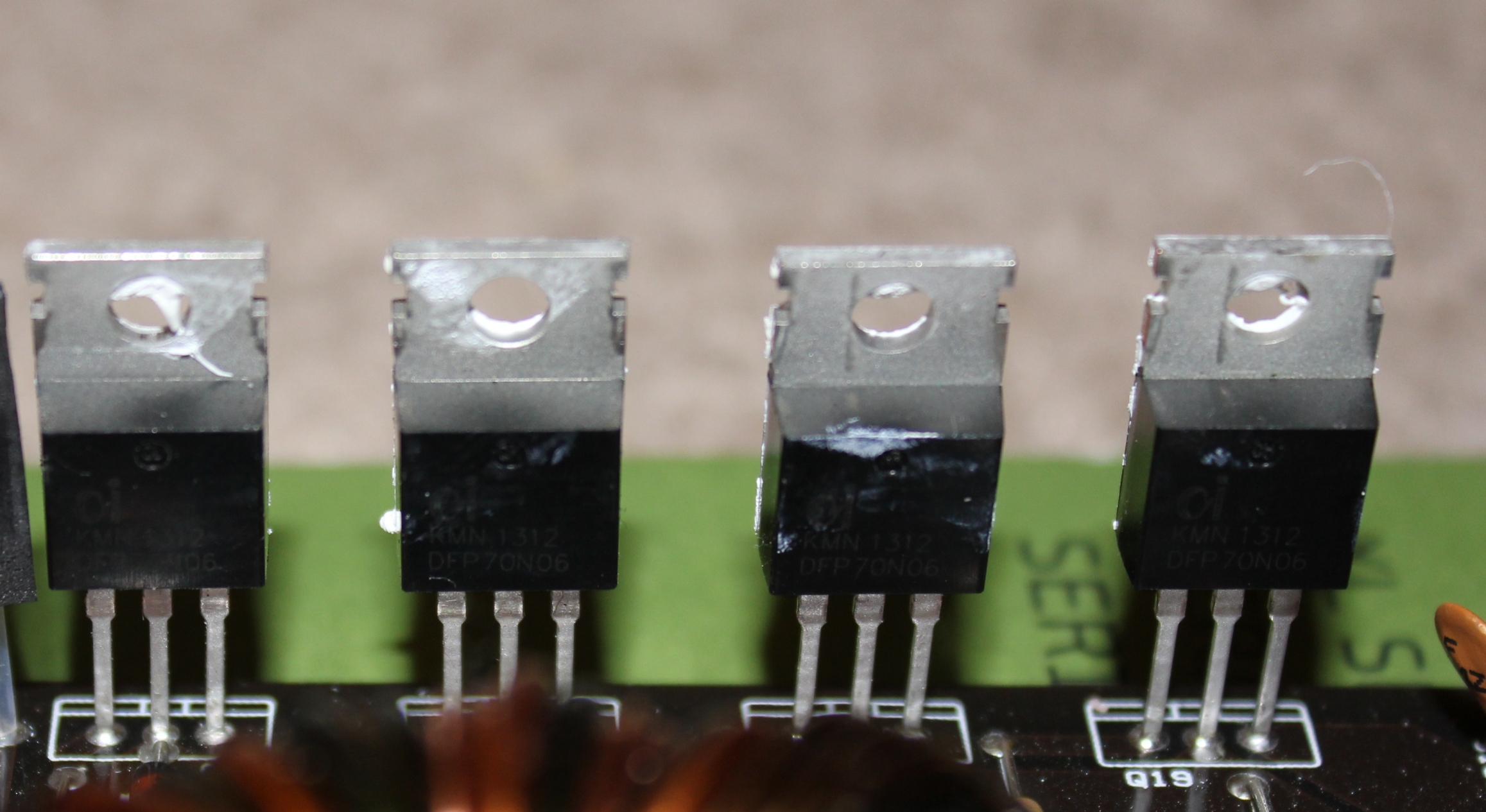

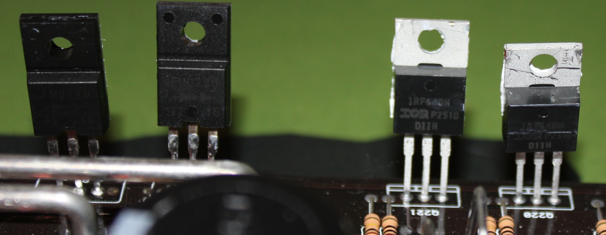

This thing has 8 of these for the power supply...
DFP70N06
Low RDS(on) (0.014Ω )@VGS=10V
Low Gate Charge (Typical 70nC)
Low Crss (Typical 160pF)
Improved dv/dt Capability
100% Avalanche Tested
Maximum Junction Temperature Range
RDS(ON) = 0.014 ohm
ID = 70A
BVDSS = 60V
And 4 of these for the rectifier...
FMU22U
V RM (V) 200
IF (AV) (A) 10
I FSM (A) 65
50Hz
Half-cycle Sinewave
Single Shot

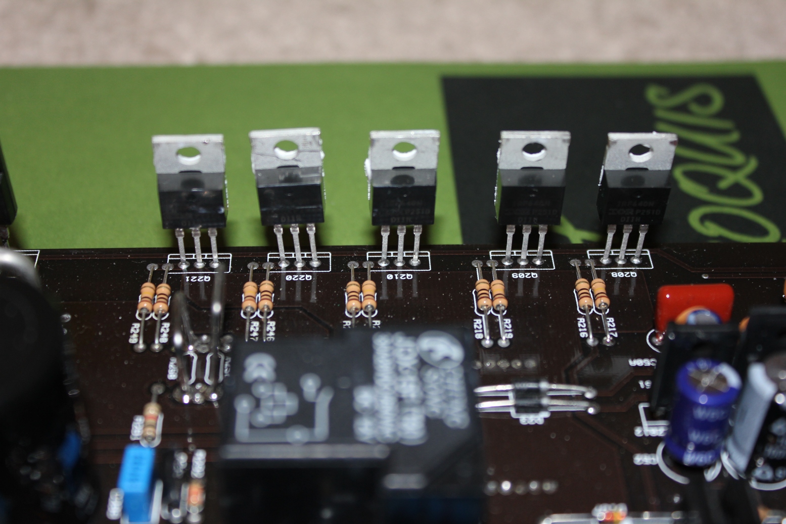

10 of these for the finals
IRF640N
VDSS = 200V
RDS(on) = 0.15Ω
ID = 18A
3 TL074CN opamps

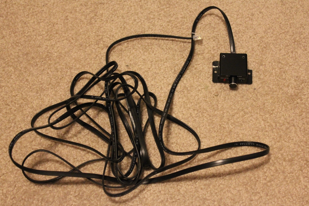

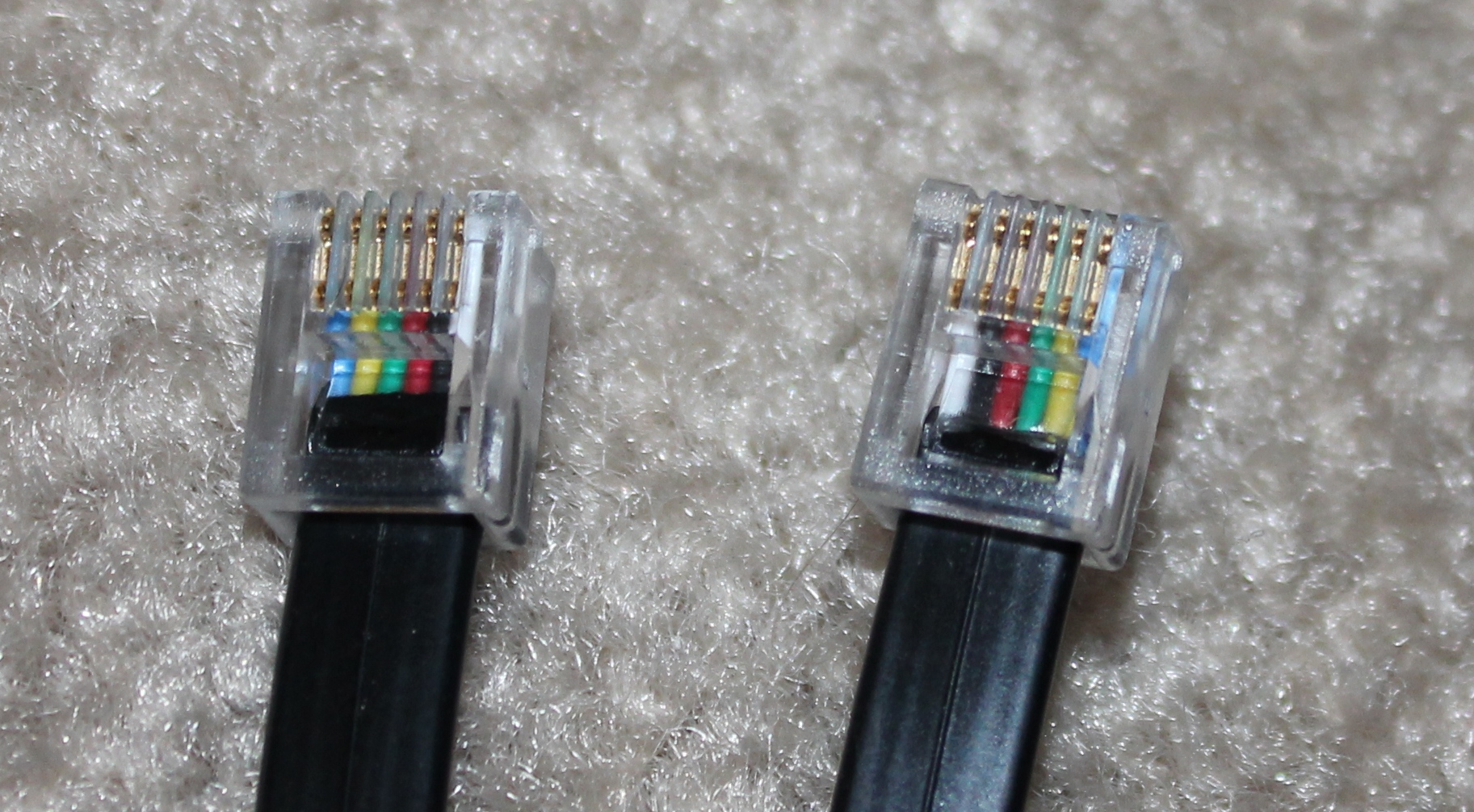

This long cable seems to be the culprit. I put together a shorter one with new ends and the noise disappeared, at least on the bench.
Notice the way the colors are in the connector, they are opposite
Just beware if you make your own.

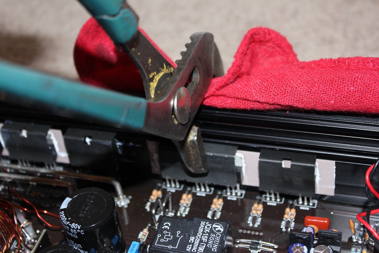

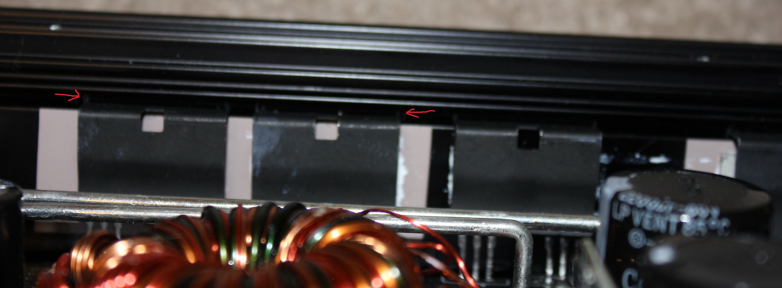

Putting it back together...
Make sure the clips are fully seated. I got most of them with my fingers but had to use channel locks for a couple stubborn ones
Now to test it in the car again... with the remote

Yes its brand new. It has about 6mv of dc offset. The problem was the connectors on the ends of the remote wire. Caused all kinds of rumble and noise. Very clean now😉

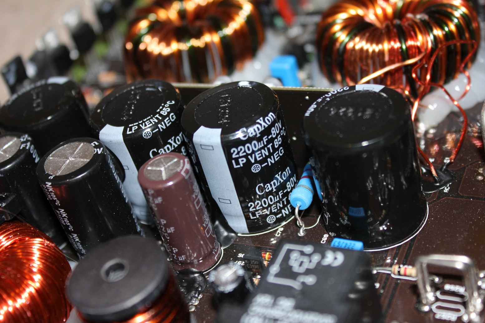

and i see there's "capxon"
change them to something better maybe? 😀
great to know your amp works good now 🙂
Sure, after about 4 or 5 years they should be changed. It would suck if they leaked.
I did measure the ripple coming off the rails and it was about 60mv on each side.
Panasonic caps will be put in.😀

I wouldn't worry about it, as I've seen some VERY HIGH end expensive amplifiers that had the same Capxon caps...heck are KELNA rip off of ELNA?
