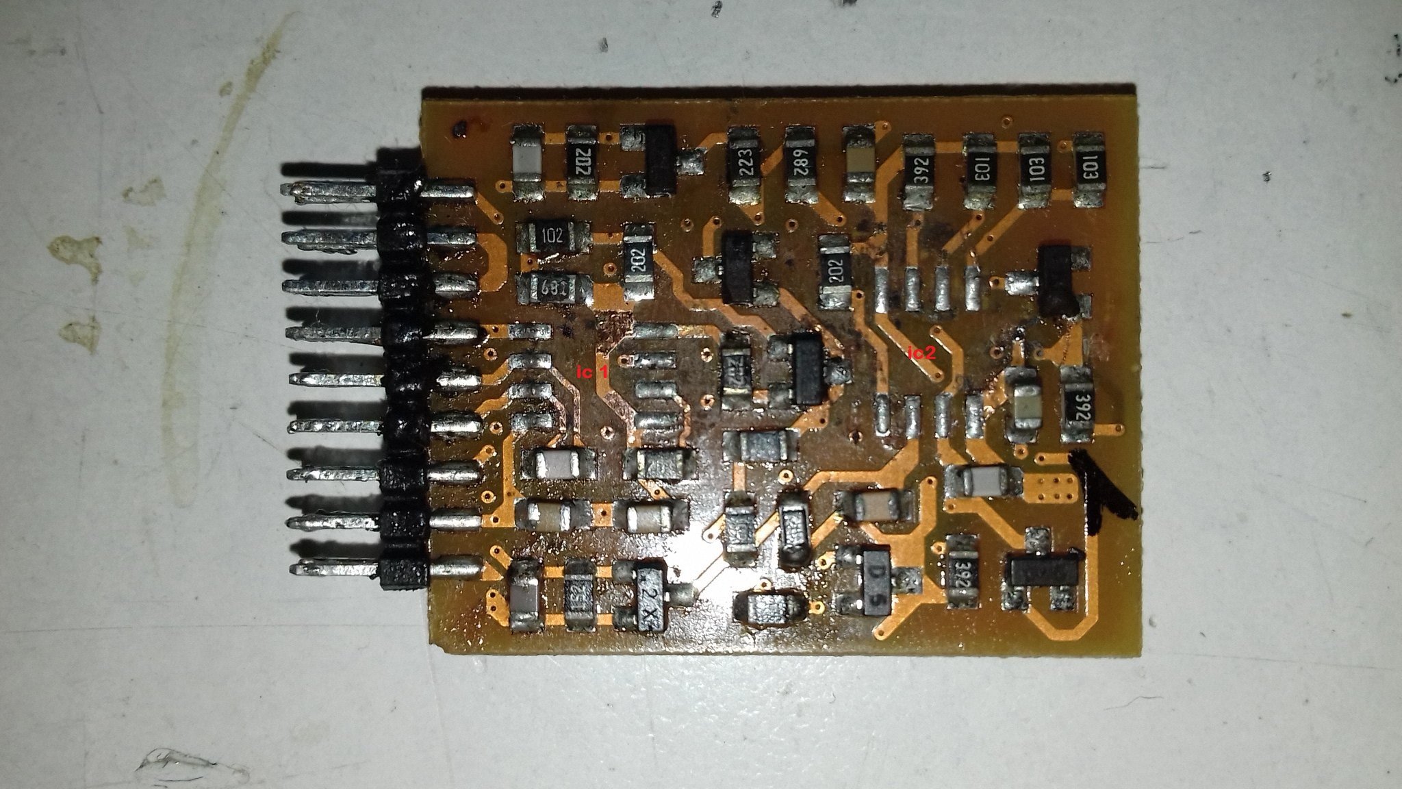

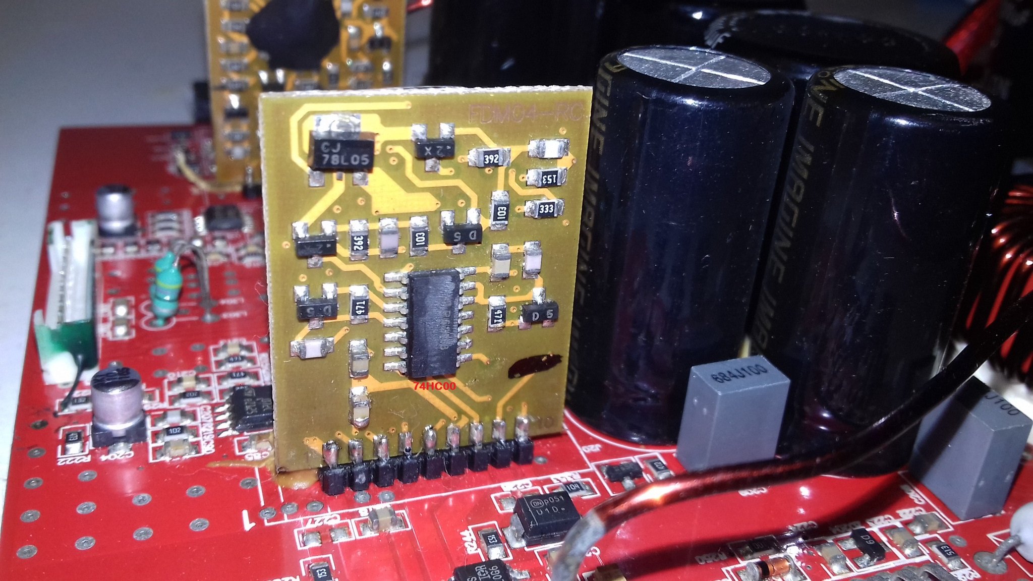

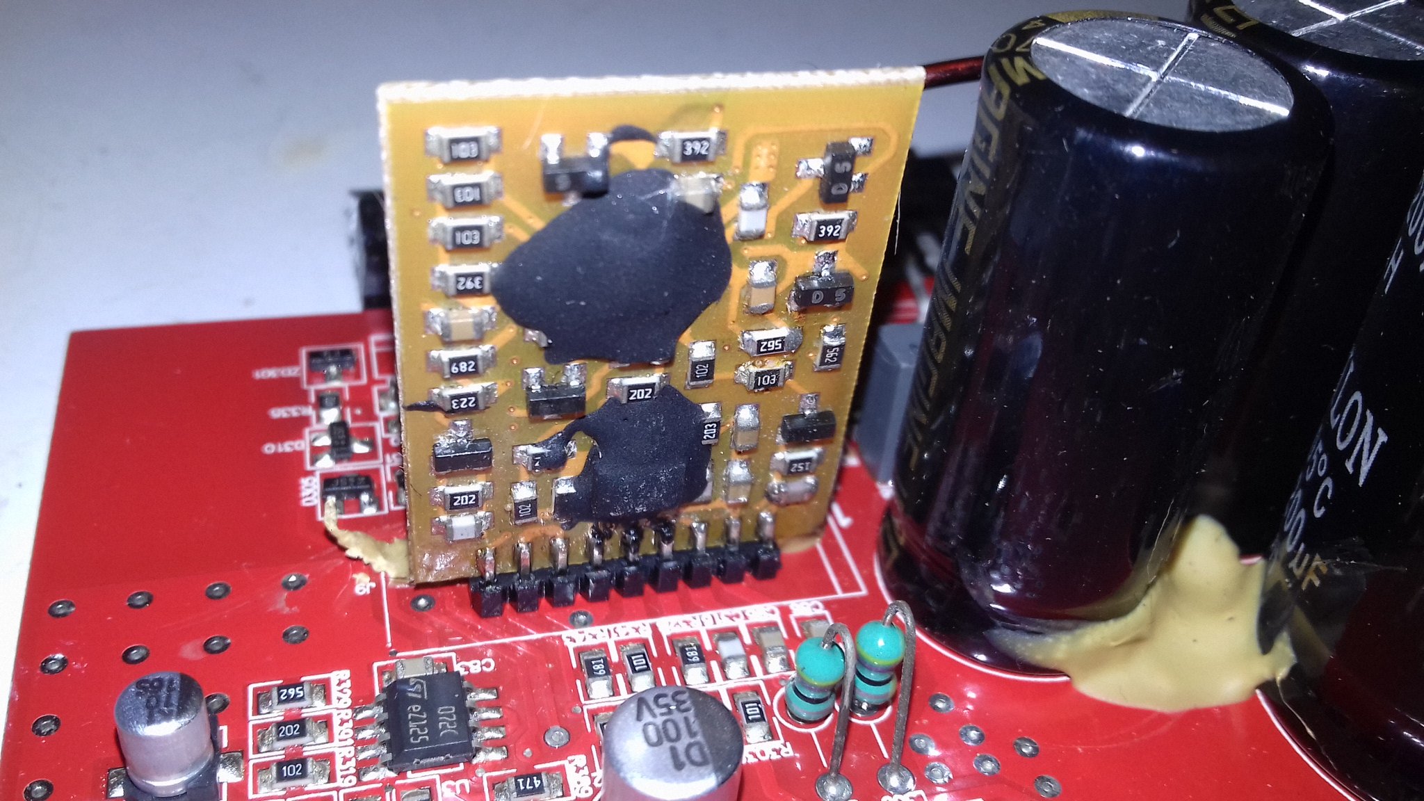

Bonjour, j'aimerais réparer un ampli mais je ne connais pas la référence des pièces 1 et 2. J'ai besoin de votre aide.. merci
I don't have a diagram for this but it's likely a clone. I was trying to find something similar.
Can you move the iCs out of the way so I can see the traces under them?
IC on other side?
IC on other side?
Am I looking at the orientation correctly? Are pin 5 and 8 directly connected?
Isn't pin 8 the +12v input to the IC?
The pin configuration looks like it could be an LM211 but that seems like an odd IC to have for a non-switching stage in the amplifier. Hopefully, someone else will have a more definitive answer.
I'd use the original IC2 unless you find that it's defective. Then, if it works, you can experiment with others in that location.
hello , i installed lm393 working now.dc out gone
