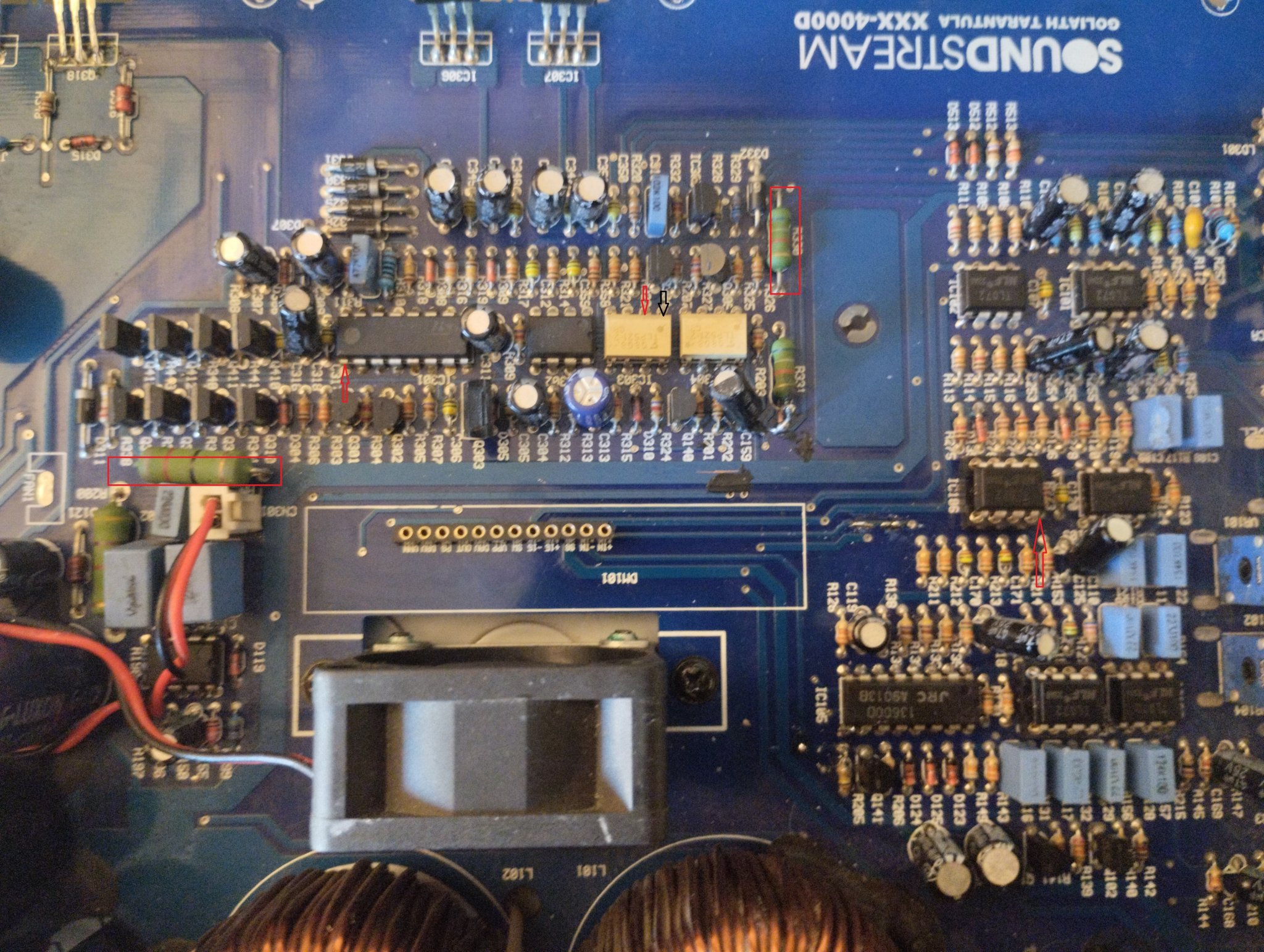

I new on this forum and i would like to ask if someone could help me with this chinese copy of korean board.
It's arrive with all power mosfets burned also 3525 was burned, i replaced all power transistor and IC and it start to power on, but after it start to have anomalies with a sound,( only half sinus wave is out) and something strange with a power supply.
There are some measure that i take maybe someone can understand whats going on with this amp.
Measurements from central GND. Dc supply on 13.1V. Measurements without driver board.

Also R330 is very hot and when i try to touch it with multemeters probe i start to hear some noise from power transformer ???
I hope someone can help with this issue.

The attached is close to what you have.
Some of the voltage need a primary ground ans some a seccondary ground. To make this easier, connect the negative speaker terminal to the primary ground. Then repost the DC voltage on pins 15 and 16 of the SG3525.

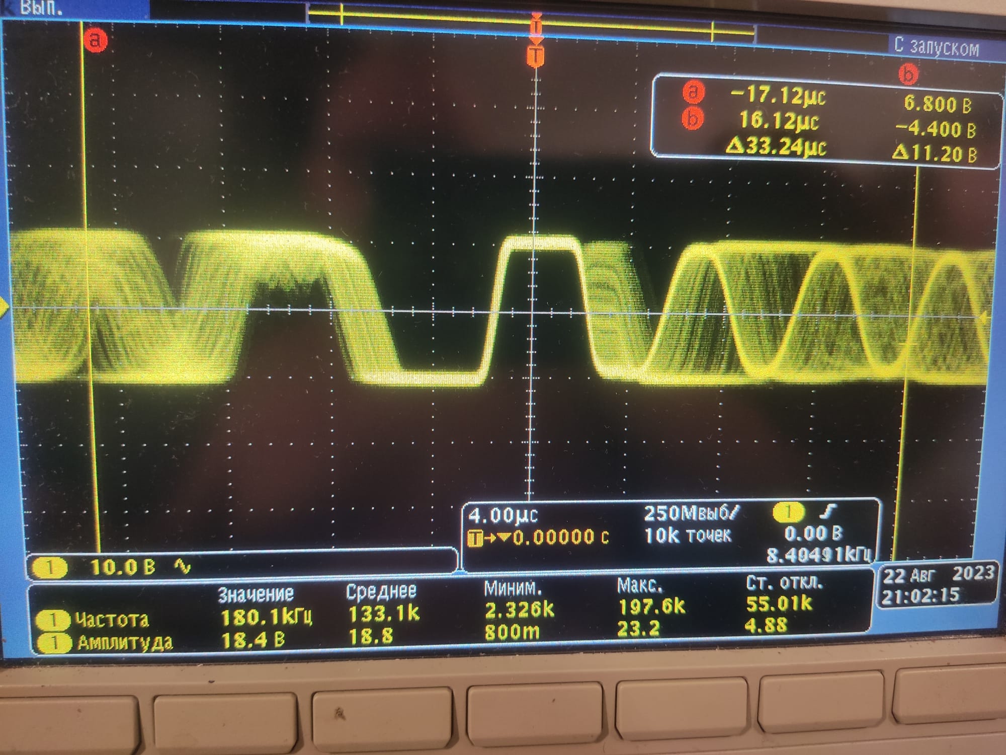

For now i haven't zener perhabs, i do another couple of test and i attach pictures :
1. pic of audio output wave
2. pic of switching of final audio transistors. (seems some problems with driver) ? no square wave clean...
Maybe pictures can help to understand what's wrong with amplifier...
Seems work half bridge only...

It's not going to be a clean switching waveform with audio. Drive audio into it then remove the audio and it should remain oscillating.
Are you seeing a perfect square wave entering the driver board?
I have on DRV and OUT perfect sine wave also without audio signal.. Maybe i do something wrong? How it possible ? i need to see square wave not sine wave ...
Which ic start oscillation fo driver board, i think we have some problem with it.. But i remember that without final audio transistor square form were perfect...could output inductors and capacitors to create this kind of problems?

It won't oscillate at high frequency without the output transistors in the amp but it will pass the input signal to allow you to test the signal up to the outputs.
