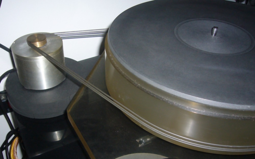

Looking for a round belt ideally 2-2.5mm thick to drive a 310mm platter has proven to be more difficult than expected. Or maybe i am approaching this the wrong way.
The flat belts that fit my platter are about 1020mm long so i assume a suitable round belt should be of similar length. Haven't had much luck finding one so far.

Try an O-ring seal, not the sticked one, you can find them in a lot of sizes at a bearing shop.
Splice a few sewing machine belts, or a meter of O Ring
Buy excess quantity of it, to experiment.
Get synthetic rubber like nitrile, more durable.
Cheap here, 30 cents a meter or so...

Like I said, get proper extruded rubber cord, it is about 50 cents or so per meter here.
Molding a piece of rubber means you have to spread compound in the mold, and heat it up, then remove the flash....injection molding is also possible for that item.
But 1 meter long / pi is about 160 mm radius, you need a diameter of 320 mm, and a larger plate size.
That is a fairly large mold, I wonder how many people will make it for you, because in a small run at least 4 of 10 will be scrap.
The best and reliable solution is a spliced O ring cord.

Laying it "double", it measures approx. 91mm in length. The diameter/x-section is 2mm 😉Do you, per chance, have the sizes?
This is for the Forte, which i bought. Don´t know the length of the Forte S. Platter diameter is 310mm.
Bought belts for Forte. Unfortunately they are much longer at 140cm as on would surmise from the monstrous platter they drive on the Forte. Unusable in my case.
