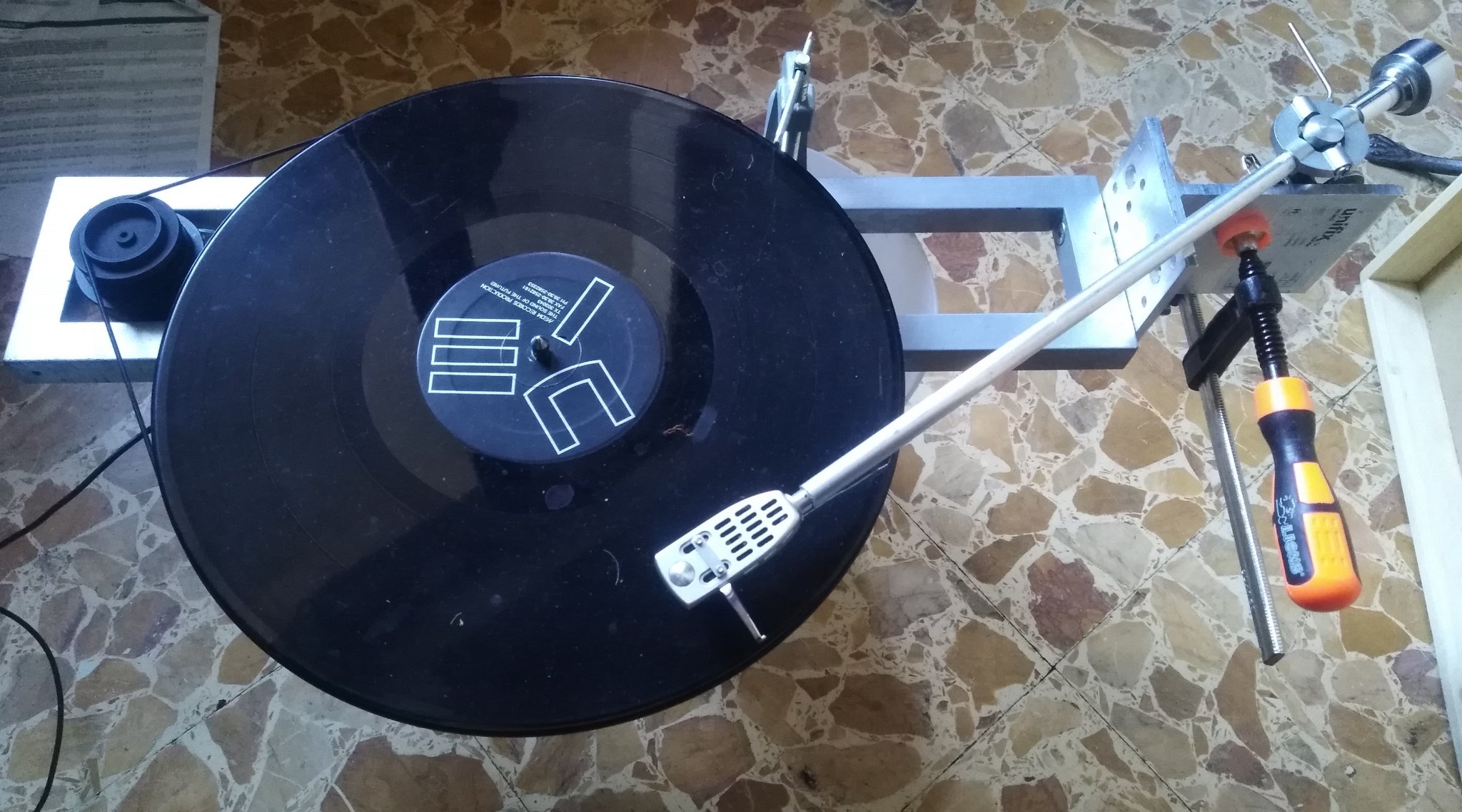

Not the bearing, but the motor and the belt...( my attempt to a 10 " tonearm, platter&bearing from Pioneer PL12)I don't rate any of the turntables that are listed as using that Pro-Ject bearing.
Oops, I have no experience of the Pro-Ject motor/belt. However the fact it is from Pro-Ject is enough to push my skepticism alert off the scale. I hope that it is wrong! Fantastic proto table BTW. and the rim drive is the way to go to minimise motor cogging and belt noise being transmitted to the platter.Not the bearing, but the motor and the belt...
Well, they do sell a pulley for flat belts ( 60 € IIRC ) made of steel.
