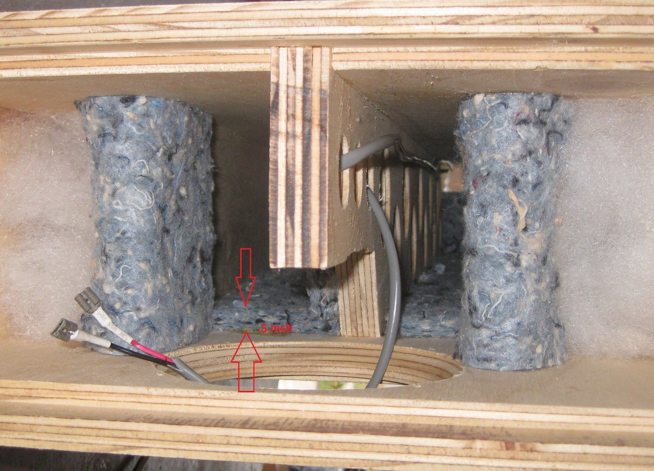

As I found when building the M10-A10s, the 2" material is rather tightly felted and really rather a pain in the azz to separate evenly and heavy duty fabric shears are required to cut cleanly. Still does create a very small amount of dust when handled thus, but certainly far more friendly than FG
A 1" thick version would be very useful for such builds.
Tom: the 1/2" version that we get locally is backed with a black fabric, to which I find that white PVA - Weldbond, etc ( we actually use a product called Roo Clear Melamine glue) sticks very well.

Very similar to the fabric backed version we source through Bob as CSS - the bonded backing allows for easy use of white glue, and I've found it flexible enough to wrap around end of the center divider of FrugelHorns - clamp for about 1/2 hour and you're good to go.
