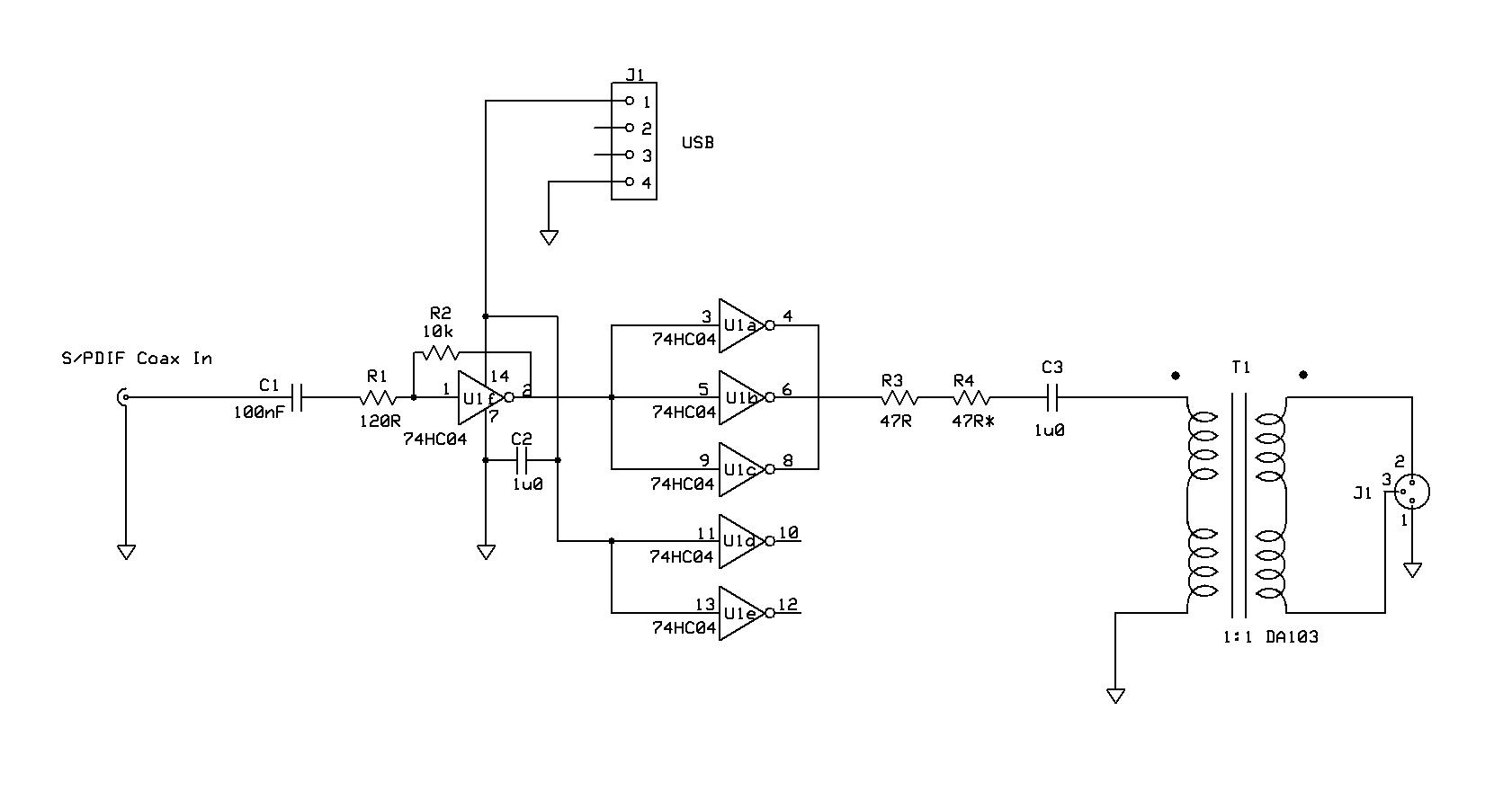

There's a few ways to take care of the levels- there's also some subtle code differences, but they aren't of great concern for home audio use. Here's the schematic of the adapter that I built- the output transformer is a standard inexpensive Murata unit that I got from Mouser or Digikey (can't remember which).

Are the hex inverters in your schematic for the "subtle code differences"? I will take a look for the transformer.
I guess one thing in the back of my mind re this conversion is whether a SPDIF to AES/EBU conversion without the higher voltages of the later is worth doing - if I understand the differences between the two correctly. Is getting a 110 Ohms impedance any gain over straight SPDIF?
No, they're just level shifters. I don't worry about the code differences since this isn't a studio installation. No, there's no particular advantage to AES/EBU over SPDIF in a home installation, they're just slightly different standards.

SY, I think your first link is the same article I posted to. As to the differences between SPDIF and AES/EBU in a "home installation" there is still a strong preference for AES/EBU in the high-end segment. I guess my first question is whether people prefer the latter because the voltage signal is stronger. I'm trying to understand what you mean by "level shifters". You bring the voltage up to an AES/EBU equivalent?
Gazza49 - I'm talking about going the other way. If going from AES/EBU to SPDIF then the levels need to be attenuated and the impedance corrected. Here I'm talking about taking SPDIF from the Juli@ card and converting it to AES/EBU. Note that this is exactly what Bryston did with their BPD-1 and 2. I'm just not sure if all they did was provide the impedance transformer and leave it at that.
Also, isn't the turns ratio on the Murata DA103 transformer 1:1? How is impedance managed? (Sorry if these are basic questions given you have provided your schematic.)
Yes. Additionally, the output impedance is raised to the AES/EBU standard. The transformer is 1:1 because the impedances are already correct, all it does is provide galvanic isolation.

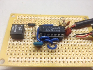

got it. I will spend more time with your schematic. I guess one would have to make this up on protoboard at a minimum.
Yes it does. In a box that would be difficult to wire into my audio server unless I pulled it to pieces. I'm intrigued by the advertisement's reference to 96kHz. Why not 192kHz which is what my ESI Juli@ sound card is capable of?
This is probably a super basic question but am I right that U1a-f is all one component and that you have supplied 5V via USB port? I will have to study the data sheet and see if I can figure out what's going on. I think I may be slow… 🙂
Yes, I paralleled a bunch of sections since it's a hex unit and they're there anyway. That drops the output impedance and lets the series resistors dominate it. And yes, I did it on a small protoboard.
