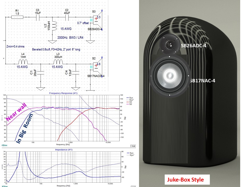

For diy, a JukeBox shape also supports good sonics in a naturally attractive shape.
