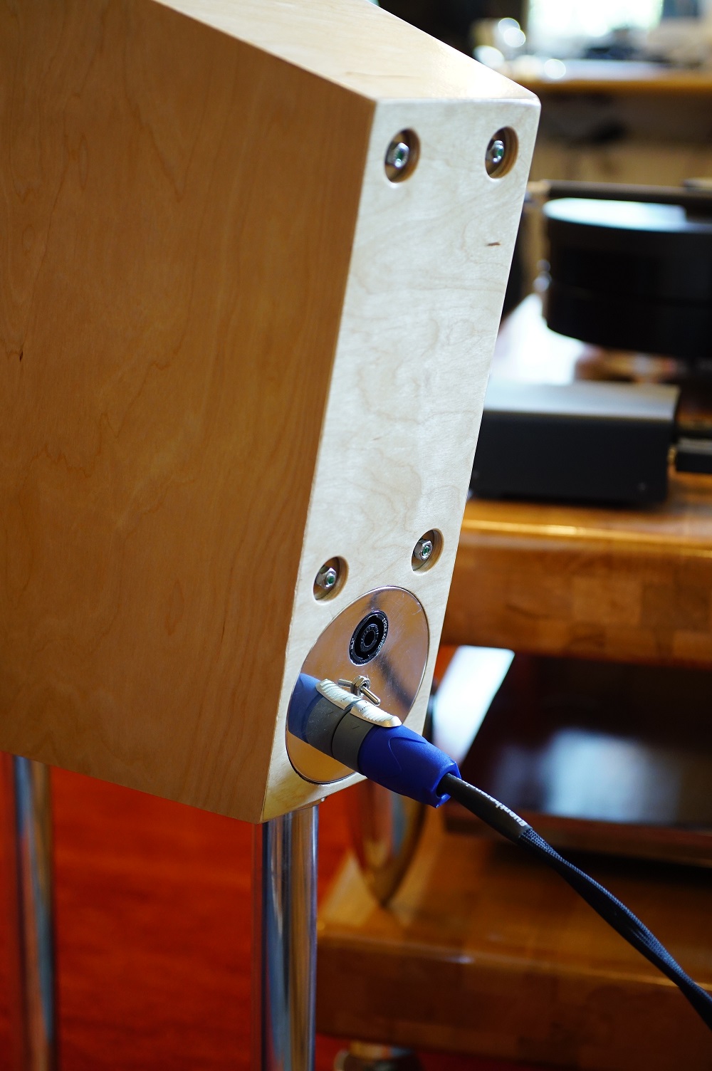

I just used my first Speakon connectors. The female socket that goes into the cabinet only needs a single 15/16" diameter hole, and the wires connect onto the back of that. You don't have to have a post long enough to go all the way through the cabinet.

Yep, SpeakOn all the way. Here's why:
- Lots of current capacity
- Physically rugged
- Cannot be accidentally shorted out
- Always connects the right way round
- Up to 8x poles in a single connector
- Easy to make air-tight
Chris

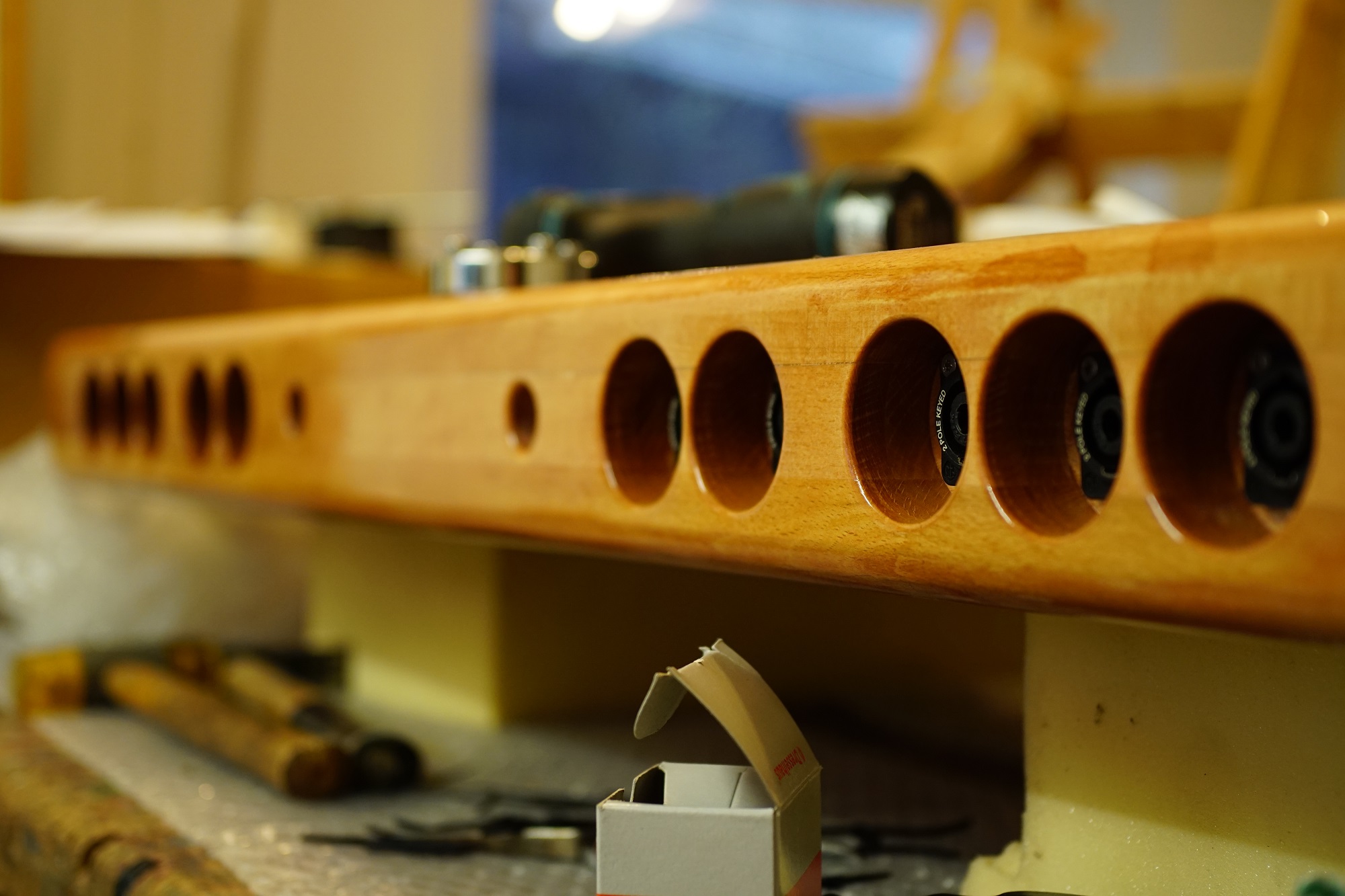

I use the 4 pole connectors and these base plates: Neutrik NL4MPR speakON Connector 4 Pole Round Chassis Mount

Here's my standard config for a main 3-way speaker, and a separate sub.
Back of latest synergy build.
NL-8 on left accepts all 4 channels, and is wired in parallel with sub pass-thru on first NL-4, Mid connection on second NL-4, and HF & VHF on third NL-4.
Allows a single 8 wire cable to feed all, or running separate cables to feed individual sections.
Subs have their own NL-4 inputs, to accept pass thru feed from main, or from a separate cable.
Have done every build like this for a long time....gives great ease of hook up for portability, and for testing / swapping sections etc.
