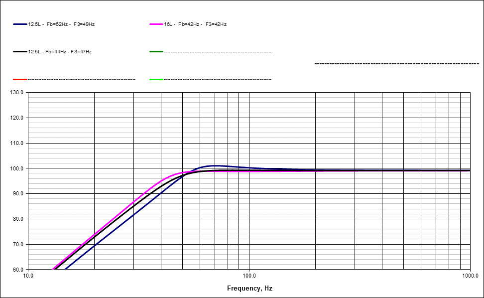

The box and port sizes are always dependent upon the given driver but there is flexibility depending upon your needs and goals. You are free to build a larger or smaller box and to tune it lower or higher, flat or peaky or with a more gradual roll-off but always dependent on the driver you are using and consistent with the relationships that exist for a vented alignment.
So for a vented box it's the net internal volume that matters, so the gross volume minus the volume occupied by the port, the drivers, any bracing, the xo and anything else solid that might be inside the box. Your internal gross volume is 13.9L, so you probably have something closer to the 12.5L net that Inductor mentions. Given that and a 2" x 5" port, your tuning frequency (Fb) is about 52Hz, F3 is about 49Hz and you have a 2dB peak at about 70Hz. See pic below, blue trace.
That's not ideal but it's not too bad and some people may actually like that kind of response. You'll get about 100dB at 1m with 20W before the voice coil starts moving beyond the magnetic gap as long as the driver isn't playing frequencies below about 40Hz - ie. before the driver's xmax of 3mm is exceeded. So loud movies without a sub will not be ok but music without a sub should be fine. A 2" port diameter at that SPL will not see excessive air speed so chuffing shouldn't be a problem.
That's basically all the important stuff you need to look at with a vented box. If any of it seemed like jibberish, ask for clarification.
Now ideally that driver wants about 16L net tuned to 42Hz with a 2" x 6.5" port (pink trace). F3 is about 42Hz and your peaking at 70Hz is now gone. So you're getting more LF extension here and none of it will be louder than the rest of the speaker.
For you, given only about 12.5L, the best you can do for more LF extension is to tune a little lower to about 44Hz with a 2" x 7.5" port (black trace). You lose the peaking again and move F3 a couple of Hz lower.
Personally, I'd probably try the ports you have right now and only consider changing them if you find that the little bit of peaking you get is being perceived as boomy bass.
All sims are with Unibox and based on the driver spec sheet. Real world results could be slightly different.

Hi jReave. Thank you so much for the insight. Now I'm beginning to understand what all the technical stuff actually meant.Obviously,there's still a long way for me to go before I may be competent enough to fully understand the intrinsics of speaker building.
About the gross internal box volume,is 16x30x29cm only 13.9L? So what would the internal dimensions be to get 16L? I built the boxes like a tower speaker with only the upper part to house the 2 drivers with an adjustable partition inbetween which can be moved to increase or decrease box volume.

For yourself, try 16 x 37 x 29cm = 17.2L , depending on what else is taking up space inside the chamber.
Try a port length of about 20cm to start. That's a tuning of 38Hz and an F3 of 42Hz. Then listen and if you think you want the bass a little louder, shorten the port to about 17.5cm. Listen again and again if you want the lowest frequencies a little louder, shorten to about 15cm. Somewhere in there I think you should find something to your liking.
