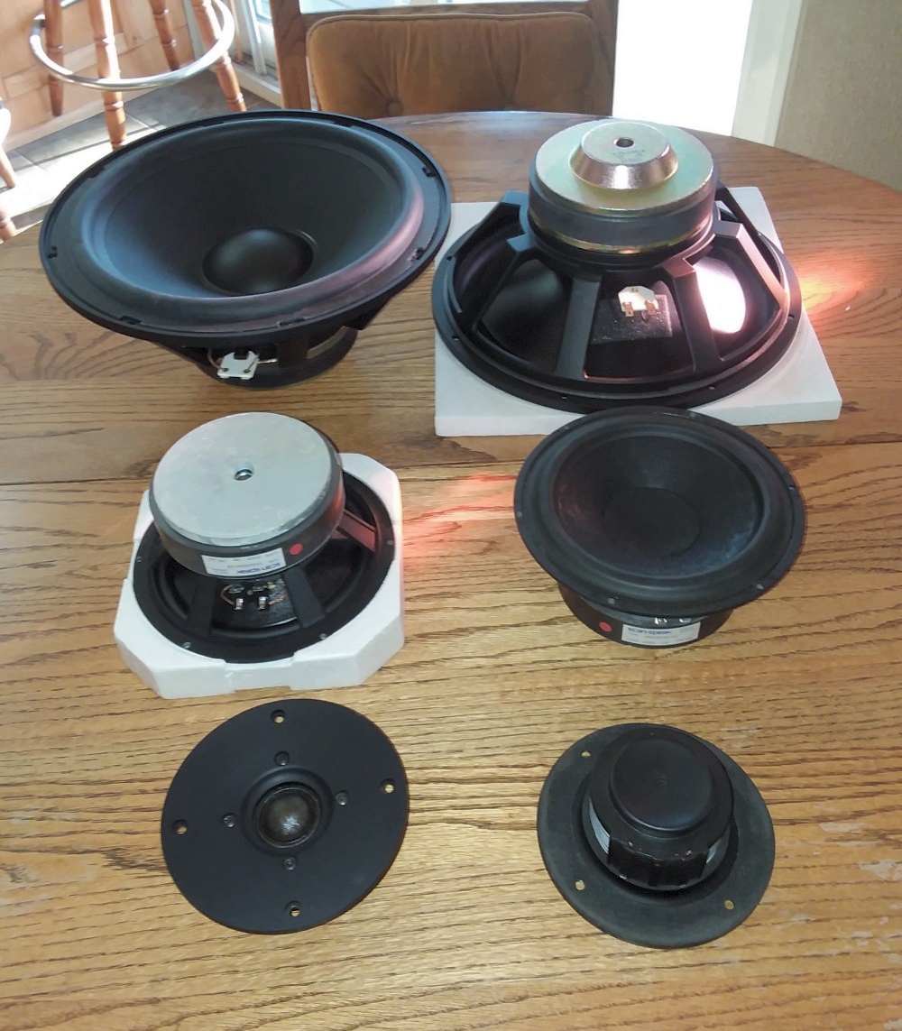

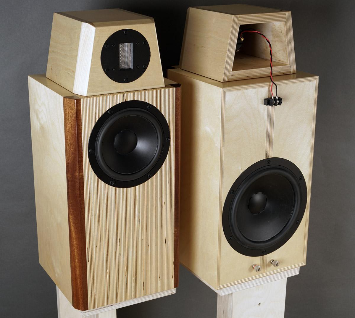

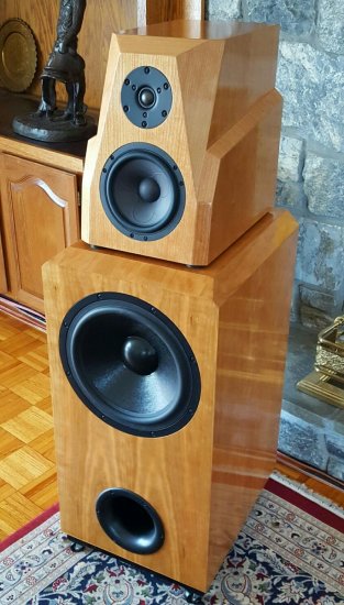

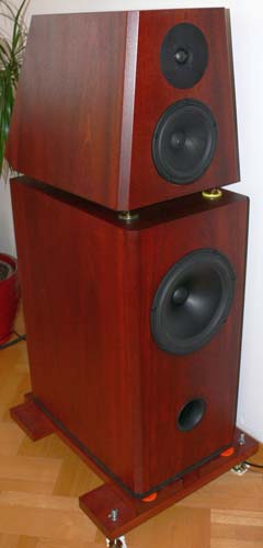

Hello all; I'm looking for some friendly advice for my speaker building project...
My current and long-time “hi-end” speaker system consist of 17 year old Audio Physic Virgo III’s, which offer more inner detail and resolution, transparency, and pinpoint imaging compared to my previously owned mid-1980's Apogee Duetta’s. And while the Apogee’s could produce prodigious amounts of bass, it was not as tight as I desired (especially after hearing the Entec SW-1’s). I’m not a loud-volume listener, but because the Virgo’s have limited bass extension, I chose to run them in parallel with a pair of line-level late 1990's Velodyne 12 inch servo subwoofers which I can blend well with the main speakers in my relatively large listening room.
Years ago I thought I would pursue an improved DIY speaker project that would offer even more of the above qualities, using what were considered then to be some of the best speaker driver units available:
Scan Speak D2509/9900 Revelator tweeter
Scan Speak 18W/8545-00 mid-woofer
NHT 1259 subwoofer
Since I lacked the requisite measuring equipment, knowledge, and experience to design my own crossovers, I was going to use the 2-way Scan Speak Reference Monitor, Brennwald's ScanSpeaker, or Madisound designed crossover that had been employed for the Scan-Speak drivers, in conjunction with a pair of sealed subwoofers for the NHT 1259's powered by plate amplifiers. The general design would follow the Tony Gee Andromeda speaker, which I find quite aesthetically pleasing.
Now approaching retirement, I have been bitten by the idea of building these speakers once again. Pulling the drivers out of storage, I discovered they are pristine. But I have become aware that after 15+ years, significant advancements with speaker technology have been made. I therefore have the choice to:
1) pursue the project as originally envisioned, or
2) sell one, two, or all of these driver pairs and invest in an updated design, such as those from Troels Gravesen, who seems to have a very good reputation and obviously is both very knowledgeable and experienced.
However, I find the potential number of possibilities bewildering. Troels refuses to make any recommendations, and I don’t have the time or inclination to become a serial speaker builder. Other than frequency response and distortion graphs, and without the ability to audition a particular speaker, let alone hear it in the personal home listening environment, how does one decide between – for example – the Ekta Grande, Jensen 1071, Illuminator Monitor, Ellam FLEX paired with a suitable subwoofer, Ellipticor-1 with subwoofer, Ellipticor-3, or the ATELL-3?
Are the “classic” drivers I have still good enough that I wouldn’t hear a significant difference compared to the newer designs? Or given a specific budget, would it be best to pursue the most cutting edge drivers and designs one can afford, hoping for a significant and worthy improvement over what the classic drive units can provide? Given the few and far between reviews of DIY speaker projects by an independent reviewer (e.g. not the builder or kit seller), which direction should one move towards? I’m looking for suggestions or a methodology by which – ear-unheard – one can make any kind of informed decision.
Much thanks 🙂

"I wouldn’t hear a significant difference compared to the newer designs" - most likely
"ear-unheard" - part of learning about speaker design is training your ears... untrained, you're at the mercy of other's opinions
I'd say, just build them....
The two scanspeak drivers are still in production and very well thought of. They are used in some very spendy commercial speakers as well as some highly regarded DIY kits. I am not sure I would buy them new today, but that is a function of their price now being so high that they compete with some other very high end drivers. Since you already own them, by all means use them. I wish I had them.
The NHT 1259 was considered an excellent woofer in its day. When it went out of production, many folks regretted not getting one while they could. Even by todays standards, it is an excellent 12 inch driver for a sealed box design.
I recommend proceeding as you originally intended. Even if you don't want to use an existing kit design, there are numerous people on this site who will gladly help you with a new crossover.
Those tweeters are still among the very best available, even among Scanspeak's newer offerings. The midwoofers are excellent by today's standards, but there are better available in the Scan lineup as well as other brands (Satori, CSS, etc.). The NHT driver was great in its day, but I think you can do much better now. At the same time, if you don't plan on driving the NHT to high excursion levels, it should perform admirably.

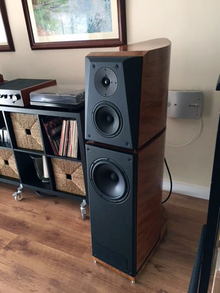

DiscoJones: I would be interested in hearing what better available midwoofer(s) you would be recommend.
Troels uses the ScanSpeak 18W/8531-G00 in the Jensen 1071, and the Audio Technology 15H52-06-13-SDKAM in the Prelude - either of which would eliminate the need to design a new MT crossover and are quite similar to the Andromeda. How good are these drivers compared to the 8545? Any other midwoofer recommendations for the critical midrange area that would work well with the 9900?

I think the ScanSpeak 18W/8531-G00 and the Audio Technology 15H52-06-13-SDKAM would both be upgrades from the 8545, as well as similar sized offerings from the Scan Illuminator line.. The Satori MW16, MW19 and CSS LDW7 would likewise be upgrades. I'm sure there are others, but these are the few that stand out at the moment. Again, the 8545 is no slouch, but I think the above mentioned drivers will take your performance up another notch.
I was under the impression that your 18W/8545 was one of the "sliced cone" drivers from scan speak. Now I see that it is not. I agree with DiscoJones: there are some better options available. To add to his list of excellent drivers, I would include the SB17CAC35 ceramic cone midwoofer (which is probably the least expensive driver under consideration here).
What people should be saying is:
1. It will be very difficult to improve upon what you already have.
2. You can't just pick a "particular looking loudspeaker" and insert drivers other than those designed for that loudspeaker and expect a decent result.
3. IF you don't want to become a loudspeaker designer, then either stick to what you have OR select a proven design and use those drivers.
4. IF you absolutely have to use your drivers and want the Andromeda aesthetic then you will need to be somewhat of a designer and have enough channels of amplification. This method entails using a digital crossover as mentioned here (in and "active" configuration):

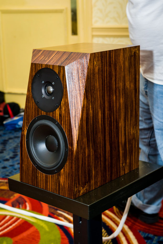

Very appreciative of the information coming forth, so thanks again to all for your time and interest. I do support the "realist perspective," but I also have to be pragmatic regarding my priorities, knowledge, and related constraints. No buzz-kill - just mandates more exploration, and of course more expense ;-)
It seems a newer mid-woofer is in order, and if I move forward with the Jensen 1071 design the specified 18W/8531-G00 would seem to be it.
While I appreciate an attractive speaker because it is also de facto living room furniture, I'm not married to the Andromeda design per se. But I am married to a woman who finds the Troels 1071 version (first attached pic) unacceptable unless it is in the garage - where I probably will end up living if it is built as he shows. Fortunately there are a number of other modified 1071 cabinet builds Troels has linked to which have a better WAF (attached pics).
I'm intrigued by the reference to the Viawave ribbon tweeter, and have had some experience with a ribbon's smoothness via the Duetta's. Troel's ATiRi build (picture attached) uses one, along with an AT 18H52 mid-woofer and passive radiator. Judging by his description and exuberance, this design seems very worth exploring. Unfortunately it looks like there are no crossover component values that accompany the design 😕 and the Viawave tweeter(s) look to have limited availability, so it seems here in the USA I might have to get the whole-shebang kit overseas from Jentzen.
As another alternative when considering a new mid-woofer, looking at the wooffer Troels uses for the ATiRi, I stumbled on to the Jeff Bagby (RIP) Spirit Wind (picture attached). This speaker uses the D2509/9900 Revelator I have, and it has a good WAF, therefore another viable possibility. But again no crossover details and a kit purchase is apparently required to get one.
And it seems no matter what "6-1" two-way I may choose, I will end up needing an independently powered pair of sub-woofers for the bottom octave - so potentially more audio-nervosa regarding the 'past it's prime' 1259 may set in... But that appears a topic for another forum.

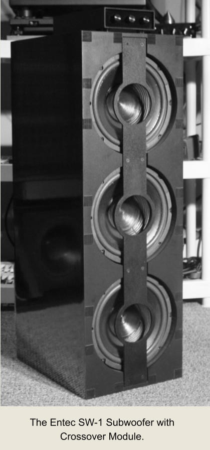

The older Velodyne servo subs used with my Virgo's are OK, but nothing I'm aware of beats my memory (long ago!) of the Entec SW-1's. It's three 10 inch servo drivers were incredibly fast, deep, and tightly controlled, and hideously expensive. Unfortunately these are impossible to find in working order, and apparently there's no DIY subs that I know of that try to emulate them. I've thought about checking out the Rythmic servo sub kits to attempt a clone...
Ultimately I'm hoping to find something that has close to the qualities of the SW-1's and can blend well with the M-WT speakers. But like I said, this probably needs to be on the Subwoofer forum after I nail down the rest of the system.

Veleodyne are going to be considerably better than just about any woofer add-on you can think of.. (..unless they aren't working properly.)

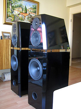

In that "vein" ("all-out"), maybe look at Jon Marsh's ..err, Evil Twin's Ardent D w/ a Dueland-type crossover. The midbass's are hideously expensive and stick-out like a sore without some black grill cloths, but that should actually push past what you currently have:
Ardent D (aka Kurosawa Jr) Winter Camp - Page 7
(..and if you like this, better photoshop in the grill cloths before presenting the picture for WAF consideration.)

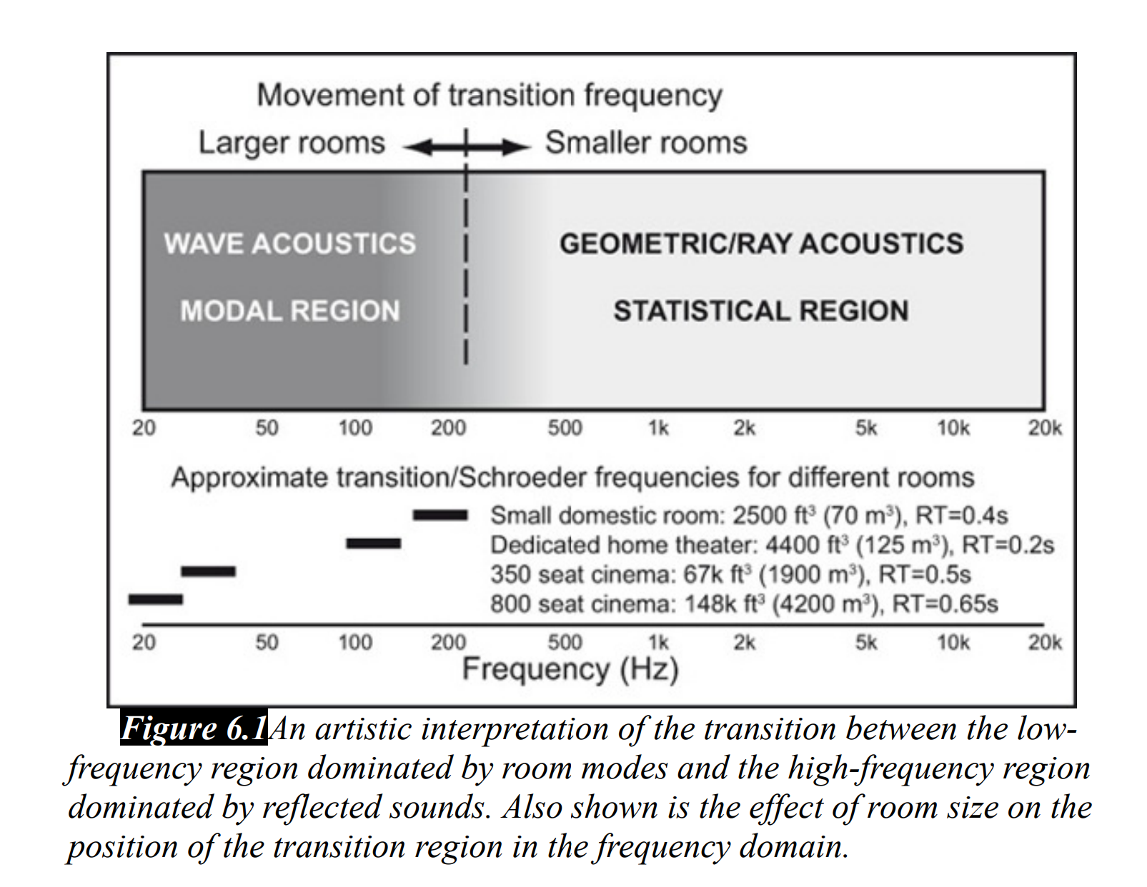

One of the most useful discussions in Toole's book is low frequency behavior in small rooms.
