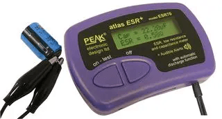

The easiest thing would be to measure the electrolytics, it's not certain they are a problem. We could assist with some basic simulating if OP wants a rough idea of what parts will affect what.
These are hardly vintage speakers, so the electrolytics are probably still within tolerance.
Do you have a Capacitance and ESR Meter with which to measure the electrolytics, Mike?
https://cpc.farnell.com/peak/esr70/esrcapacitance-meter/dp/IN06855

And certainly cheaper that first buying a £70 Capacitance and ESR Meter to test the old ones!
