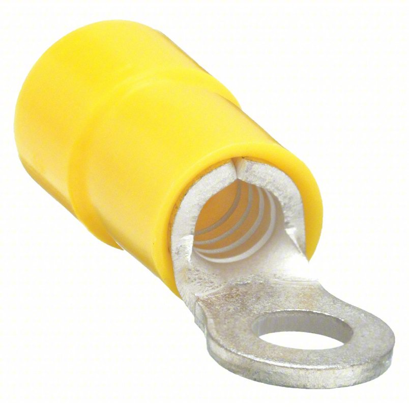

Binder terminals fit both bare wire when screwed down, or dual banana plugs when hookup is temporary. More elegant than bare wire is the spade lug, crimped on with a klein or ideal tool, then pull tested. HH Smith used to be the premium brand. https://www.newark.com/c/test-measurement/test-connectors-ic-test-clips/binding-posts Beryllium copper banana plugs are available for a price.

Please see above re the post system. The barrier strip type setup from car audio is what I keep coming back to. But a problem with that, it is not a tool free system, so another last resortBarrier strip or binding post, with a copper ring lug.
