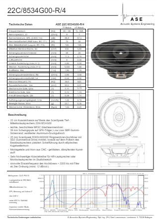

Hello.
It is a kit from Germany. It is based on a modified Scan Speak / Vifa speaker tweeter and woofer, which are matched together as a Koax speaker.

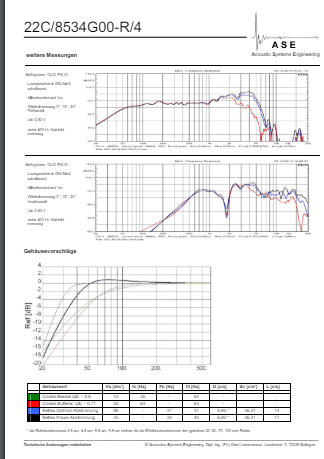

An intersting speaker. 2K XO from the huge impedance peak. Brace could be better executed.
Have you built this or are you just starting?
Changing trhe width of the box will affect where the woofer transitions from 2∏ to 4∏ steriradian radiation (baffle step).
What does the XO look like. Is there a RLC (in parallel) all in series with the woofer?
