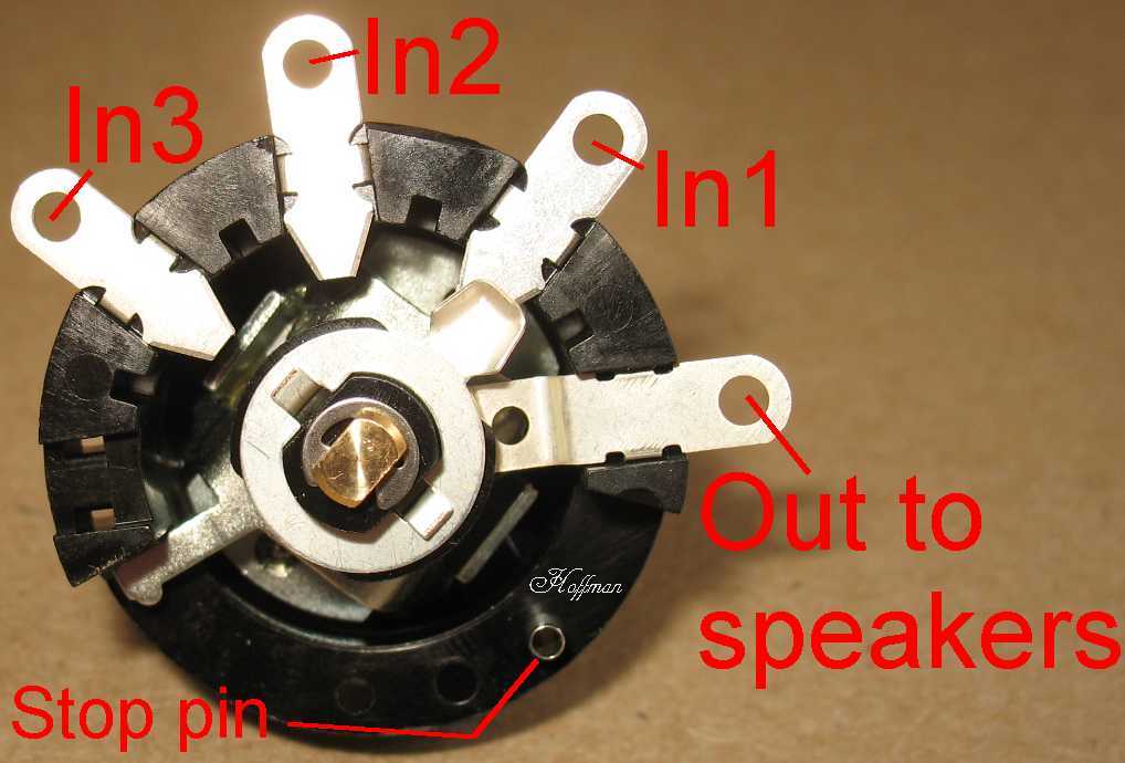

Using a DPDT to switch OPT secondaries
Hope I am not hijacking this thread in any way, but I have a query that is in this area, and is not worthy of a thread to itself.
I have recently created a more permanent case for a Tubelab SSE ...
SSE: The saga continues
Is it OK to use a DPDT switch to toggle between 4ohm and 8ohm taps on the OPTs? This is instead of having sockets for the loudspeaker for ground, 4ohm and 8ohm.
P.S. A stop pin is included to make the 3-way switch into a 2-way switch.
My thinking is that a toggle switch is too easily flipped by accident to the wrong position.
This is fine as long as the switch can handle the amplifier's full audio power, a couple Amps in the case of the SSE. The switch must NEVER be operated while music is playing since it will be open circuit for a brief instant. A "make before break" switch can be used in this case to eliminate the "never operated live" requirement, but these are harder to find.
