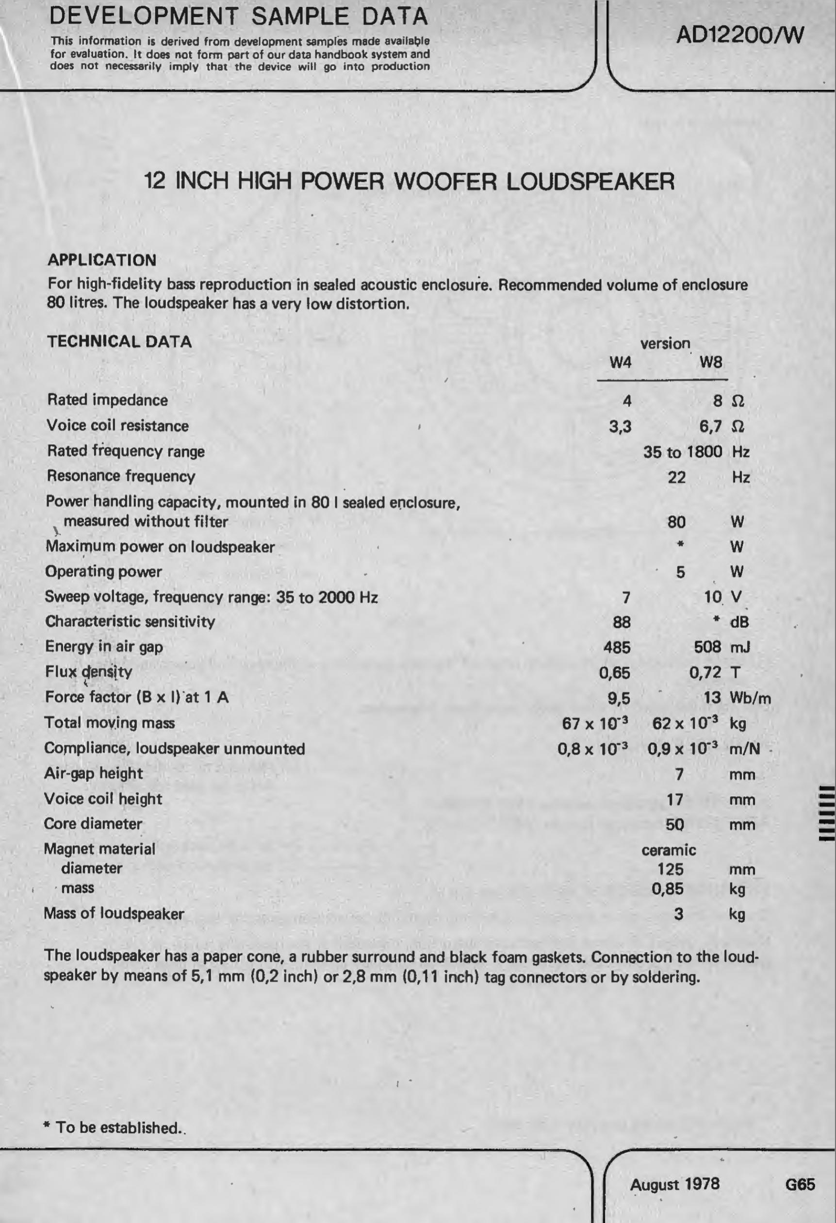

Hello everyone!
Thank you for all the replies
here's more details about the box
its 100x39x27cm (or about 39x15.35x10.6 inches).
it is sealed, but it has a passive radiator, so i'm not sure where the box stands, i only saw multiple times that box with PR are compared to ported boxes.
the speakers are all vintage Philips
AD0141T8 tweeter
AD5060SQ4 x 2 (series) midrange
AD12200W8 woofer
AD1200 passive radiator
I have attached screen shot of woofer tech sheet - what can you tell me about the speaker and the box combo (if anything)?
The speaker was not build by me, its a used speaker that i'm experimenting with.
the box has (i mean that's how it came originally) a sheet of fiberfill stretched from top to bottom, about 2'' thick, so i thought 'maybe i can make it better'.
I do measure FR, i've yet to measure impedance - so i guess i'll start looking into that. have to admit - i tried to avoid getting too much technical about it, but seems its unavoidable 🙂...
regarding the frequency in which stuffing is effective - what frequencies are we talking about, to get a perspective? like 250hz-500hz?
I kinda suspected that stuffing will not provide more SPL for the woofer, but the wording ''bigger box = more efficient'' mislead me.
also, regarding the peaks in upper region (i'm talking about ~1kh region, that where peaks started to appear (yes, they where not there before) but the mid drivers and twitter kinda have their own enclosure (although its just plastic cap), but should't they be isolated from the box?
Thank you
regards,
Vadim

You want the ideal box size. Not the largest box possible! 🙂
The size of the box affects the Q of the low end. Too small and the bass peaks very much. Too large and the bass rolls off too much.
The idea of filling a box with stuffing is that you get about 10%-15% more virtual volume. Meaning, you can use less wood to get the ideal size. This number varies a great deal based on how dense it is, blah blah blah.
Some makers eschew it altogether. They feel it softens bass impact.
