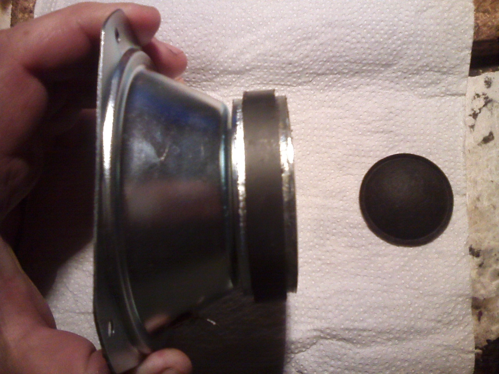

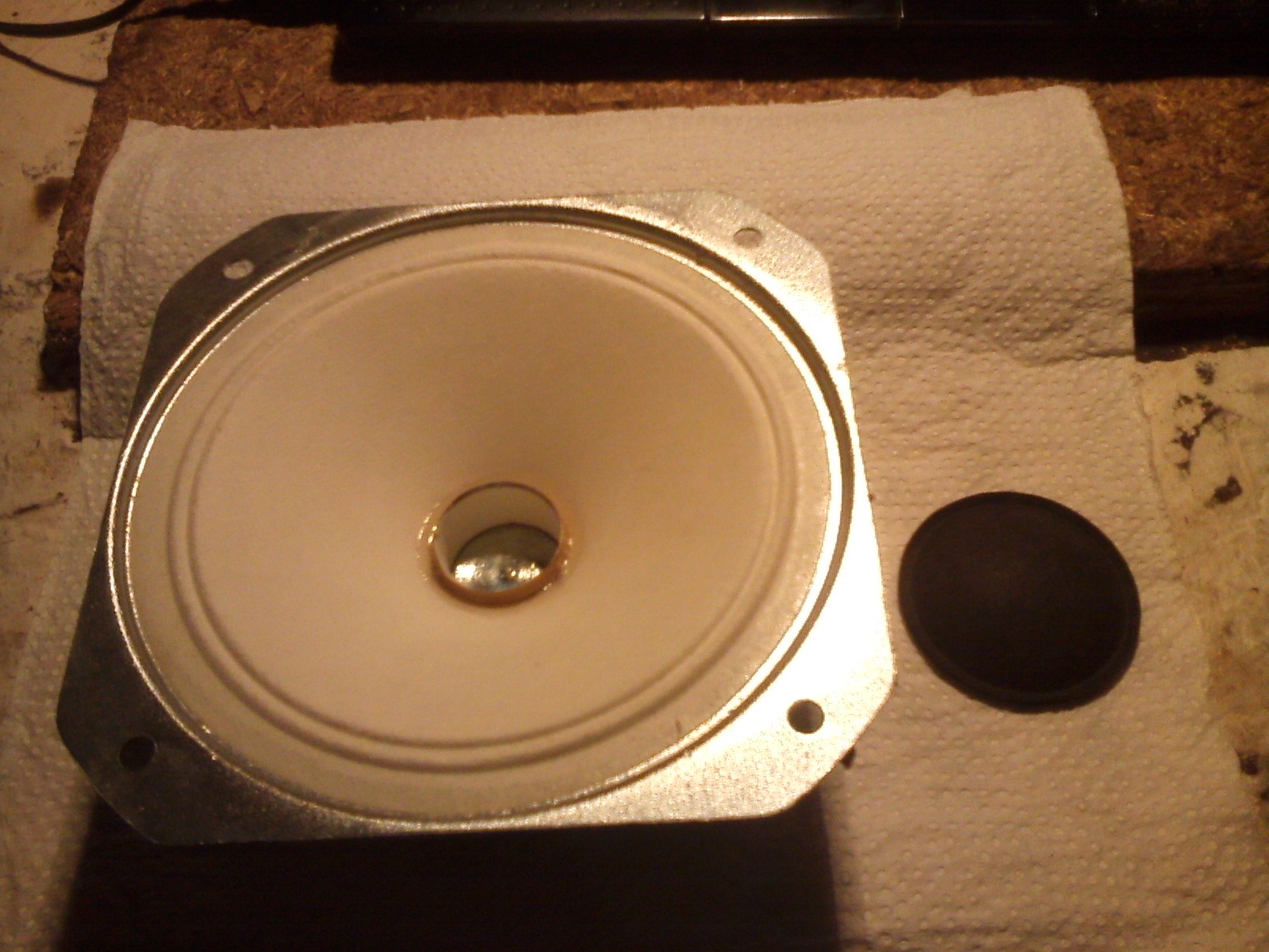

Just as a personal example: I make PA, Bass and Keyboard amplifiers, all cabinets have Tweeters (duh!)
I use own made 4" cone tweeters
sporting "high power" 19mm voice coils, they stand some real 15/20W RMS continuous, so each one can be safely used with up to 150/200W worth of woofers .... and yet all power amps have built in distortion detecting limiters and all tweeters use protective car lamps in series, just in case a happy slapper or a Synth guy or a microphone squeal provides enough HF program anyway to blow the coils.
They are usable because crossover removes most of a typical full range program and to boot "highs are low power" or if louder, come in short bursts (think cymbal crashes, acoustic guitar picking, etc.)
Now clipping produces harmonics so "highs appear which are not in the recording" and increase recording "density", compressing dynamic range so increasing previously "weak" highs contribution; both mechanisms easily surpass "expected" 5 or 10 % program delivered to Tweeters.
I guess in that era JBL also had a rash of blown tweeters repaired under warranty, definitely bad business, so they covered themselves.
