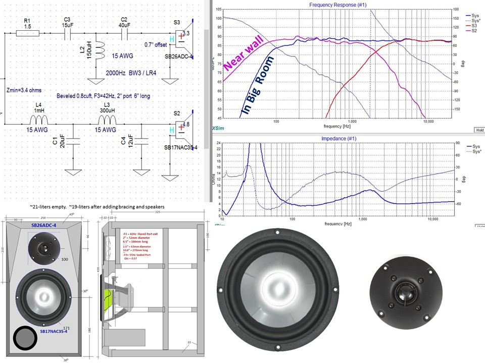

Looking to build bookshelf speaker set. I know that the usual is full range for the low to mid and tweeter for the highs. My question is would it be good audio with woofer for low end and full range for mid to high? Most full range I see don't handle low end that well. Looking to do without a separate sub.

1) A 6.5" midbass in a ported 0.8cuft cabinet will produce -F3 = 42Hz. A 1700Hz crossover to 1" - 1.1" dome tweeter is common. If you move the cabinet into the room, you need a crossover which attenuates the midrange and high frequencies -6db to compensate for 360-degree bass.
SB_Acoustics (SB17NAC35-4 + SB26ADC-4 =$125) in a modest size cabinet is popular
2) An 8" midbass like the SB_Acoustics SB23NACS45-4 in a ported 2cuft cabinet will produce -F3 = 33Hz. A 1200Hz crossover to a 1.1" - 1.2" dome tweeter, often in a waveguide, has gained interest. Wavecor has a 30 mm textile tweeter with waveguide TW030WA-11/12 which is designed for low frequency crossovers.
These are modest cost drivers($100 + $80), Based upon your amplifier power, you can select 4-ohm or 8-ohm drivers.

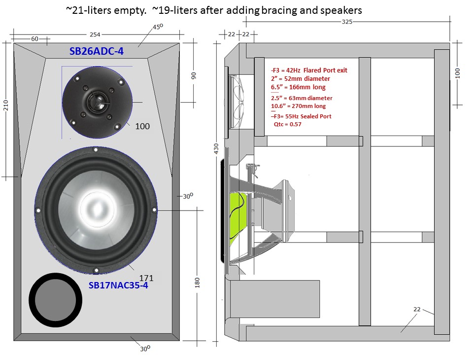

Example 2-way using 6.5" midbass and 1" tweeter in 0.8cuft. Does this match your goals?
SB_Acoustics (SB17NAC35-4 + SB26ADC-4 =$125) in a modest size cabinet.

For on-wall mounting, you can put the port near the bottom of the front baffle, or near the bottom of the outer side panel. A 2" or 2.5" diameter port can be used. You can also plug the port to compare sealed box transients, or to use this speaker with a woofer. An aluminum cone is more durable and moisture resistant than a paper cone.
-F3 = 42Hz Flared Port exit
2” = 52mm diameter
6.5” = 166mm long
2.5” = 63mm diameter
10.6” = 270mm long
–F3= 60Hz Sealed Port
Qtc = 0.57
Construction example:
