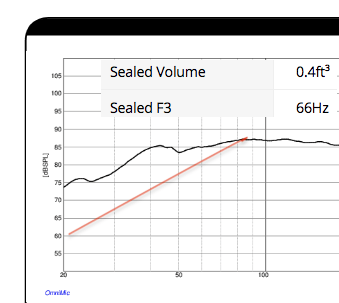

The range of volume per driver you could use is huge- .4 cubic feet to over two for the 8", .7 to over three cubic feet for the 10". The smaller the box, the higher the 12dB per octave roll off begins, and the more power needed for a given output.If I decided to go through with this what would each box size need to be for the listed drivers?
Decide what you want: deepest response, most efficient, smallest size..
As far as response below 80Hz, the three arrangements won't make a difference, but you will want the APT tweeter and mid driver near ear height at the listening position.
The Eminence Alpha 8A is a good choice for use with the APT.Also what would be a good midrange driver to use and what should the cabinets be made out of?

Which will be 1.315 cubic feet if I use 3/4" thick wood.
Is that fine for the Dayton 8" Classic Series woofer or too much?

The Dayton 8" Classic Series response would end up being ~halfway between it in a sealed .4cubic foot box and the black response curve:Which will be 1.315 cubic feet if I use 3/4" thick wood.
The GRS10" are much better than the other 4.5mm Xmax woofers you suggest.
I don't see any purpose to use the 8" woofers in between the mid/hi speaker and 10" subwoofers.
