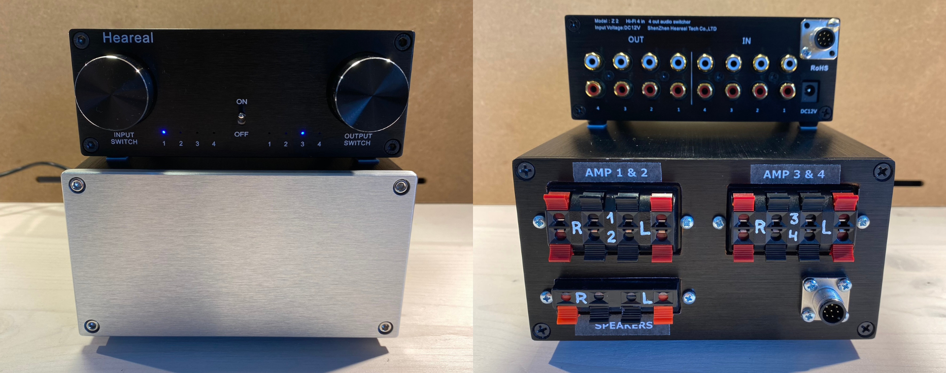

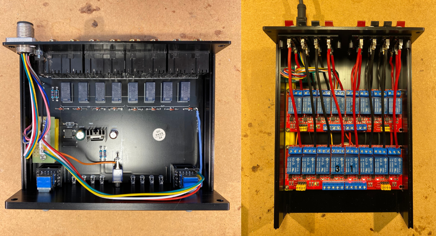

Hi silence012,
I like your idea about electronic switching. My switcher box is way simpler but perhaps something from it helps in your process.
I had quite similar need like yours of connecting several amps (four in my case) to one pair of speakers plus a source selector (also four) to feed any of the four amps. What I constructed is a two-module unit consisting of a commercial line level switcher (called Heareal Z2 on Aliexpress/Ebay) and power amp output switcher (a couple of photos below). The commercial unit is re-wired to control both the line level inputs and power amp outputs in the other box which is filled with standard power relay boards (also available from Ali/Ebay for various voltages and number of relays per board). Mine have 12V relays which are driven through optocouplers by 5V trigger received from Heareal internal 5V regulator and selected by rotary "Output switch". The small signal relays inside Heareal are 5V types.
The whole thing is powered from a 12V DC wall supply into the Heareal which is connected to the other box through a round 8 wire connector (actually 6 would be enough, I just used what was available) supplying the 12 volts for the power relays and 5V trigger levels to the optos.
There seem to be quite a number power relays involved for just four amps and indeed there are four relays for each amp since they are all SPDT (single pole). The four relay contacts per amp are needed to connect both the hot and return wires to speakers since not all amps have speaker returns connected to common ground (class D, BTL). I see that you intend to use DPDT types which would be more space/cost efficient of course (perhaps you can even find 4PST?) but I just did not succeed to find any ready made relay boards with DPDT power relays and sticked with the quick solution. More space is necessary for SPDT but amount of wiring job would be the same for DPDT.
Please ask if anything from my unsophisticated configuration is relevant to your project. Anyways, have all the success with your electronic switching solution and thanks for sharing.

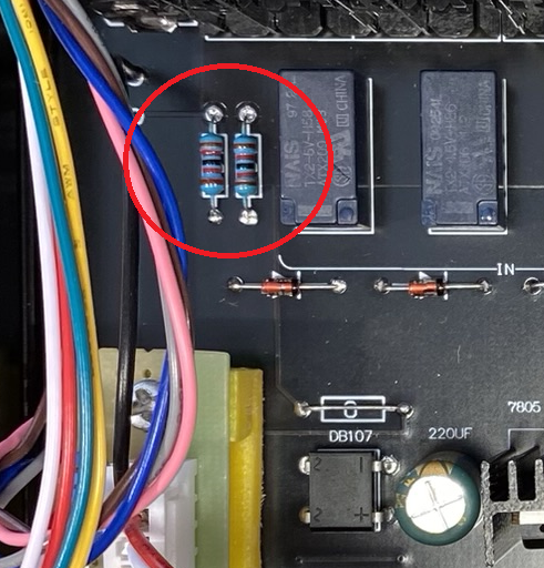

One more thing. The Z2 loads the connected source by internal 12 kΩ resistors (see pic below) which then appear in parallel with the input impedance of your connected amplifier. From loading point of view, this should not be a problem for any contemporary line level source unless the input impedance of the connected amplifier is already low (like in some HP amp designs). The resistors can be removed of course but their purpose apparently is to avoid the risk of loud hum by terminating unused inputs when you switch over one of them.
