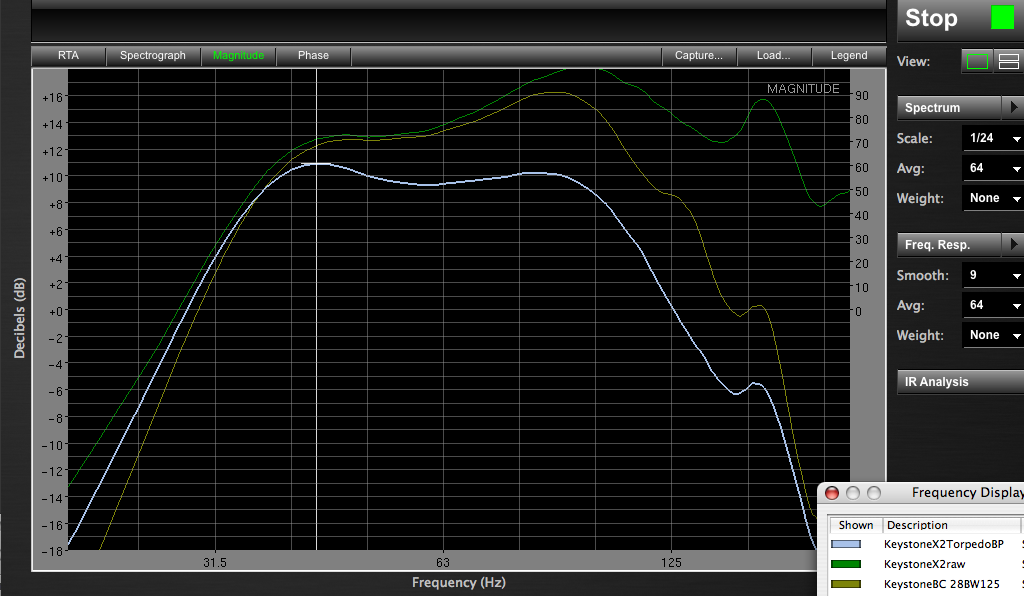

The graph below shows the raw response of my Keystone sub in green, a 28/125 24 dB per octave Butterworth filter in the brownish color, and the Torpedo filter in light blue.
Although it is not exactly what I would cook up for this sub, the Torpedo SP1-4000DS filter is pretty darn close.
