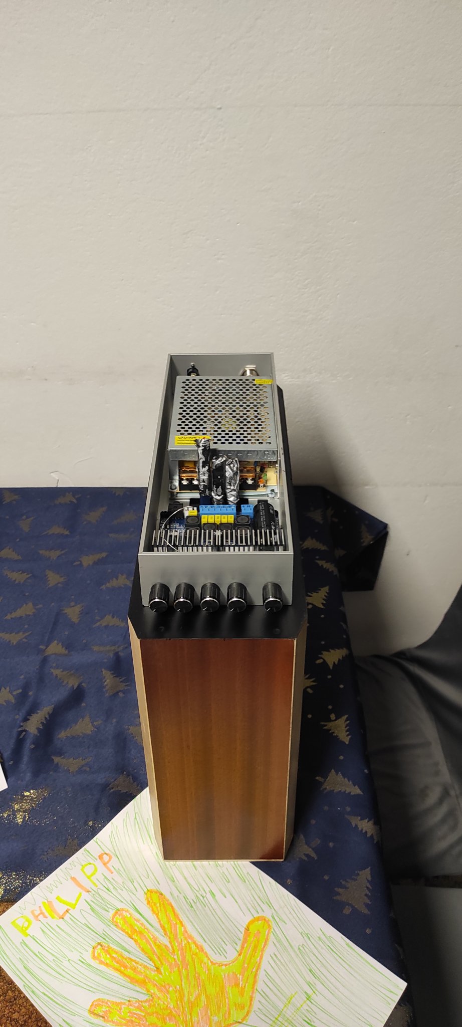

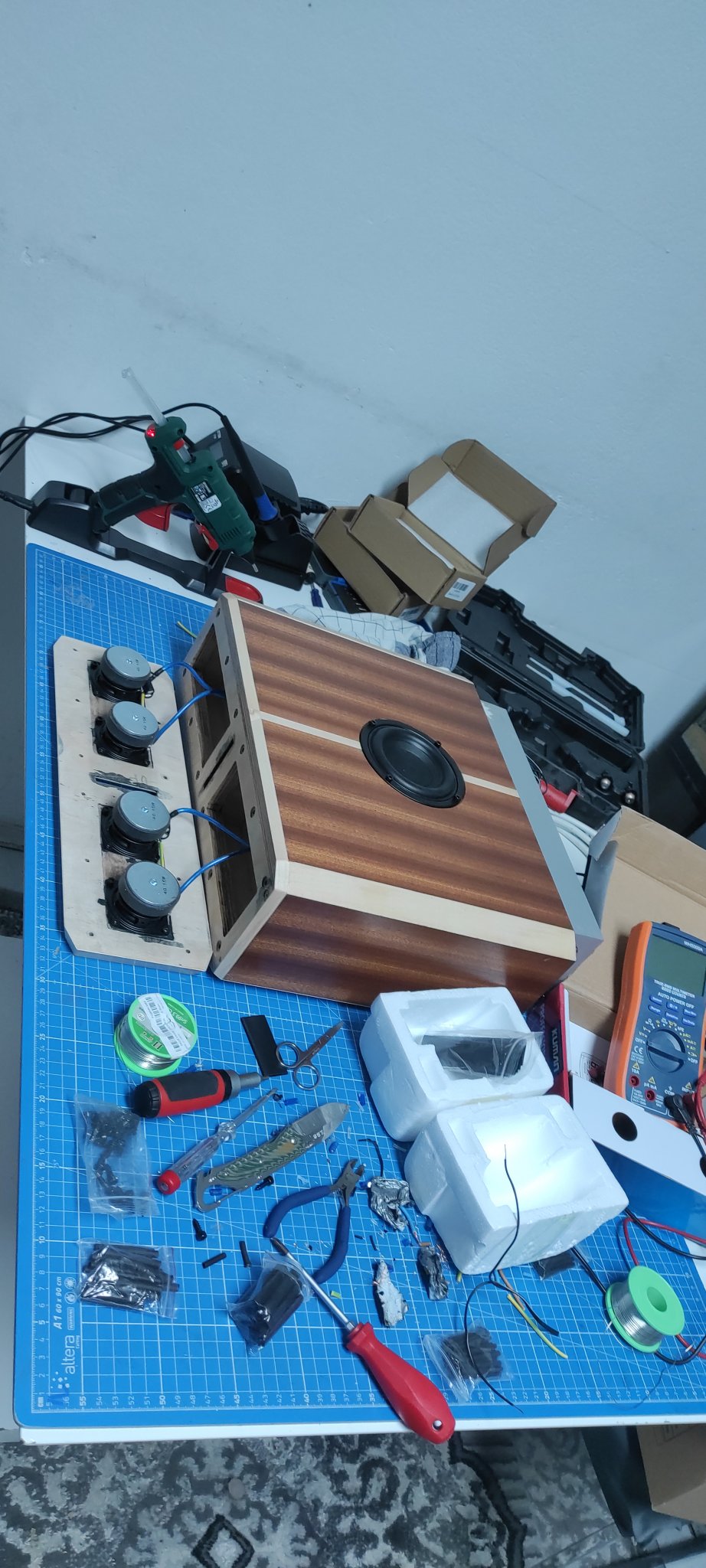

I put this one together to keep me company at work
