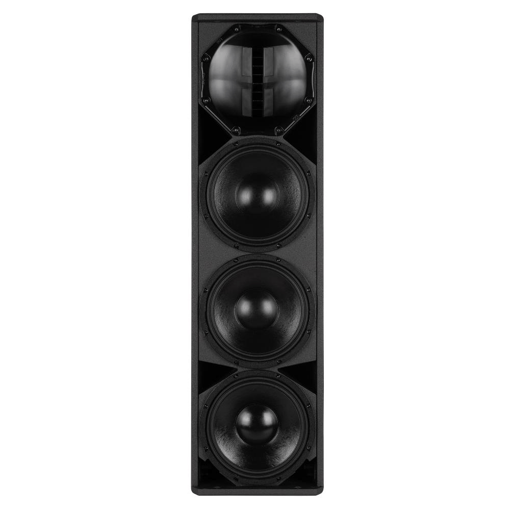

I am building a column speaker, with 3 mid-bass units and 1 compression driver. kinda like the RCF nx24a.
3 units is difficult I see now. even with 3 units of the same impedance. 2 is easy, 4 is easy, but three.....
So adding the extra unit does not give me any gain in volume, only gain is box size and weight 🙁 ?

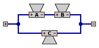

Ehmmm, but the two 4 ohm speakers (A and B) will get less power than the 8 ohm speaker (C). So probably dont output their specified volume in that configuration right? Would that be audible?
In this config the amp will see about 4 ohms at the output:
the 101 dB you mention would be a fine output
Let's state that the amp is applying 2.83V
The 8 ohm driver gives 95dB
The 4 ohm drivers each get half a Watt, putting the total for the two at 98dB
The total would be almost 103dB

Each has half a Watt, 95-3=92. There are two, so power wise 92+3=95, and working together wise 95+3=98"The 4 ohm drivers each get half a Watt, putting the total for the two at 98dB"

@yeroen There is a simple way to ball park this, however a simulator will give a more accurate answer because the driver has inductance as well. The amplifier output is voltage, but the driver sensitivity is specified as power 95dB/W (2.8V*2.8V/8R=1W). Lets assume 4R speaker and 8R speaker are the same sensitivity and we'll look at the "change" in sensitivity w.r.t a single driver.
- 2 drivers in series have 2x the resistance (-3dB electrical gain) however you also have 2x cone area Sd (+3dB acoustic gain). Net is -3dB + 3dB =0db change to sensitivity. This is from 10*log(2)=+3dB, and 10*log(0.5)=-3dB
- 2 drivers in parallel have 1/2 the resistance (+3dB electrical, more current) however you also have 2x cone area (+3dB acoustic). Net gain is +3dB +3db = 6dB change in sensitivity.
Your example, the 2 series drivers have net 0dB sensitivity change. Then a 3rd driver (8R) is added in parallel. So electrically +3dB, but you only have 50% more Sd so 10*log(1.5)=+1.7dB. The net change is = +3dB + 1.7dB = +4.7dB relative to the sensitivity of a single driver, with net resistance 4R load the amplifier. This is approximate because it excludes effect from speaker placement and all T/S parameters.
[Edit] - I just saw @AllenB is doing a sim, which will be better

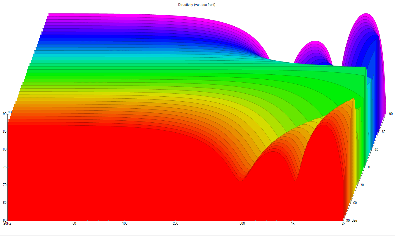

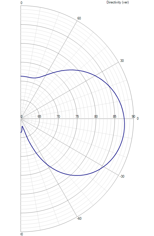

drivers will be placed close together, like this:
my plan is to align the top horn a bit tilted down, because these speakers will be stacked on top op the subs, or on a pole, so the horn and upper woofer is always at least above crowd heads.
So a vertical directivity with a 'lobe' down would fit as in your sim (thanks for that!)
But if I see you sim, I see dips arising around 400Hz around 60 degr. off axis
Do I read it correctly that vertical dispersion is falling from 400Hz and further off axis?
I was planning on crossing the compression driver at around 1.5 khz
And what about horizontal dispersion? Is there a beaming effect in this placement/coluns design?

Yes, and side lobes appear in the usual way. With real drivers that are not point sources, it may be less distinct.Do I read it correctly that vertical dispersion is falling from 400Hz and further off axis?
just the usual for 8" drivers, narrowing towards 2kHz.And what about horizontal dispersion?
Sometimes pointing it up is better for wavefront integration. There is some uncertainty casually discussing it this way and many keep it straight in this situation.my plan is to align the top horn a bit tilted down, because these speakers will be stacked on top
