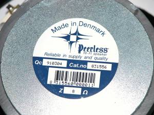

I just bought six 8" Peerless drivers from a guy who took them out of a Rodgers organ, circa 1990. They all had a case of foam rot so I got them on the cheaps. Catalog number 831556 and Qc 910304. Google doesn't turn up much. Anybody have specs on these? Any suggestions what I can do with them?

Google turns up a LOT for the Peerless 831556. Like it is replaced by a Peerless 832737 these days in stuff like the Gale GS401.

Hey guys. Thanks for the responses. I recently built a pair of single driver full-range speakers (Buschhorn MKII). I have a lot of leftover birch plywood and I am thinking of building an enclosure with the Peerless drivers that will help fill the low end. I don't want anything that will rattle the cupboards, just something to add a little "umph" at the bottom. I don't have equipment to take measurements (though that will probably change soon) and am just curious about the basics now, such as Fs, Vas, Qts, etc., and how the heck I can get some use out of 'em.

Thiele-small parameters are rather obvious once you get the hang of Vas and Qts. Fs tells you how deep they might go ultimately and is related to cone mass and suspension softness.

My guess is those drivers have a Vas of about 2 cubic feet or 60L. They look like Acoustic Suspension drivers at heart, based on the foamed surrounds and presumably low Qts around 0.3 or 0.4. Probably best crossed over to a midrange around 800Hz and 90dB sensitivity, and suitable for 20-30L closed box.
You might end up with something that looks like an Acoustic Research AR-3A (google it...), or this Visaton design in a smaller closed box, but hey, you could go for the bigger reflex too:

I wouldn't parallel these bass drivers. That would take impedance too low IMO.

Wiith 6 drivers presumably 8 ohm your best bet is 3 series pairs in parallel.
Best estimates are 20L sealed per driver and 30L vented to 40Hz.
If you clamshell each pair (isobaric) box volumes drop dramatically,
10L per isobaric pair sealed and 15L per isobaric pair vented.
Max SPL and efficiency drops, but so does box size by a quarter.
