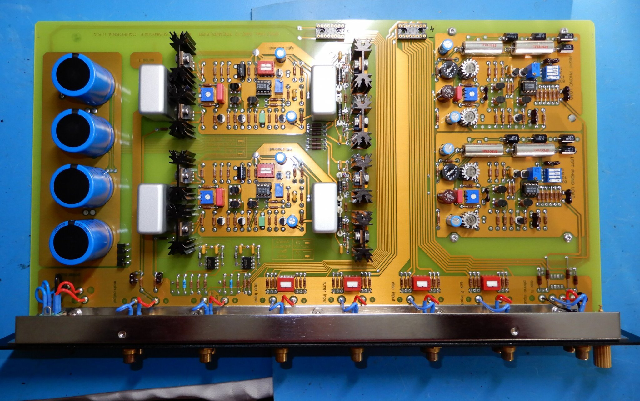

Here's mine just prior to replacing the electrolytic and ROE caps.

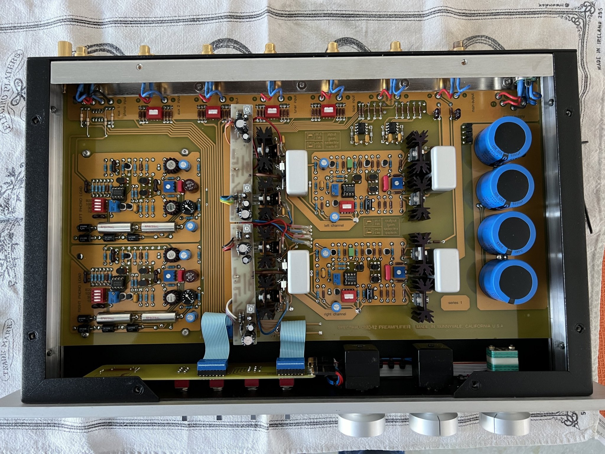

I don't remember where I got this other photo of a DMC-12, but it has some additional circuitry in between the phono board and the main board. I wonder what that is? I wonder if there was a series 2? I still haven't gotten my DMC12 back out of the box. I also wonder if the coupling caps in the phono circuit (large silver) are paper-in-oil caps. They look like PIO, but maybe they are teflon? I might know more once I get mine back out. I did notice some date codes on components in these pics that are late 1995. Willy O
Willy O,
Don't know what those circuit boards are for, but the look like they are perhaps bias circuits for the MOSFETs. Doesn't look at all like stock factory work, and like no other photos I've every seen online. Maybe ask Spectral. Edit... I just found a forum from where that photo came - the new owner had a tech remove it after determining that it was a non-factory modification to the power supply.
Yes, those silver caps look like PIO to me. I left mine in place. If they are anything like the vintage PIOs I have in my parts boxes and in my guitar amps, they are superb, and right on spec.
I've seen photos of DMC-12 units with a black can over the phono sections, but mine doesn't have it and it looks like it never had one.

I really need to get my DMC-12 out and try tracing signals through that phono section. I do have a signal generator and an oscilloscope. I'll have to figure out how small of a signal to put into the phono stage. Thanks for figuring out this additional circuitry mystery.

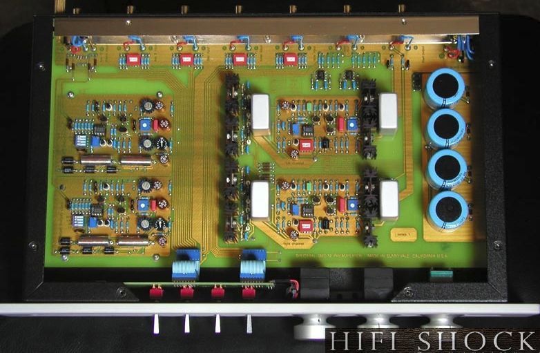

Hello everybody,
is here someone who knows what kind of capacitor are the 4 big silver cuboids on the dmc12 pcb in the picture above?
I see this type of capacitor in many older Spectral components.
I only know that there are 2 capacitors inside, are they coupled for thermal reasons?
Who ist the manufacturer?
Thank's
