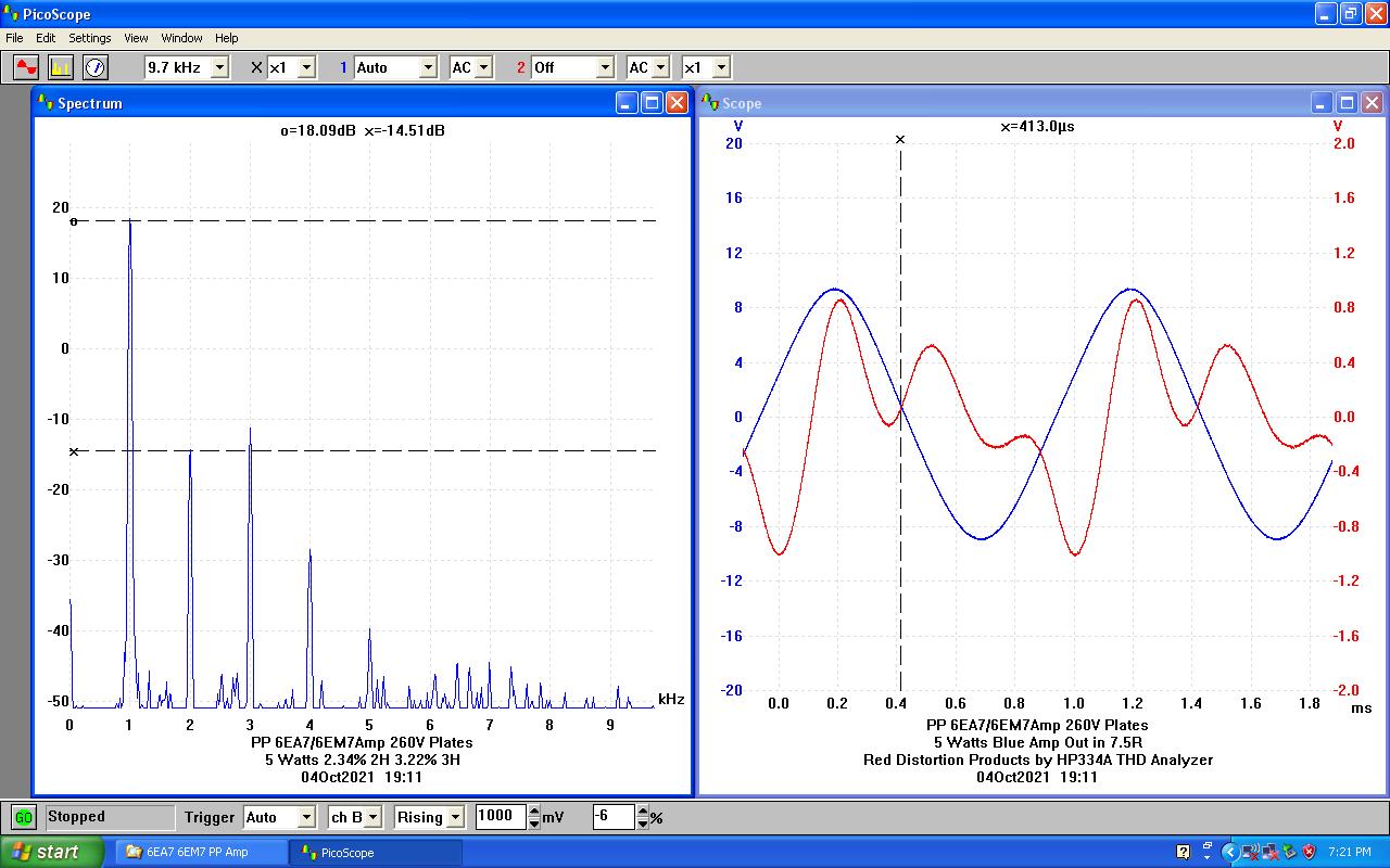

A PicoScope 12 bit FFT displays the harmonics directly. An HP334A THD Analyzer notches out the fundamental & a trace of the harmonics can be seen in red.

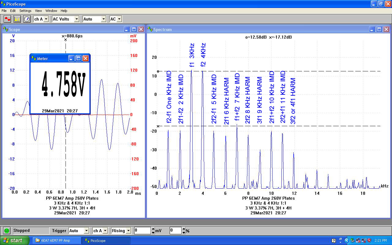

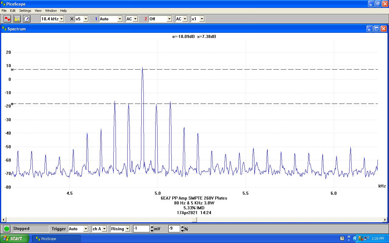

The PicoScope measures the Intermod Products (SMPTE) of 80Hz & 5KHz in Ratio 4:1 as Sidebands on the 5KHz signal.
The IMD is measured by the 3:4 frequency method devised by Graeme Cohen. This method separates the Harmonics from the Intermod Products. Cohen's paper describing the 3:4 method is attached for the curious.
So you mean, you connect the probe from the PicoScope directly to the output of the amplifier?
Here, you are connecting the PicoScope to the output of the HP334A, which produces the red trace?
