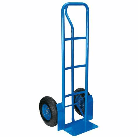

Moving a heavy speaker cabinet without casters is not really a problem... The technology to do this has been around for hundreds of years...
I'm not having a sack truck trolley in my Man Cave - its wheels could rattle! 😀
