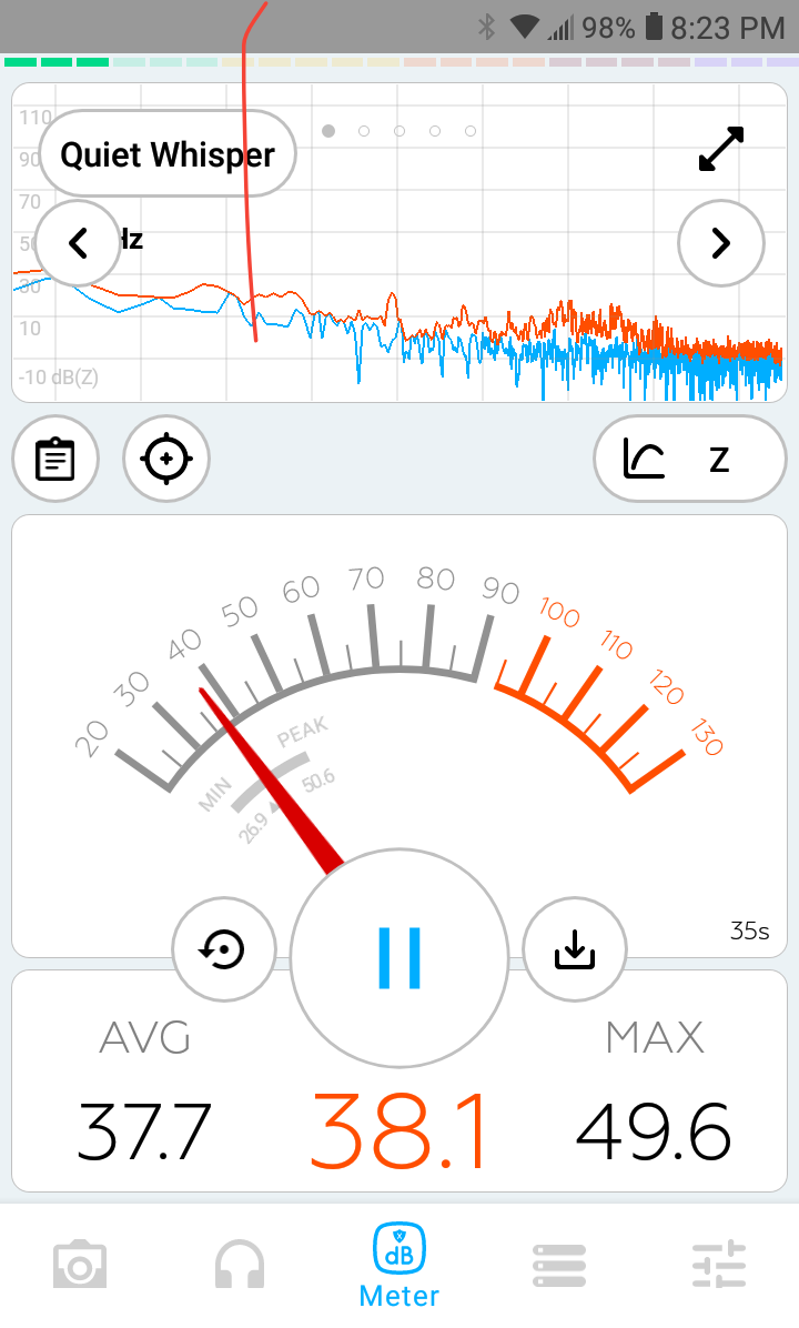

?? Most say, though not loud (most users are ignorant). Since most free meters users are trying to show "noise", A is a default, and C (better Z) may be a paid upgrade.
Decibel X PRO - Sound Meter dBA, Noise Detector, SkyPaw Co., Ltd
Decibel X PRO - Sound Meter dBA, Noise Detector - Apps on Google Play
--works OK for me. Really better than a new $49 meter (it rattles and the smoothing is janky); not as good as my 1979 Realistic Needle-meter.

Decibel Meter, Dmytro Hrebeniuk
Decibel Meter - Apps on Google Play
picture: https://play-lh.googleusercontent.c...qdOW2YoiQIa50dgN2xlV-480xkqIouVZUk=w1440-h620
Has A C and Z, is a fine tool. I now like Decibel X (Pro) a bit better, but either is fine.

Cleaning the selector knob on the Radio Shack Sound Meter worked to fix its erratic behavior and I also looked at some of these apps and found the Decibel Meter by Dmytro Hrebeniuk for $1.99 one time payment to be the cheapest for dBC, could not find a free app for C. A calibrated external meter is necessary to calibrate the app, though, as it was way off in its default configuration.
