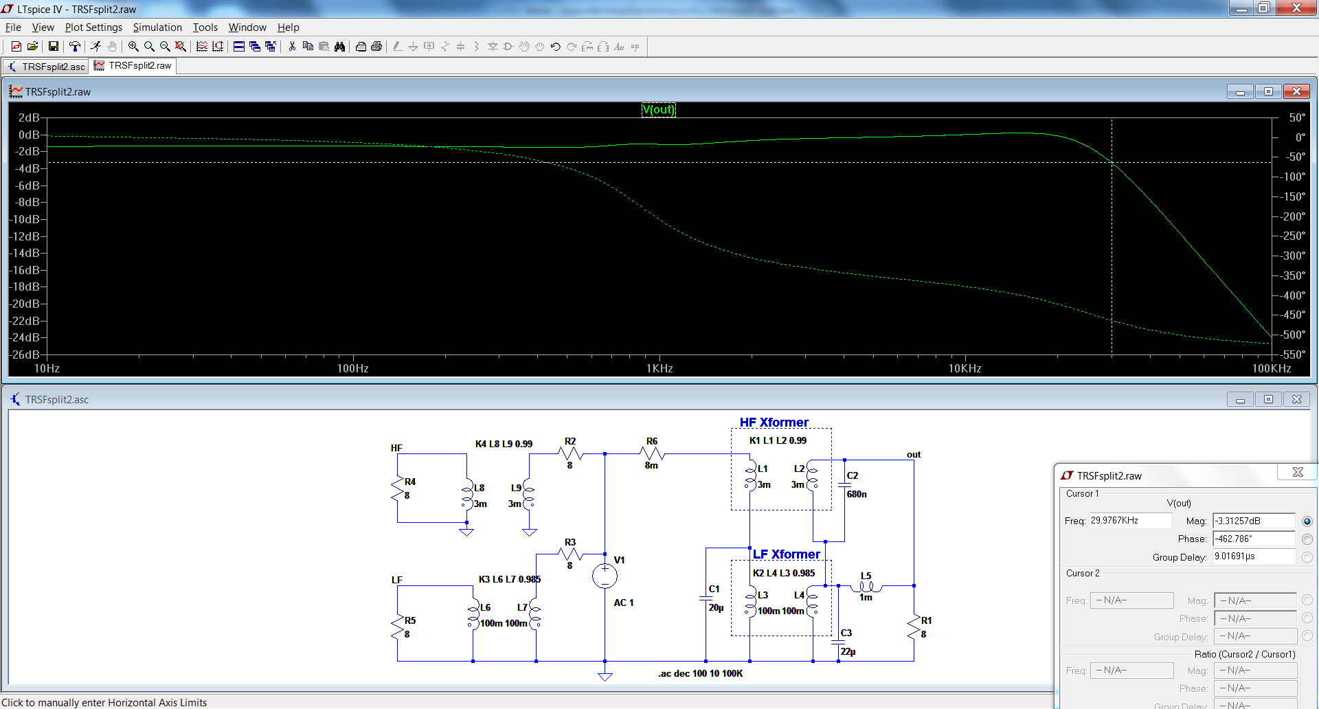

Splitting the audio band into two transformers
Hi there
Someone probably has already had this idea: it looks too obvious.
Anyway, here is my proposition:
Tube OPT's are notoriously difficult to make, because they need to fulfill many contradictory requirements at the same time.
Life would be much easier if the task could be divided between two specialized transformers: a low frequency one, having a good primary inductance and a good V*s capacity, and a high frequency one having a low leakage inductance and a low capacitance (based on ferrite cores for example).
This looks simple and obvious, but is in reality fiendishly difficult: all the magnetizing, leakage and crossover-filter inductances have a multitude of resonances possible with the crossover capacitances, making the composite frequency response a nightmare of peaks and troughs.
By sufficiently damping all the reactive elements, flattening would be possible, but at the expense of 10dB output power or so.
Here is a topology that doesn't require additional damping, and yet offers a reasonably flat FR.
In this example, the impedances are normalized to the secondary for simplicity.
The two transformers have pretty lax parameters, and are thus easy to manufacture, yet the global FR remains flat to about 30KHz.
Of course, this is only one of an infinity of tradeoffs possible, and I am sure this can be improved on many counts, but it gives a first taste of the technique.
Since transformers primaries are in series, the method would be useable for simple PP or SE outputs indifferently.
For more complicated arrangements, like UL some more thinking would be required, but an adaptation is probably possible.

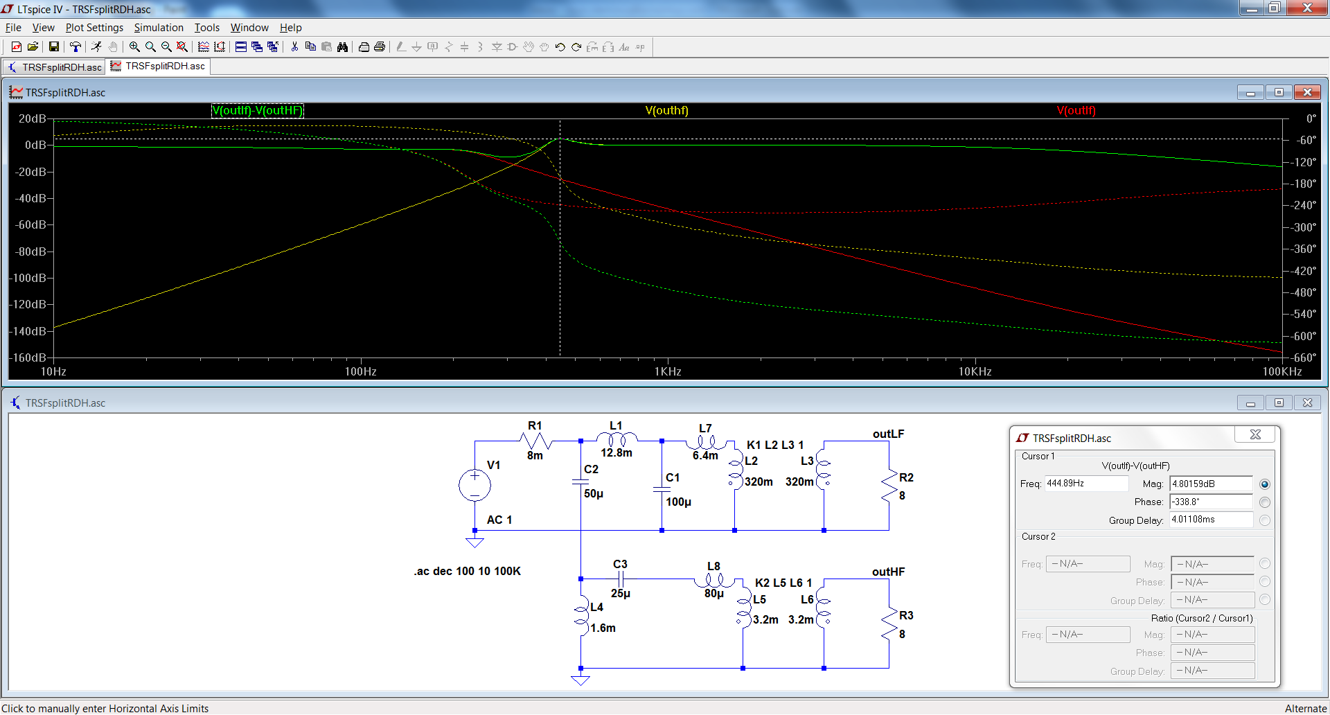

The second pic shows the FR of the individual transformers with the nominal load as source impedance.
The composite is shown with zero source impedance, because it is the most challenging (no input damping).
Opinions, ideas?

If I understand it correctly, you are combining the output of the two transformers? Why not design the cross-over and transformers, so that the LF transformer only supplies the woofer, while the HF transformer only supplies the tweeter?
That would be a possibility, but probably not general enough to satisfy everyone, and you would still have to put a crossover in front of the transformers, which in theory should be easier than the Xover+combiner, because less resonances are possible, but I would be cautious, and you would need to examine carefully the phases of the outputs, to make sure the recombination at the acoustic level doesn't result in unwanted artifacts.
It is a certainly an alley worth exploring too.

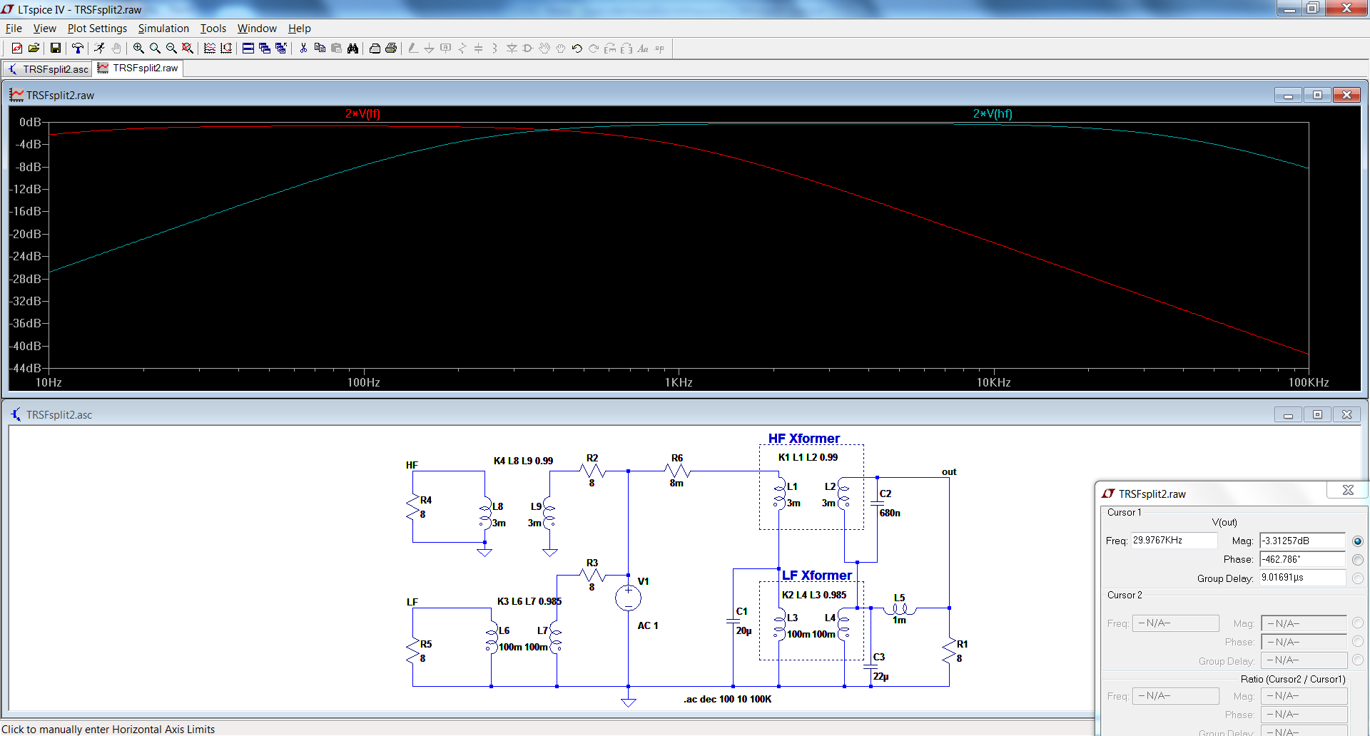

For such a scheme, an important aspect is the non-degradation of the impedance for all of the audio spectrum: with many reactive elements involved, the risk of unwanted artifacts is very real.
For this topology, the impedance curve remains mostly flat:

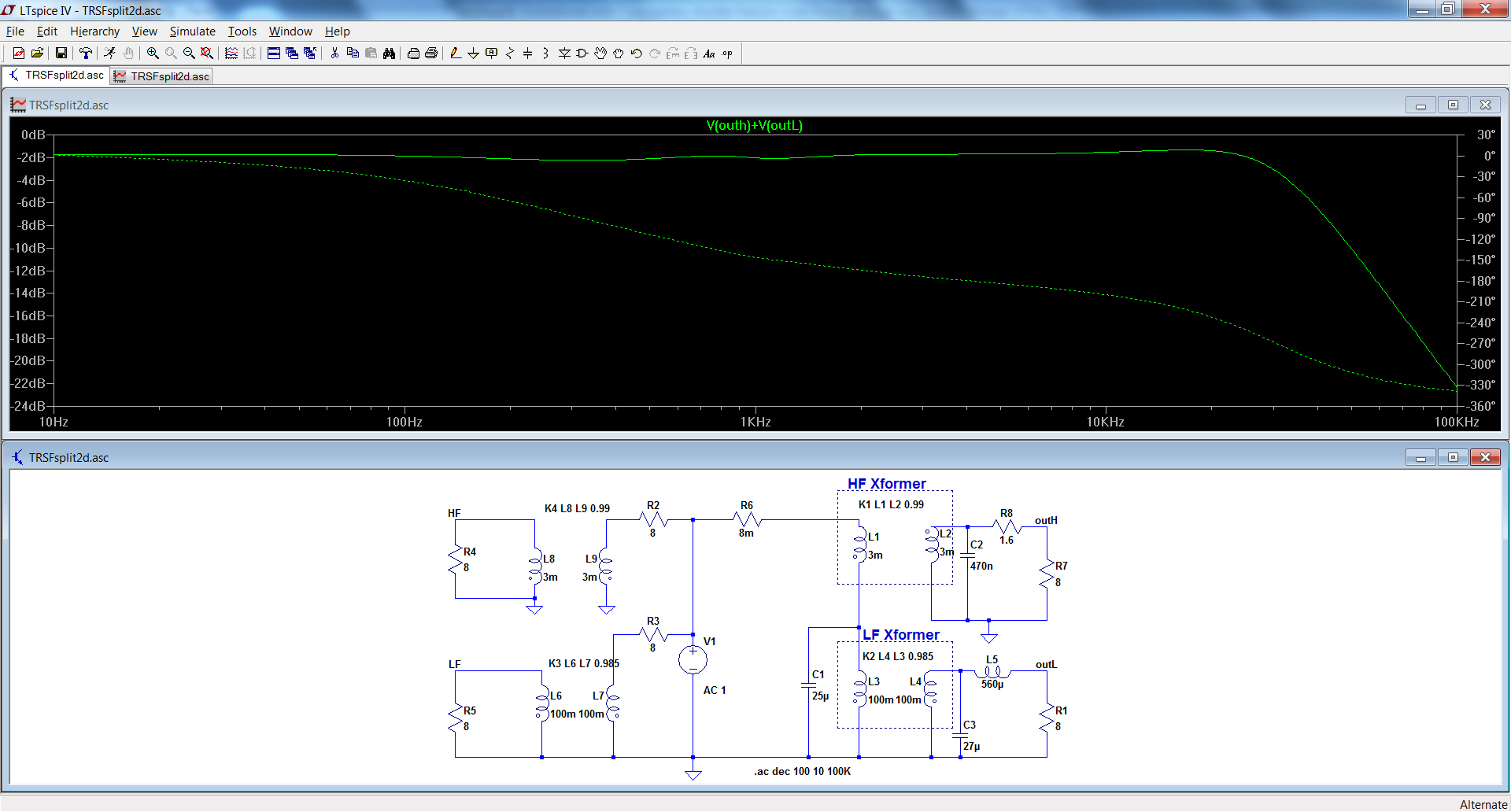

Making this adaptation was quite easy, and resulted in an even flatter composite output than with an electrical combiner.
What is required is the phase inversion of one of the transformers, and minor value tweaks:

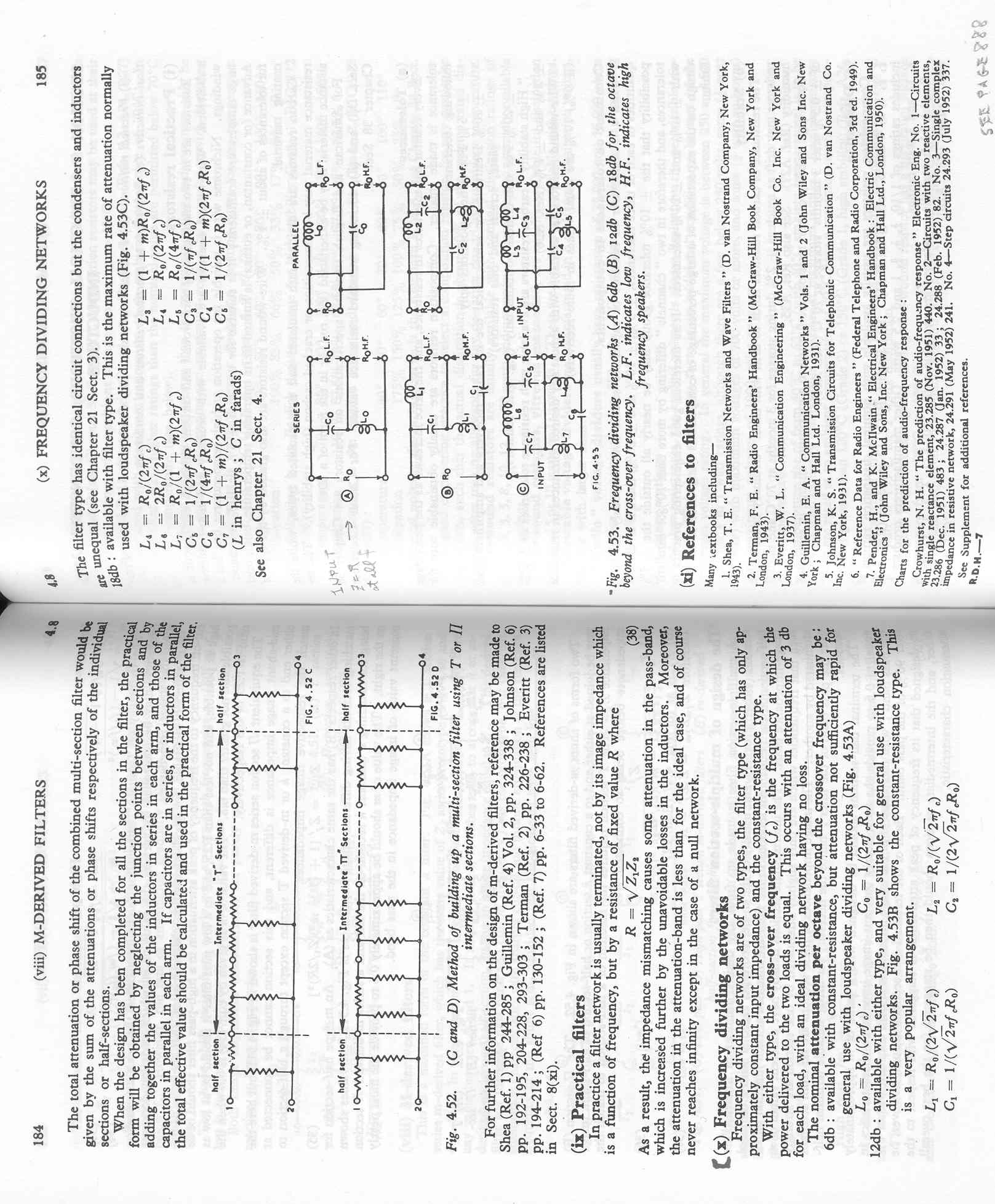

RDH 4th ed. has it all worked out:

Taken from here.

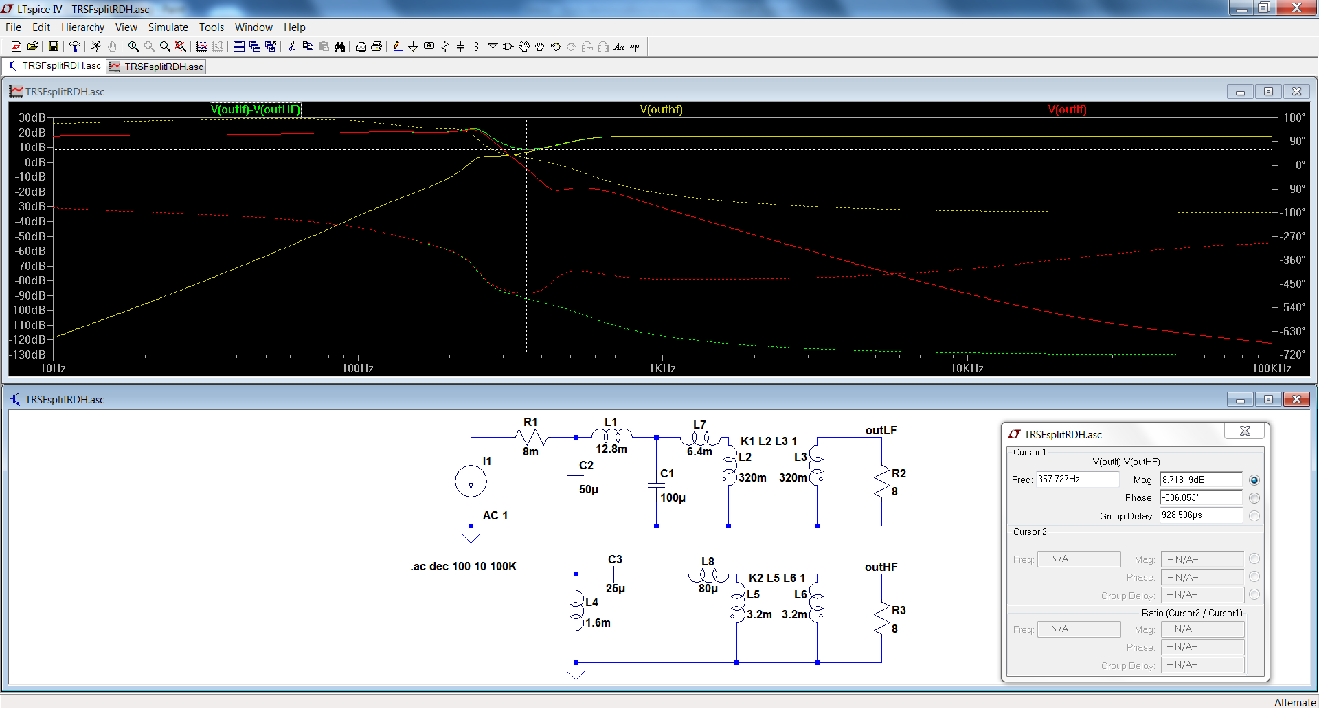

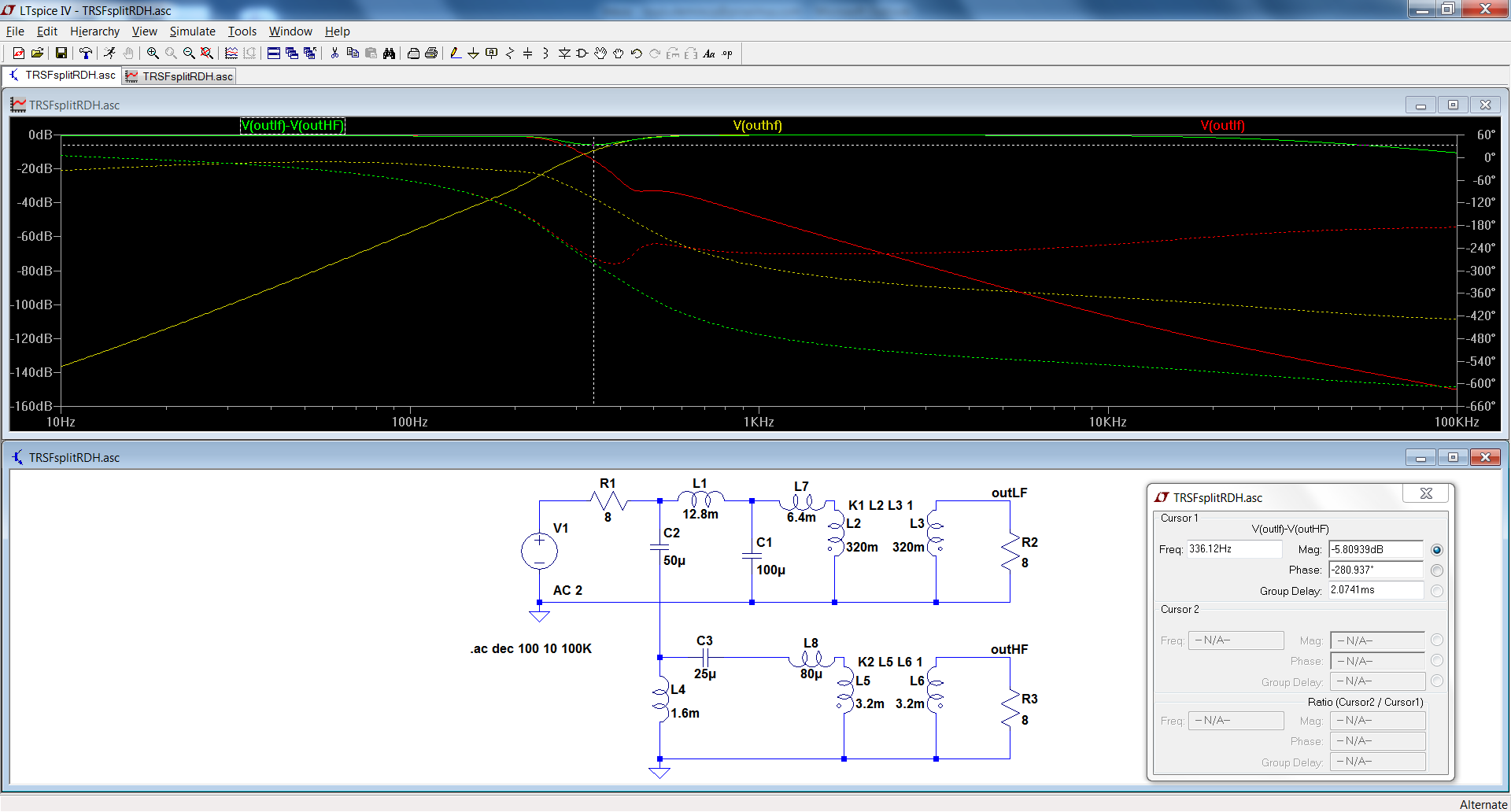

I have simulated the RDH version, after normalizing it to 8 ohm; it does work, but the results are a bit disappointing: whatever the output phases, there is a large (or larger) dip at around the Xover frequency.
Maybe the acoustics are supposed to for correct this?
With a zero source impedance, things get worse, logically: there is now also a bump.
In principle, a tube output stage is not supposed to have ~0 output impedance, but since it is impossible to apply global feedback because of the two separate outputs, maybe there is a feedback at the primary level which would reduce the apparent impedance?
More probably, it is supposed to operate completely open-loop.
With a high impedance drive, things look even worse, thus it is probably intended for triodes, without any feedback.
In the end, the version I proposed comes out better: it is flatter, uses less inductive components, and allows an electrical composite output too.
