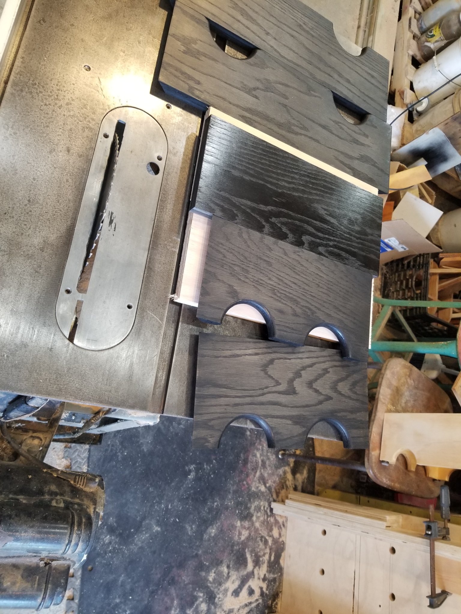

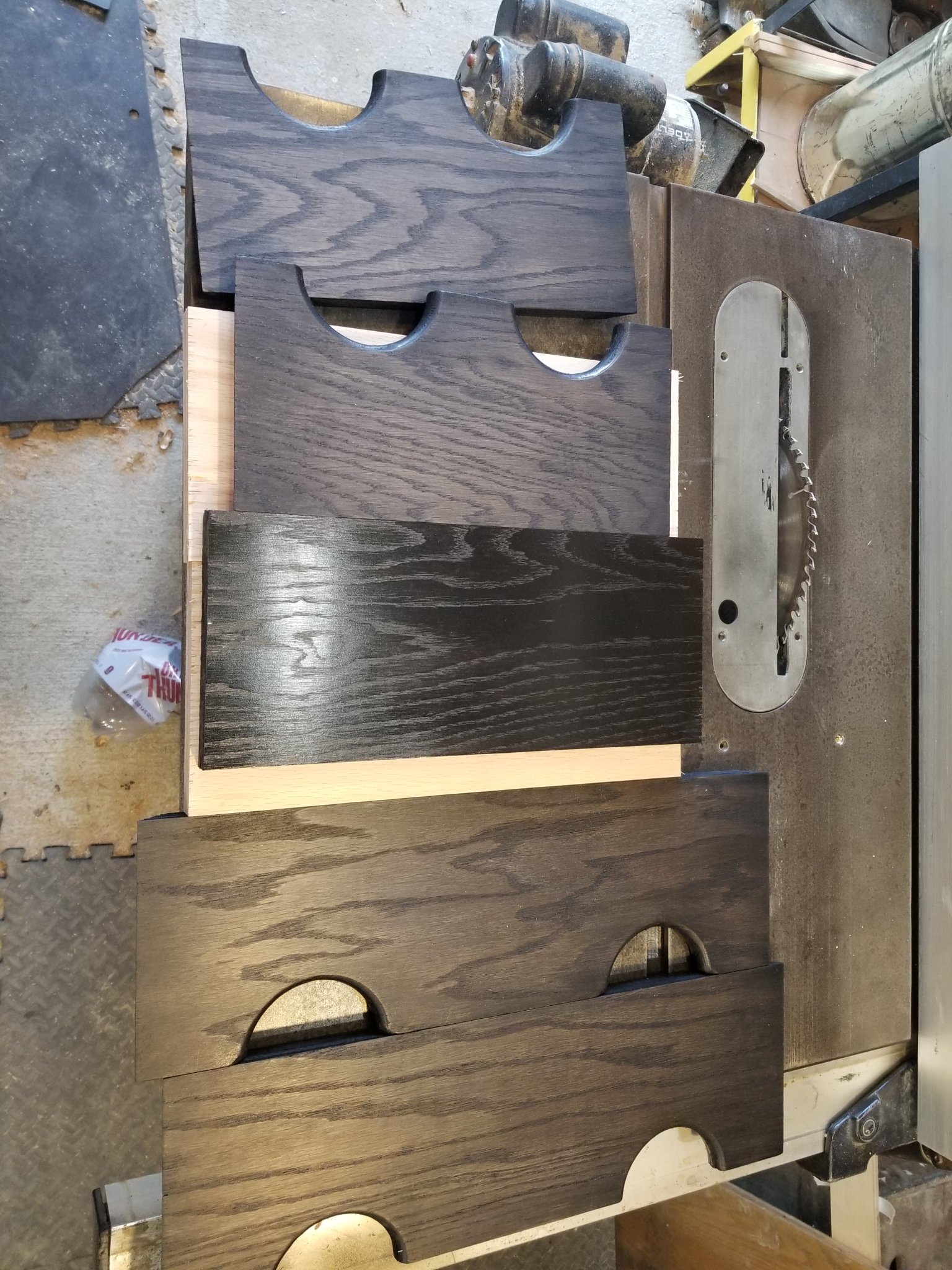

Smart people in case your not interested in this novel of a post can you tell me if you think the solvents in wipe on poly will re-melt cheap enamel spray paint?
Let me be more specific as the topic of the thread has morphed from
"Why not just skip the hassle and use spray enamel?
I'm looking for critique . Why might this be a bad idea?"
Over to staining techniques. This is great as I love the knowledge and the conversation but while not being Off Topic it is Topic adjacent.
First off we are dealing with Red Oak plywood so it is open poor species group. (red oak is not a tree it is a group of trees.)
If you over sand the wood you will cause some weird things as the grain is very pronounced or large or rough.
So it's 150grit with the grain for good results.
Conditioner is great for softer woods as it reduces the amount of absorption of the softer areas of the wood by increasing the moisture content of those areas. While keeping the finish consistent it will be lighter. I am trying to achieve a very dark color on hard wood so conditioner is right out.
And then there is the hassle of staining to a defined color in the medium batch, small shop environment. What I mean is that with the old situation I only had to match the finish to the siblings of a particular order. If someone ordered 2 machines then I just stain the 2 bases with the same light to medium shade and all is good.
Now I have to try and match all bases going forward. This is why I am moving over to paint.
In painting terms I feel that I can spray some medium hot flat (not much of a choice but aerosols are hot.) Then wipe on some cool(drying temp) poly with the sheen the customer wants. I'm not sure about spray poly as I don't know how hot it is.
Smart people can you tell me if you think the solvents in wipe on poly will re-melt cheap enamel spray paint?
At any rate here are some pictures of the stained panels pre poly and a panel with a single coat of gloss black spray.
Jeremy

Paint has no depth, it sits on the surface with little to no penetration. But it's quick and easy and this isn't fine furniture, so if the customer is happy that's all that matters.
Aniline dye is beautiful on any wood, even red oak. But, water based stain is problematic as it raises the grain. There's a workaround but it involves more steps.
Wipe on poly as top coat for spray paint. Any comments?
The Idea is to form some durability to the finish.
Jeremy
Jeremy
@martyh
Can you suggest a brand of dye?
Homestead Finishes Transtint liquid. From Homestead https://homesteadfinishingproducts.com/transtint-liquid-dyes/ or at fine stores everywhere. 20 bucks. A few drops'll do ya.
