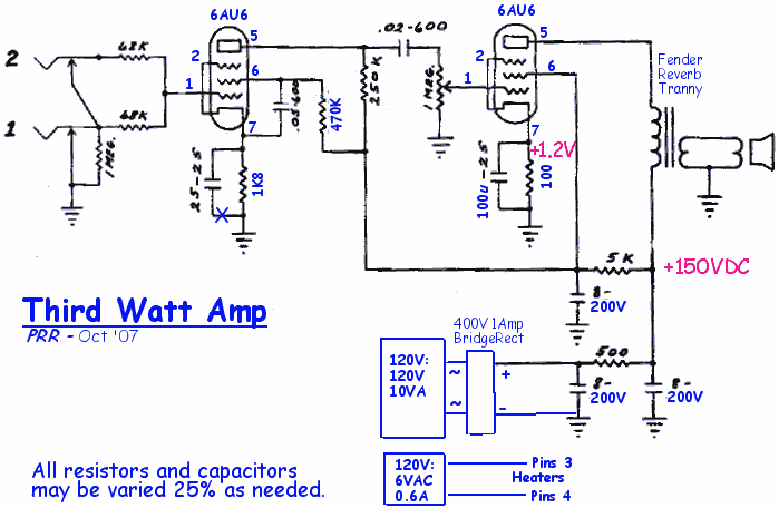

As a random counter-example: a 6AU6 (super-common FM radio tube) can accept a bit over 1V and deliver a whopping 1/3rd Watt in 15k-25k load. Like attached but without that first stage (guitar preamp). Being a naked pentode, damping is nil and THD @ 0.3W may be many %. But hey, one tube from most modern sources to a hot loudspeaker.

As a random counter-example: a 6AU6 ..can accept a bit over 1V and deliver a whopping 1/3rd Watt.... Like attached .....
Darn attachment fell off.
