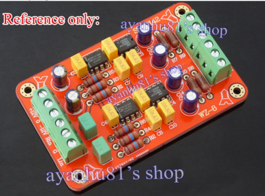

Hey all, building a SSM2142 based Line Driver to convert Unbalanced to Balanced. I have a simple PCB that has input NE5534 Opamp Buffer going into the SSM2142. Couple questions...
1. There is a 1uf cap at input of the NE5534. My unbalanced out preamp is an 6922 / 6H30 Aikido with output caps already - do I need these 1uf caps if I already have the DC blocking caps?
2. The NE5534 is a single opamp and I have some subs - OPA627, OPA637 amoung others...I know these are pretty much not same league as the NE5534, but I have them available...worthwhile to swap?
3. Each output of the SSM4124 is a 33uf bi polar cap - I would think it is worth while to use best cap here since the signal is going thru? I have Silmic II 47uf that I was thinking of trying, or just stack twelve 10uf PP caps there?
Thanks!!

The ssm2142 already has a specified 10k input impedance, presumably to the inverter opamp.
Why do you think you need a Buffer opamp?

The input of the SSM2142 should be driven
directly by an operational amplifier or buffer offering low
source impedance and low noise
Looks like more of a preamp than a buffer, going by the number of resistors (and lack of compensation capacitor). Noninverting, I'd say. And the OP is clearly not the board designer.
Are the resistors the same as on the picture? I don't think 3x 31.6k is particularly realistic or refined, possibly those were just populated for the shot and would be different values on the real board.
You could swap the trusty NE5534s for OPA627 but I don't think it'll make much of a difference. Capacitors seem adequate as-is.

No, I did not design the pcb. Bought it off the 'bay - just pcb - and populating with quality parts now.
If it sounds as good as I am reading, I was going to just drop it into my DIY Aikido Preamp chassis. Hence the reason for asking if I really needed that input cap, and the quality output caps.
Dropping in the OPA627 here seems a bit of a waste perhaps...

Obviously you wouldn't need two coupling caps in series. A jumper in place of the 1µs would do.
Output caps are not likely to ever see much DC and should be either bipolar or low-leakage types. Otherwise long-term performance is hard to predict. Behringer might use standard polars, but that's just because they're cheap.
