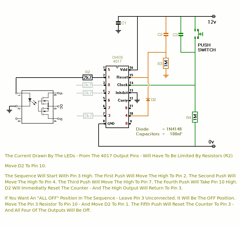

Still kicking this can around. Thinking on momentary contact pushbutton on front panel with LEDs to show input. This SSR : Vishay VO1400AEF. with a logic stepping circuit to turn on/off SSRs. Maybe not a big advantage to mechanical switch, but it would be on the unique side. After all, it's just grownups playing with their toys
Came up with a circuit to control the ssr switching with a single push button. Had help from someone that I came across on line. Didn't take him much longer than a blink to come up with this. He understands these IC's pretty darn good. I am going to build the board up and give it a try by itself and see how it works.
That Vishay chip is an interesting device...

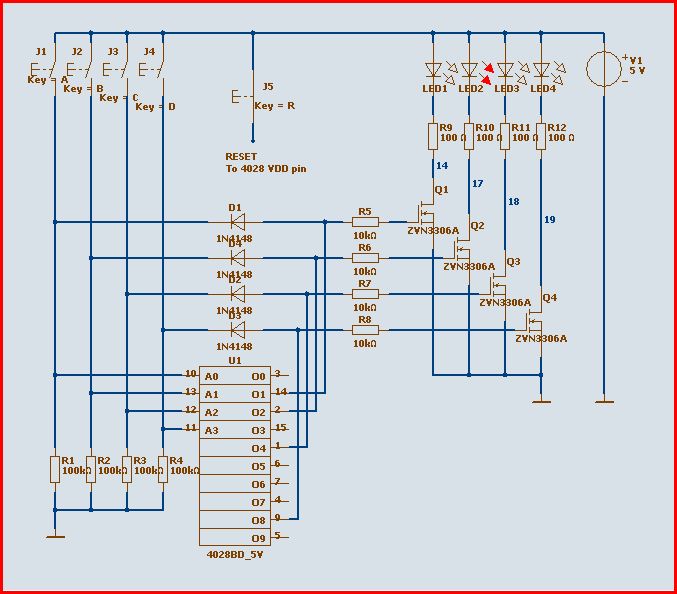

Your 4017 can be elaborated upon to use a momentary button for each data line (meaning you can have a row of buttons on the front panel to select the required input). To do that needs another IC though such as a 4011.
If you buffer the outputs (so no current draw from the 4017) then you can add a simple capacitor backup supply (one cap, one diode) so that the last input selected is remembered. Actually, for your circuit that could be possible without buffering.

Was just thinking that this could be used to control relays also if that is what someone wanted to use. I plan on running an indicator LED to the front panel to show the active source input. I think this shows promise to eliminate one more place where audio signal goes through physical contacts.
Yes it could drive relays. The 2N7000 FET is a great choice to interface CMOS logic to higher current loads.
