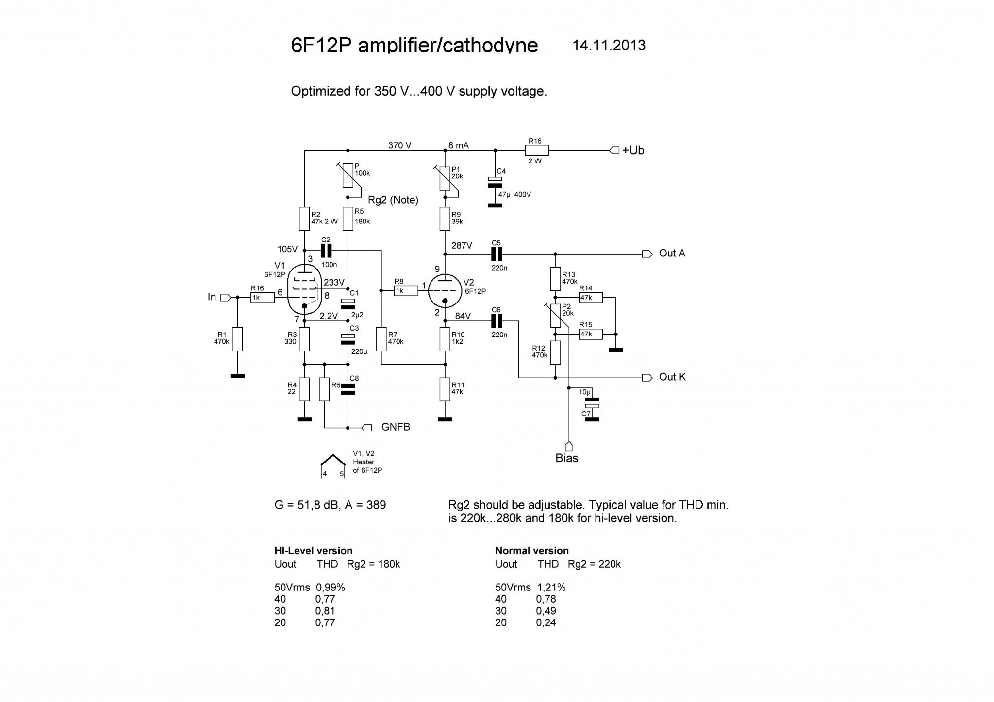

I am not sure if 6F12P is "“generally accepted” to be a substitute for 7199, but for sure the performance of 6F12P is much better and price relatively low.So as of right now in 2022, i’m wondering if there is a “generally accepted” alternative driver section for the ST-70 which uses separate triode and pentode tubes or just triodes?
I have used 6F12P as a voltage amplifier/cathodyne a lot. Attached the schematic of well tested circuit with 6F12P.
And also a version with EL34 UL PP, quite similar to Dynaco ST-70.

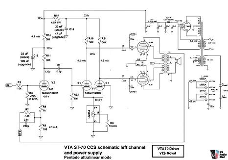

The major changes versus the original Dynaco ST70 that I see are:
1. AC coupling from the input pentode to the concertina splitter.
That makes the amplifier more like a Williamson, correct?
2. No dominant pole series RC network from the pentode plate to ground.
Where is the dominant pole?
3. No capacitor feedback from the "pull" EL34 screen, back to the input tube cathode NFB node.
4. Addition of a 20k potentiometer to balance the DC quiescent current of the EL34 tubes.
5. Addition of a 20k potentiometer to balance the signal currents of the EL34 plates (Any unbalanced transconductance of the EL34 tubes).
A true concertina does not need balancing for itself, but may need to be have different gain, in order to make up for any following stage(s) that are not balanced.
(A Concertina with identical AC load resistors of the cathode and plate are Intrinsically and automatically perfectly balanced, as long as the loads are equal, including the Rk and Rp of the concertina, and also the Rg's of the two EL34 tubes).
The only exception is the condition of any grid current in the concertina.
And grid current of a good tube and a good circuit design that is not overdriven by large sitnals, are essentially zero.
And, if there is any grid current with large signals, the RC coupling from the pentode plate to the concertina grid will cause a bias shift, you do not want that.
6. The particular model of output transformers, original versus a substitute.
Other than that, it looks very much like a Dyna ST70.

I ended up using the K&K Audio driver board for my ST-70. While I like it better, I could have easily lived with the low-gain version of the VTA driver board that I was using prior and that is what I would recommend. Well, that, and a more robust power supply.

I think that DC-coupling between voltage amplifying stage and cathodyne phase splitter is a compromise. Operating point of the cathodyne in case of DC-coupling, is determined by the plate voltage of the amplifying stage. It is better to bias both stages independently. Then voltage amplifier can be biased to most linear operating point and phase splitter to largest headroom of output voltage.1. AC coupling from the input pentode to the concertina splitter.
I think that such RC network is only needed if very high GNFB is used (>20 dB) as is the case with Mullard, Williamson and Dynaco amplifiers.2. No dominant pole series RC network from the pentode plate to ground.
I usually stay below 16...17 dB and have noticed no stability problems. Frequency response and transient response is adjusted by 2k7 and 100p RC-network at NFB loop.
I have not seen this necessary.3. No capacitor feedback from the "pull" EL34 screen, back to the input tube cathode NFB node.
Yes, to compensate un match of output tubes.5. Addition of a 20k potentiometer to balance the signal currents of the EL34 plates (Any unbalanced transconductance of the EL34 tubes).
