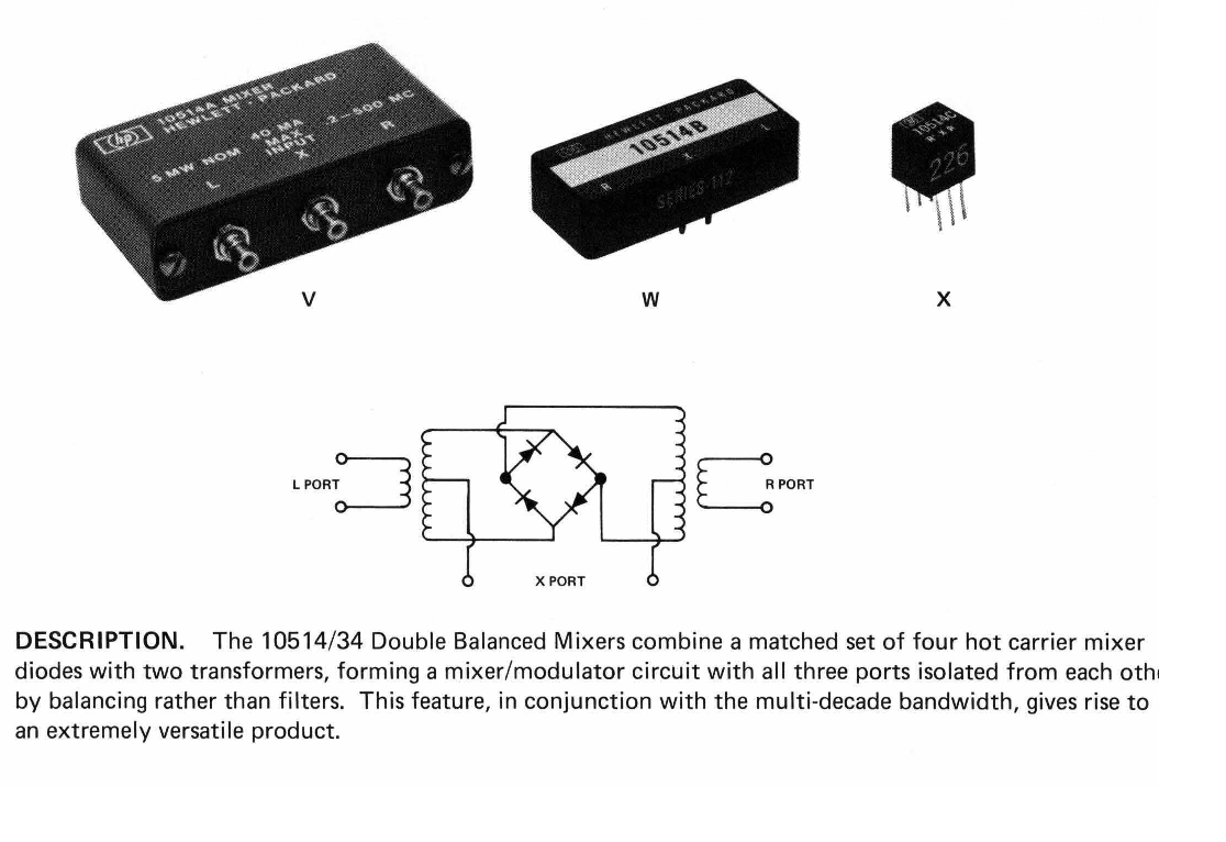

FM Modulator Linearity. (trimmer R52) In this step, I do not have the gear shown in the drawing.
HP 5210a Discriminator
HP 10534a Double Balanced Mixer (50k to 150mHz)
The 5210a discriminator...guessing this gives you the difference between two frequencies ??
I think I can do that with my counters, including phase differences ?
The HP 10534a passive mixer....I have one of these (Clarke Hess "active" mixer) but I'm not sure if will work, or if it has enough bandwidth , I've been looking for it's rare manual.
