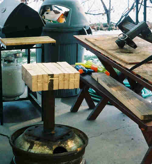

I started out laminating several short pieces of 2x6 together. I didn't have any long clamps but I did have some pony clamps left over from a speaker building project. They work quite well for things like this and they are relatively cheap.
I used polyurathane wood glue because I had some and because these were old pieces of wood that were kind of warped. The polyurathane glue foams up and expands somewhat to fill in oarger gaps.
I didn't take a picture of the glue up phase but here is a shot of the block mounted on a stand that I make from an old disgarded semi wheel. I don't have a workshop so I am somewhat limited but I do have a welder and so I build this pedestal stand out of scrap metal for nothing since I had the scraps laying around.
I finally started building my hand made lens to replace the fresnel between the objective and the LCD. This is kind of an experiment and I want to document what I'm doing here in case anyone else wants to do the same thing.

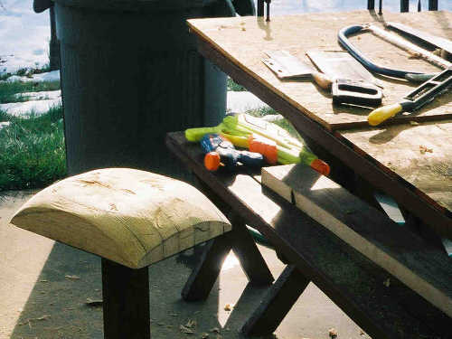

Here is a picture of the block with one contour cut with a chiesel. After the chiesel I cleand it up some more with a medium sized wood plane.
Don't you just love this. I feel like Roy Underhill. Making high tech things with low tech tools is really cool.
I then transferred the profile of the lens onto the sides of the wood block after trimming the block down the 12.5 x 9.5 size. Then I went to work with only hand tools. I first used an old circular saw to remove as much as I could close to the lines. Then I made cuts of varying depths close together making sure not to go too deep past the lens profile.
I then took a 1 1/4 inch wood chiesel and cleans it up the best I could on the long profile which was with the grain of the wood. It is not possible to get this really perfect and that is not the idea. Just as good as I could get it without diggint into the lens area if possible.

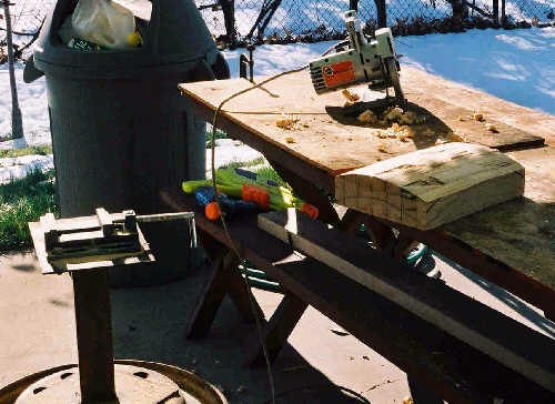

Here is a photo of somewhere along the process.
I then took the saw out and made some cuts that cut off large pieces of material on the ends. I kept doing this until I goe as close as I dared to where I thought the lens sphere would be.
The only reference points I had were the edges and the center of the lens which is the highest point. After taking as much as possible off with both the cirular saw ans a combination of hand saws I then went to a large wood rasp. Most of the rest of the shaping was done with this wood rasp and a little bit with a plane.
After a while I started using the sheet metal curve guide to tell where the high and low spots were. When I got it about as close as I could with the tools I was using I took a orbital radial sander and cleand it up a little.
It is important when doing the rasping and the sanding to take even arcing downstrokes from the center of the lens sloping down to the edges. The short side edges were already very close and so most of the work was on the long side edges.
I walked around the piece taking even strokes making sure not to flattern or take material off from the crown of the lens because it was already at about the right height.
So far everything I have described is about 5 - 6 hours work in two days. When I got the lens curvature about as good as I knoe I could get it then I made a quick sanding and applied some bondo to the gouges that I had made do to a combination of sloppy chieseling and impatience.

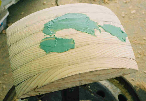

And another photo of how the mold blank looks right now with bondo curing on it.
The mold blank is actually more spherical in shape then this photo makes it look. Because it was 40 degrees outside the bondo wasn't curing very fast so I had to hang it up for the day.
I now have to make a special tool to get the lens mold blank perfectly spherical. That will be done in a few days as I have to get a bottle of dry garnet power or course abrasive powder to make the next tool. Stay tuned for the next part hopefully not too long.
