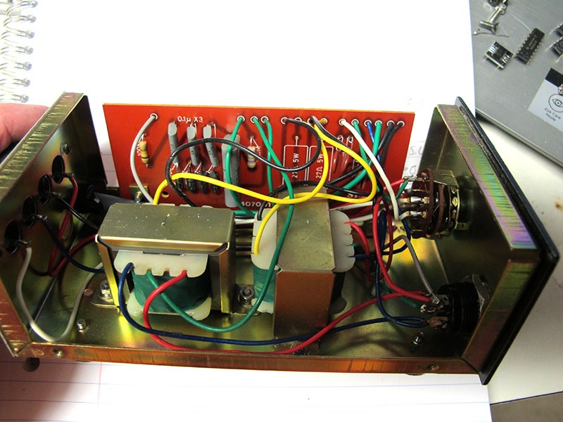

When I decided last year to explore some Stax electrostatic headphones, I discovered that even their older-model headphone amps are jaw-droppingly expensive. So I got an SRD-7 Adaptor and converted it to power high- and normal-bias Stax 'phones. Unfortunately, the sound quality left much to be desired.
The good news is, it's most glaring problems are fairly easily addressed. I just completed these detailed mods for the SRD-7 adaptor:
Transforming the Stax SRD-7
Comments/questions welcome. (This is my first crack at creating web content of this ilk outside of a forum, so be gentle... 🙂 )
Ha! You have a mixed-vintage rig. The SR-X MkIII were concurrent with your Lambdas, no? But the SRD-7 replaced the 6, supposedly with better transformers. So these mods won't directly apply. But if your 6 has a PTH, definitely get rid of it!
Oh dear... that stinks. It looks like the 27R terminating R's are not installed. Odd.

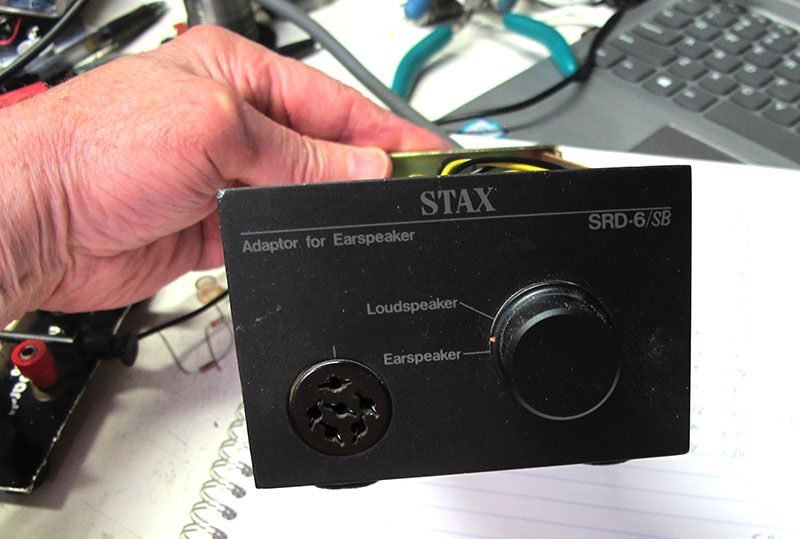

That's an "SB" model... Self-Bias... it gradually builds up the bias voltage from the rectified xfmr output. Clever.

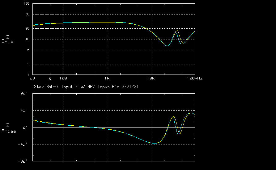

We're thinking the same, drjlo. What you describe factored strongly into making the compensation a "two-stage affair". The output comp circuit flattens the overall slope. This is beneficial in all cases, so it can be permanently installed in the enclosure.
The input RL can then be tailored "to suit" (or bypassed). It does not have to be permanently installed, so a switch is not necessarily needed. One approach is installing them in the power amp with separate output terminals, as I chose to do. Another would be to install them in a plastic junction box that is plugged into the amp output. It doesn't need to be shielded. That would actually be the most flexible. Different ones could be optimized for different model 'phones.

Update: Recent communication with someone doing the mods to their SRD-7 made me take a closer look at the situation regarding the parallel LR circuit at the input. I had perhaps not made it clear enough that this input filter is ONLY needed with the SR-X headphones. This was based on using it in my systems, which do not have any tone controls.
Well, after using it with an integrated amp that has even the simplest bass and treble shelving controls, I can now say that the tone controls do a better job of correcting the SR-X tonal imbalance than the input LR filter does. So the input filter is ONLY needed if there are no tone controls in the system.
This simplifies the mods even more, and removes the objections some might have to a) having an inductor in series with the amp output, and b) making mods to the adaptor that narrow its use to one model of headphone only.
The instructions have been updated to correct for this.

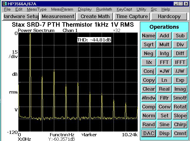

Actually, the most glaring deficiency is the PTH thermistor. It's distortion is almost two orders of magnitude worse than the xfmr.The glaring deficiency is in the transformer.

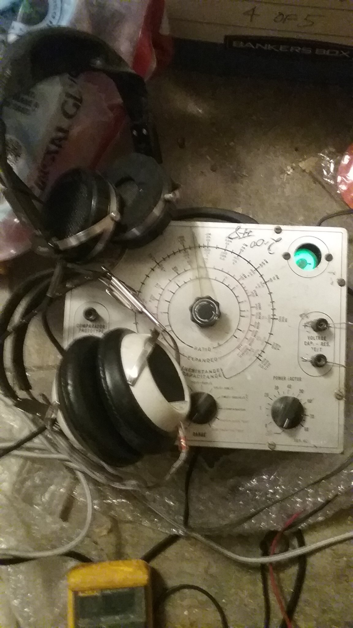

Just measured my SR-3 and SR-X on capacitor bridge. SR-3 is 170 pF. Surprisingly, SR-X is only 44 pF! I guess they improved the SR-X cable big way.

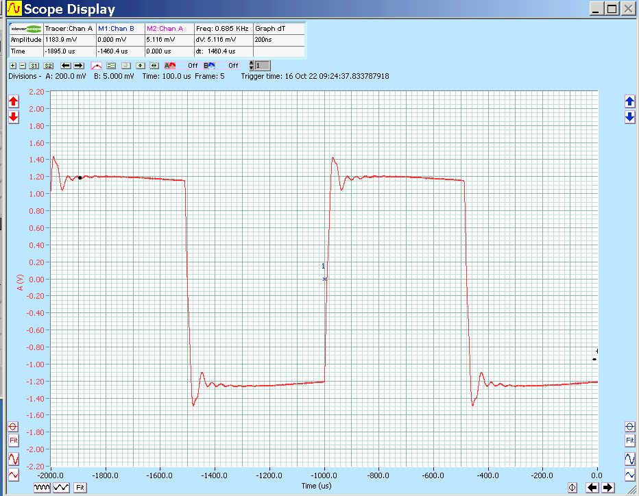

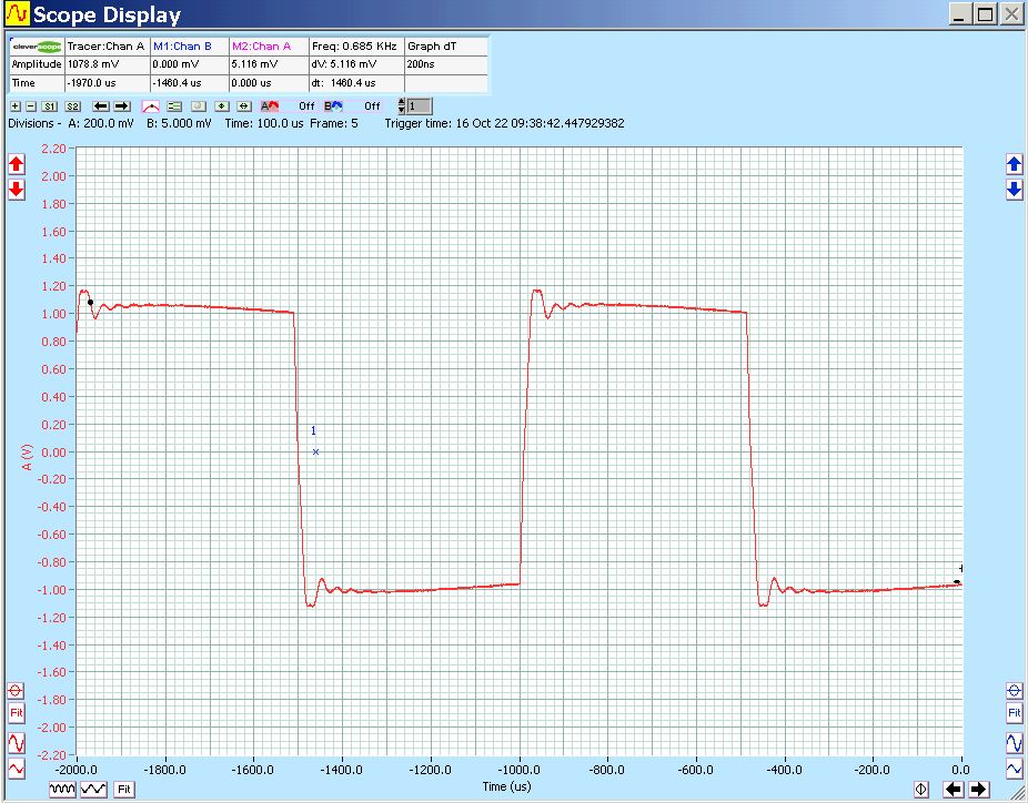

Here are 1kHz square waves through the SRD-7 with 100pF on the 2ndary, along with the 1nF+619kΩ comp that my mod recommends. The results would be even more exaggerated without the comp network.

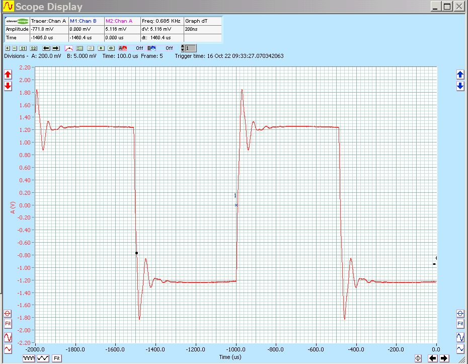

This one is with 2.3Ω source R. Lots of overshoot - nearly 30%..
This one is with the standard 4.7Ω source R. Much better.
And this one is with 5.7Ω source R. A little cleaner, but now it is starting to lose overall level.
I can't recall any transformer I've optimized that didn't behave this way. Lowering the source R below optimum always resulted in more overshoot/resonance.
