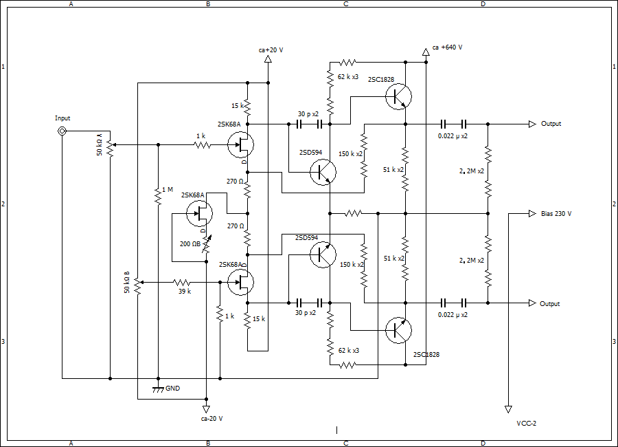

I need schematics of STAX SR-1 neither SR-1 MK2 nor SR-1 MK2 pro. Mine is SR-1 without any suffix. It was released in 1979. Dislike SR-1 MK2 or later brothers, it has JFET differential amplifier followed by 2SD594 amplifier and finally 2SC1828 emitter follower output. I've drawn most of (but not all) of the circuit by inspecting the board, but I wish it confirmed with your help!

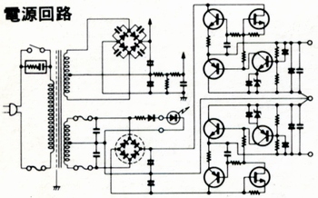

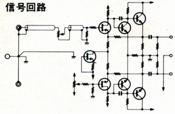

Thanks, chring. These drawings without component values were used in the leaflet of SRM-1 in 1979. I got some but not all values as in the attached diagram. I am not so sure about the values. The designer preferred serial connections of devices, probably considering the high signal voltage. The circuit is much simpler than later versions that use folded cascode amplifiers in order to connect electrostatic headphones without capacitors. But I like the simplicity of SRM-1. Can anyone correct the values?

Thanks, ericj for providing valuable information.

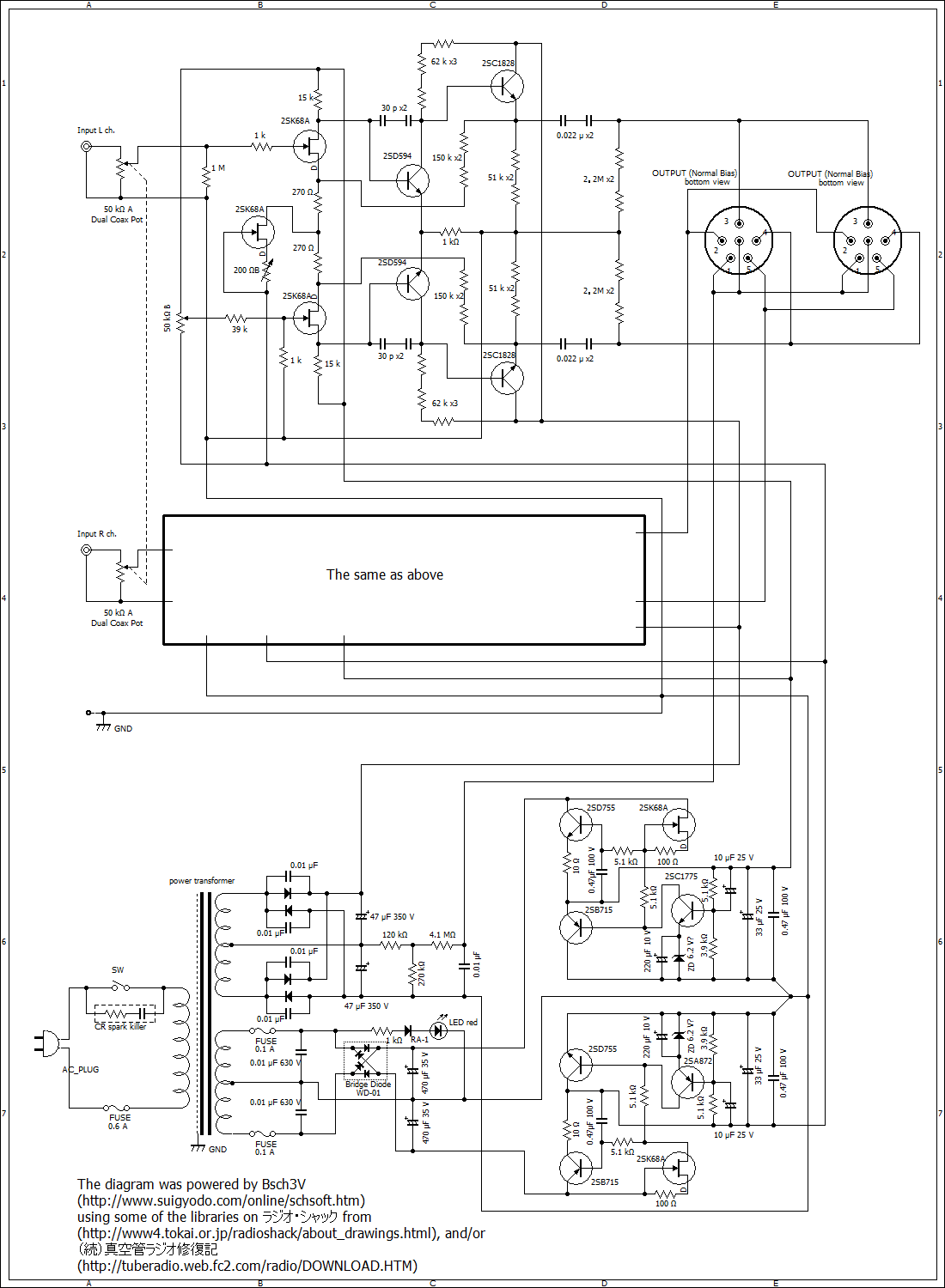

I tried to read color codes of resistors and have drawn tentative schematics. Still it may have some wrong values or wrong connections. Any correction or comments are welcome. It looks very simple. Mine is over 40 years old, but works reliably. I just recapped it. It doesn't have a folded cascode amplifier or a current mirror circuit, but it sounds pretty good.
