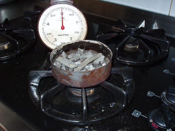

as for the lead, I got a car wax can, were I put the lead inside and on the stove,melting in around 10 minutes and giving a round shape.
Depending on the speaker, you would have to make a few tries in order to find the appropiate weight. So, I made: 1 , 1&1/2, 2 , 2&1/2 pound weights.

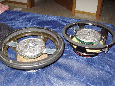

cut the steel the right size in order for it to rest at the border of the speaker basket and screw it down with security nuts in order for them not to go loose with vibration.
DONT BEND THE STEEL DONT BEND STEEL.

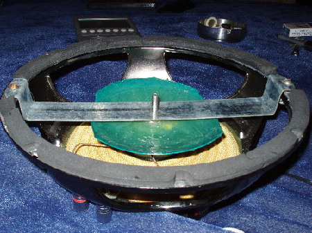

on the article it says :::: Depending on the driver you use, you may have to attach the steel to the basket arms. If you have to do this, bend the ends of the steel up to comform to the angle of the arms. ::::::::
I tried this, and I lost a lot of vibration
Here is a pic but DONT DO THIS

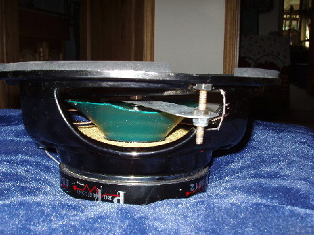

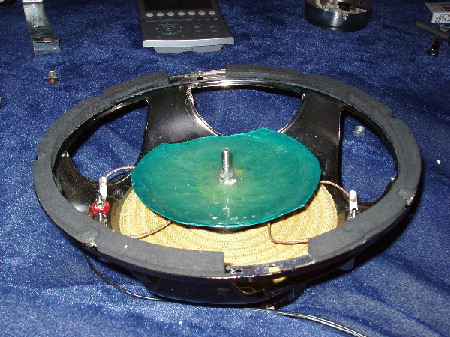

as you can see in the above pic, there is a nut, (in the center of the dust cap) screwed in the bolt just below the steel, and another one on top.
MAKE SURE by pressing the bolt downwards, and perpendiculary, there is NO friction inside the dust cap (if the coil is movig up and down with friction, will eventually burn)
the steel has to be about 3 or 4 milimmeters above the dust cap, wich you can control by screwing or unscrewing the nuts in the center bolt.
MAKE SURE the steel is completely HORIZONTAL

HERE ARE MY TWO SHAKERS, and ïm planning on making 2 more.
