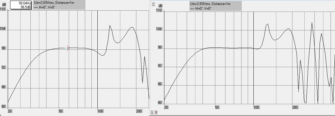

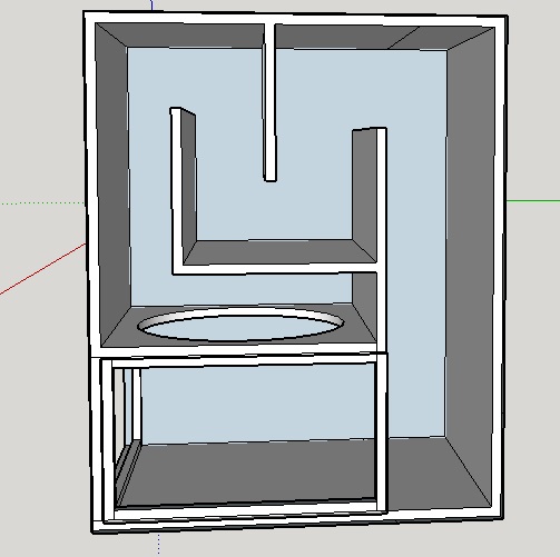

Hi everyone, I made this design, easy to build, it does not contain cuts in angles. Worth it? Thanks.
Akabak script:
System 'stepped 18'
Def_Driver '18g50'
Sd=1320cm2
fs=40Hz
Qes=0.334
Qms=12.05
Vas=212L
Re=6.1ohm
Le=2mH
Driver Def='18g50'
Node=1=0=5=9
Duct 'D1' Node=4=5
SD=650cm2 Len=25cm
Duct 'D2' Node=5=6
SD=650cm2 Len=55cm
Duct 'D3' Node=6=7
SD=920cm2 Len=105,7cm
Duct 'D4' Node=7=8
SD=1000cm2 Len=81cm
Duct 'D5' Node=8=9
SD=1590cm2 Len=25.8cm
Duct 'D6' Node=9=10
SD=1590cm2 Len=27.8cm
Radiator 'R'
Node=10
SD=1590cm2
