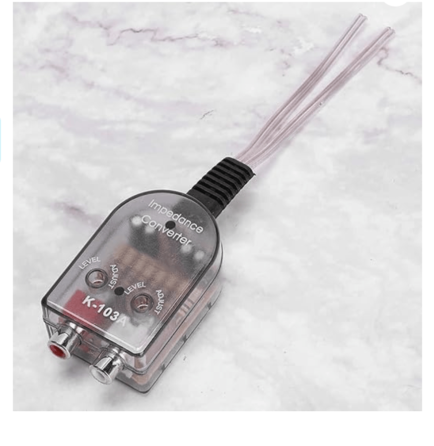

Interesting, there are 6$ resistor level adjusters on Amazon and it says impedance converter on it but I see only resistors - and capacitors:
Would it make an audible difference if we buy some expensive special resistors and use them instead? There are some capacitors on this device too and not sure what they do.
Or a direct series resistor connection to the inner pin of RCAs is what we mean by voltage divider?

But unless connecting the amplifier grounds together cause a ground loop (hum), a pair of resistors is probably the best solution, to avoid distortion and transformer low frequency loss and self-resonance. You could start with 10K in series and 1K Ohms shunt.
