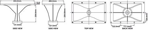

I have Radian 950PBs crossed at 475hz 24db slope in a Goldwood flat front bi-radial horns similar to P-Audio PH-4525 and JBL 2380A horns. These horns are in the center with two 15" Hawthorne Mid-woofers and Low-woofers in D'Appolito arrangement above and below. 950PBs are driven with Wright 3.5 monoblocks modified for .82 watt 45 tubes. Crossover is Marchand XM126 3 way with RCA 12AX7 black plate tubes on pre, high, and mid frequency boards.
I am looking first for others experience with the performance differences between flat front bi-radial horns and circular tractrix or exponential horns. The bi-radial horn closes down slightly before it opens up. I am curious what this does to help or hurt the sound and what the harder edge at the flat front does versus the gentle rounded fronts on the circular horns.
And secondly would like to hear experience and recommendations between the Stereo-Lab spherical/tractrix horns and the Jabo KH-55 modified exponential horn.
And finally recommendations on going with a horn useable frequency(as opposed to cutoff) down right to 475hz (Stereo-Lab cf400)or down lower to 350 (Stereo-Lab cf250 or Jabo KH-55). Does lower useable frequency help integration but maybe hurt high frequencies?
I have decided against expense and complications of going with additional higher frequency driver in 4 way set up.
I aplogize for the many questions and greatly appreciate any insight you can give.

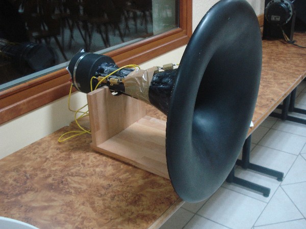

a couple months ago I had a chance to here a 250hz fc stereo-lab horn DIY speaker in Turkey, and Wow! almost blow me away. the sound was some sort like Avantgarde Trio. the CD was Selenium. Radian instead of Selenium is like jumping form a KIA into a Lamborghini so the sound should be far more accurate let's don't forget 950PB is the CD used in La Grande Castine

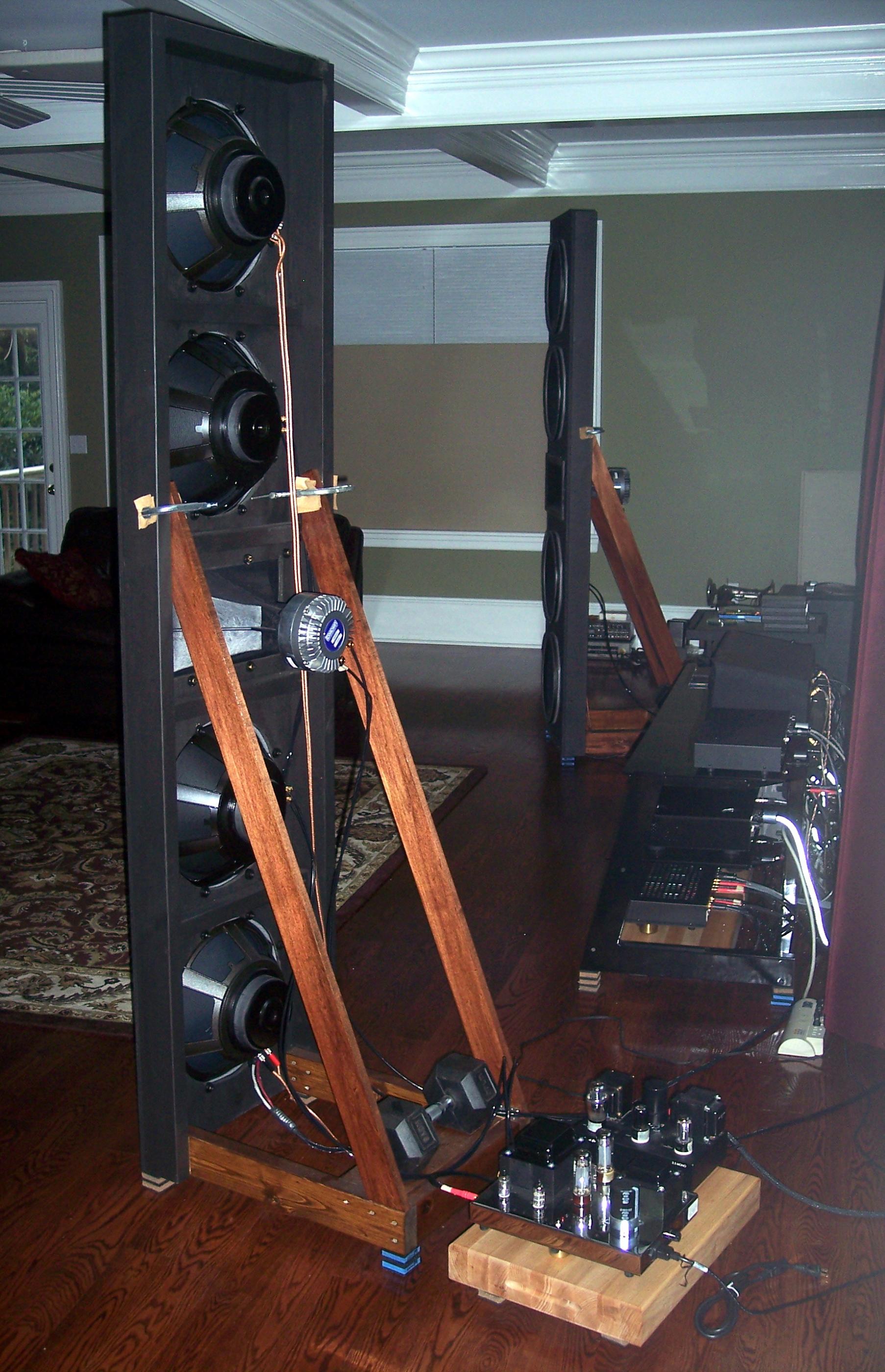

Here are my current speakers. Not pretty but do look much better than the picture. No longer use embarrasing cheap power strip. Idea is to replace CD horn with freestanding horn/compression driver separate of baffle. Crown K-1 drives Hawthorne Audio Augies.
Please see the file below with a comparison of the various horn sizes versus the current baffle arrangemant. I did not know if using a 24db slope would allow use of the JMLC Le Cleac'h 350 horn, which is said to be useable with a crossover to 520hz. I assume that would further limit the dispersion. Do the advantages of the larger horns outweigh disadvantage of overlapping the mid drivers? I also may try crossing the 950PB as low as 350 in the future.
