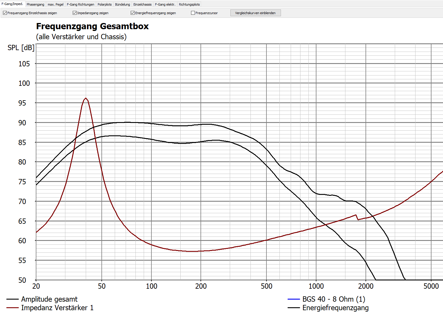

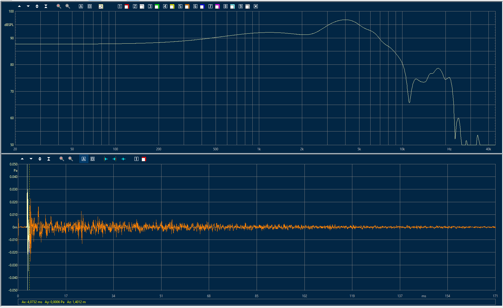

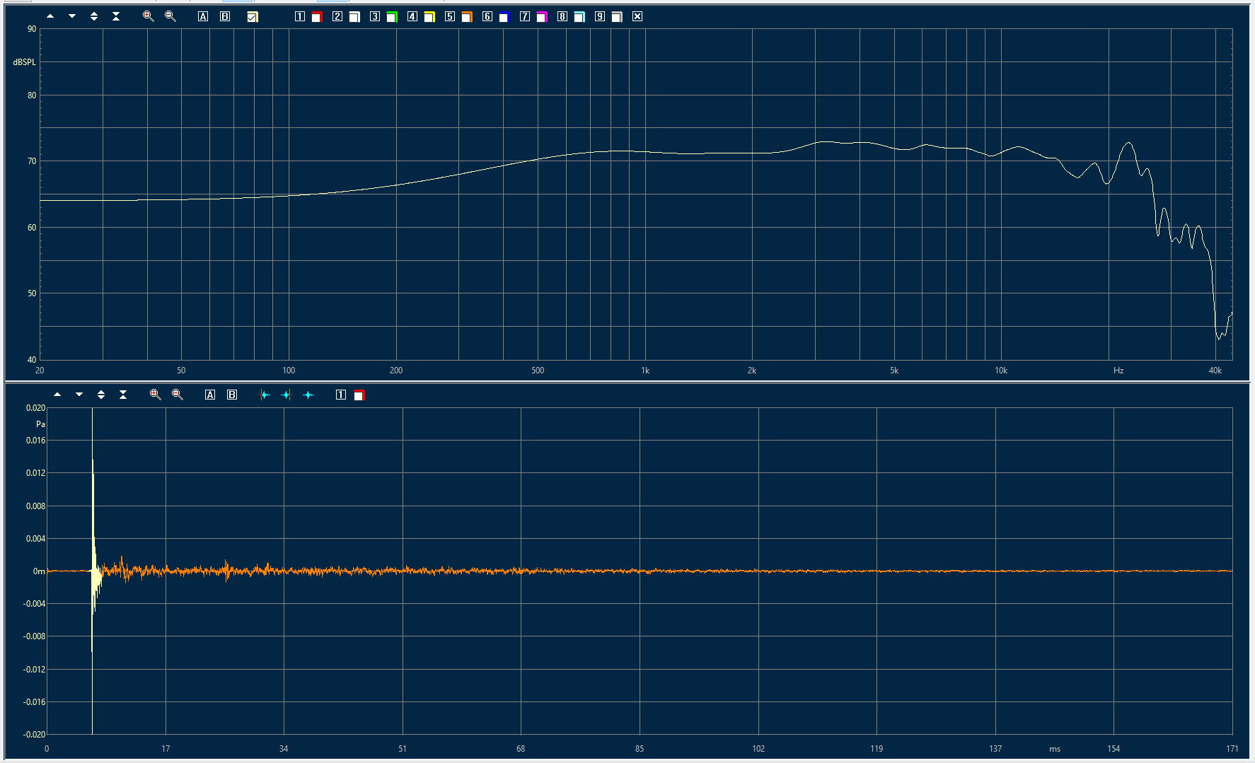

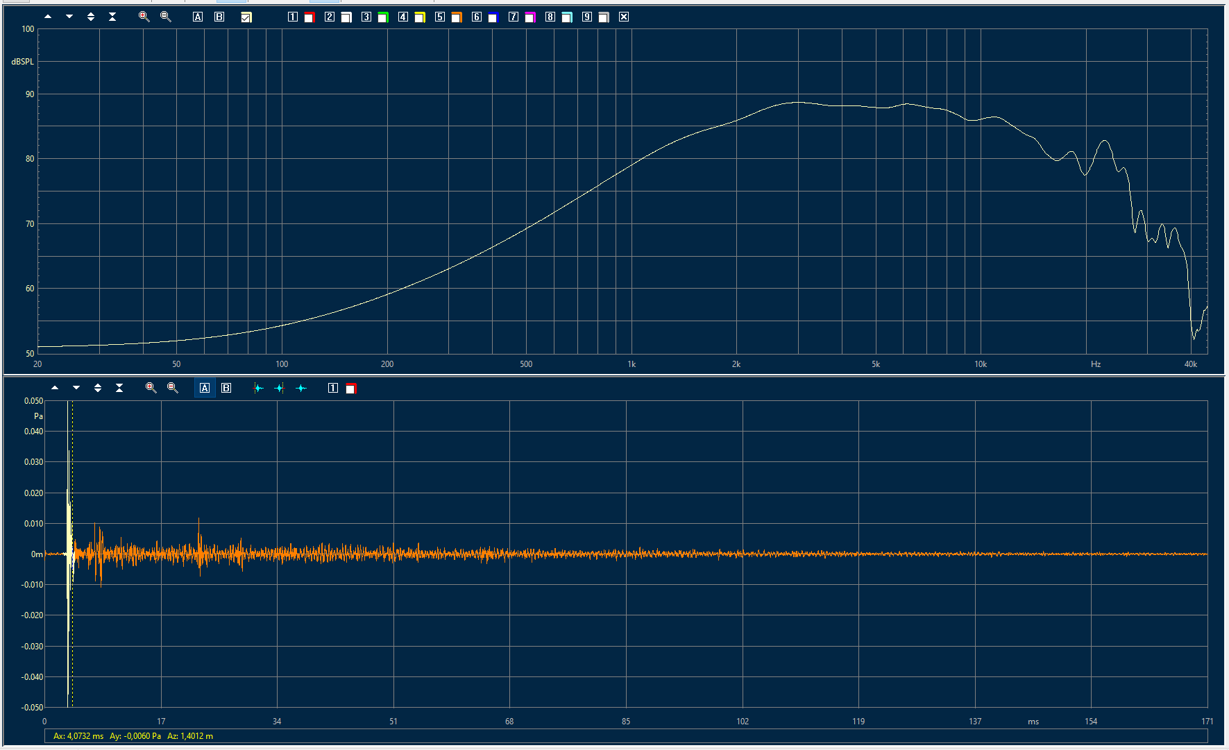

slight PEQ corrections and frequency response with low input level CLIO pocket measurement
frequency response usable above about 300 Hz, the cut off between OB 15 inch and CB 7.5 inch driver
OB PEQ simulated with BoxSim 2.1
