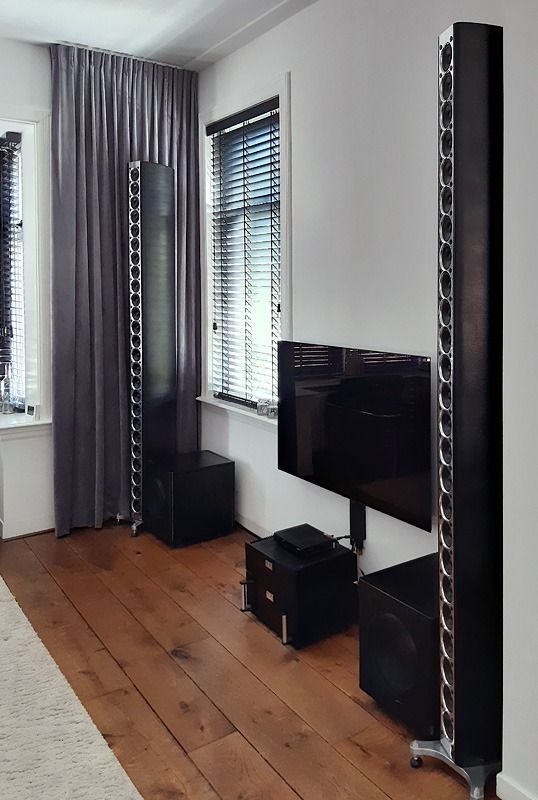

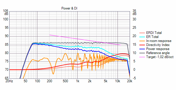

Let's see that in an in-room prediction:
The orange line is the prediction of the in-room response once we add floor and ceiling reflections. It won't be hard to explain which is which I guess...
The array does have a raise in output.
So I'd say it is for different reasons than PA that I went for an array within a living room, although the added potential was very welcome.
Quite often people look at all of those drivers and get the wrong idea. What an array does here is providing more direct sound vs indirect sound.
It may seem crazy, but it's just following the laws of physics.
It makes an array sound clear and detailed, quite contrary to what many will assume.
Not all would want such monsters in their room though... that much I can understand...
One important note I want to make, the vertical parallel planes do cause reflections and I'd advise to use treatment there.
Behind the curtain in that picture above, a big absorbing damping panel is present. And 2 others at first reflection points on
other parallel walls.
