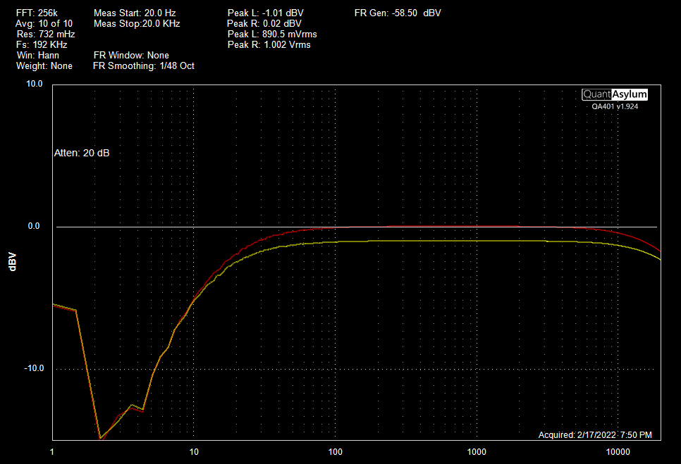

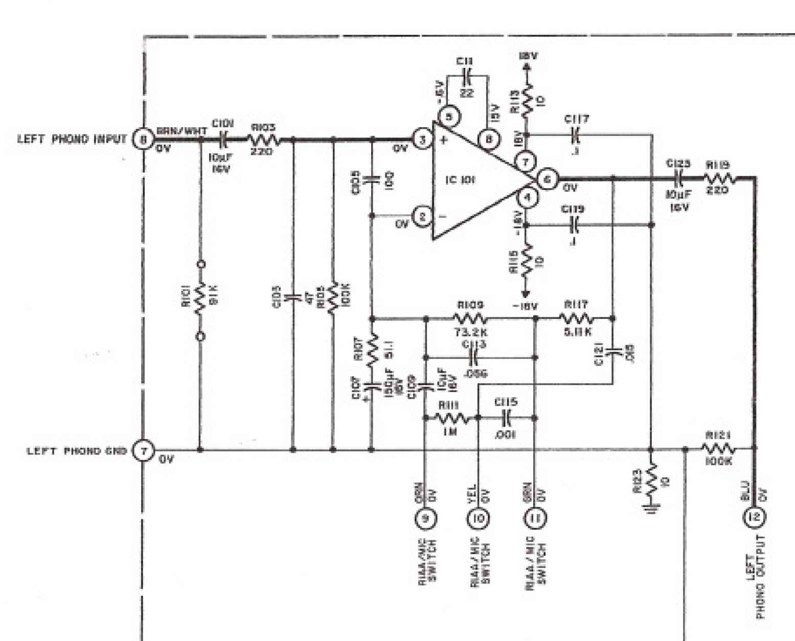

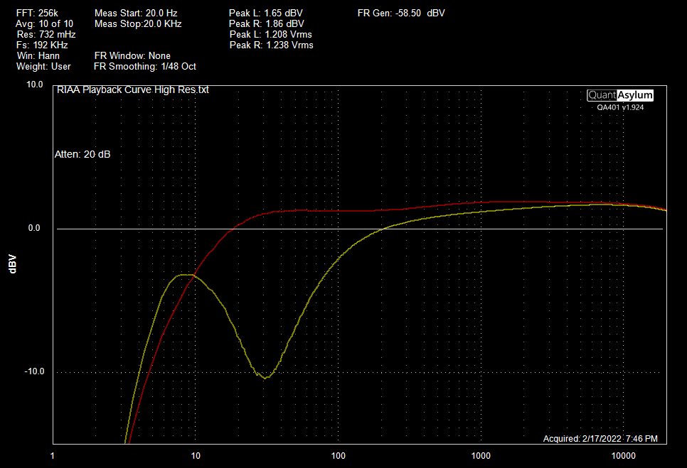

I've got a C29 with odd low frequency rolloff in one channel of the phono stage. In this model the gain stage can be set to phono 1, phono 2, or microphone. I've attached sweeps of all three modes, as well as a drawing. There's a significant dip around 30Hz in one channel but not the other. This dip exists in both phono 1 & 2 but not when set to mic.
Here's what I've done:
Replaced all the electrolytics with good parts, even went so far as to measure the new shunt feedback caps to make sure my new parts are OK.
Replaced the shunt feedback resistors with a hand picked matched pair of 51.1Ω resistors (4 wire ohmmeter).
Opamps are new 5534s, but the old ones showed the same behavior.
I've taken the opamps out of socket and verified the feedback network resistance from pin 6 to pin 2 - channels match.
Rails are fine at +/-18V
What am I missing? Thanks...

Never mind, I got it.
It was a 45 year old bad crimp inside a Molex connector! It's a great honor that it chose me to witness it finally dying 😉
Thats interesting - not sure how that created that particular low frequency wobble in the freq response - I presume somehow a twin-T style parasitic notch-filter was involved?
The external feedback switching was the problem. The rotary source selector switch has a SPDT element to handle this; in mic mode pins 9 & 11 are shorted and in phono mode pins 10 & 11 are shorted. The bad crimp was on the wiper of the switch so in fault mode all 3 pins were open, an undefined state. Working well now.
