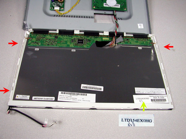

I finally picked up a proview PL576Ws at local Staples for $229. It might not be the best LCD on the market, but I believe it is the best LCD for a DIY HD Projector.
The LCD module used in this monitor is Toshiba Matsushita Display LTD154EX0HG. I found MAG PS576W uses the same module, so I copied spec here:

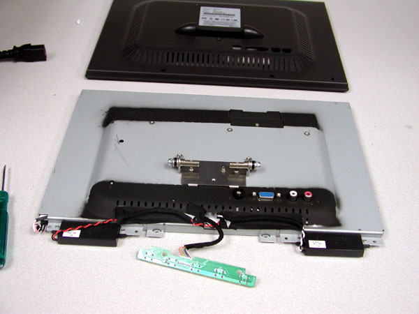

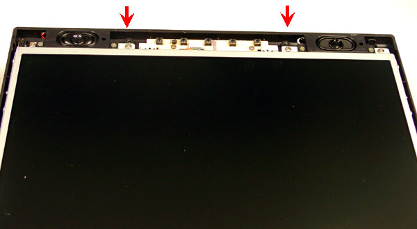

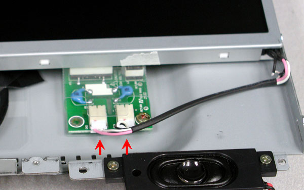

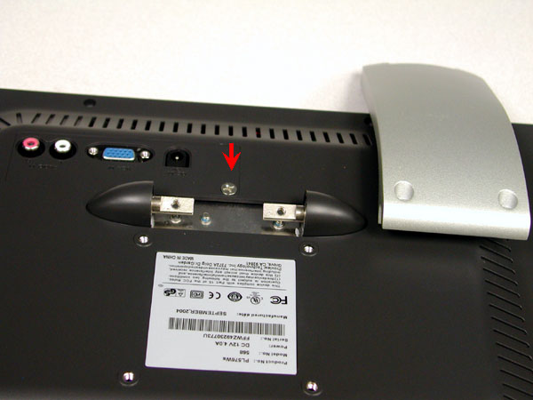

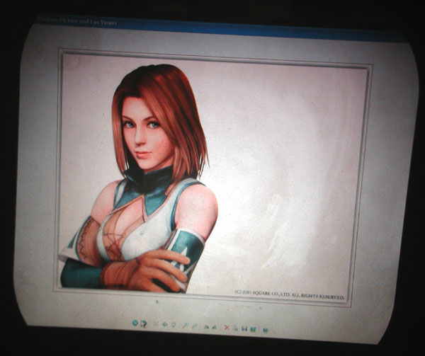

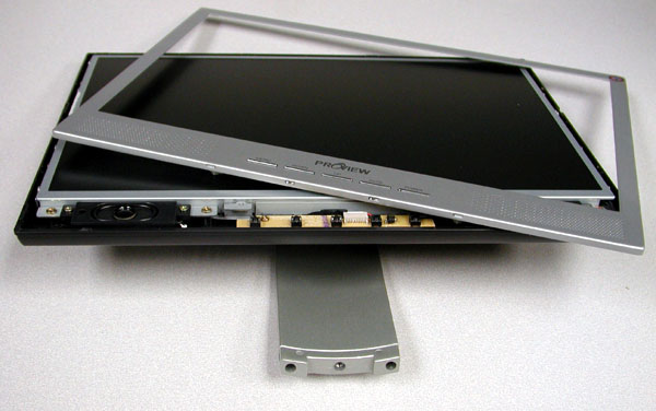

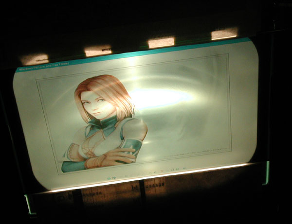

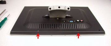

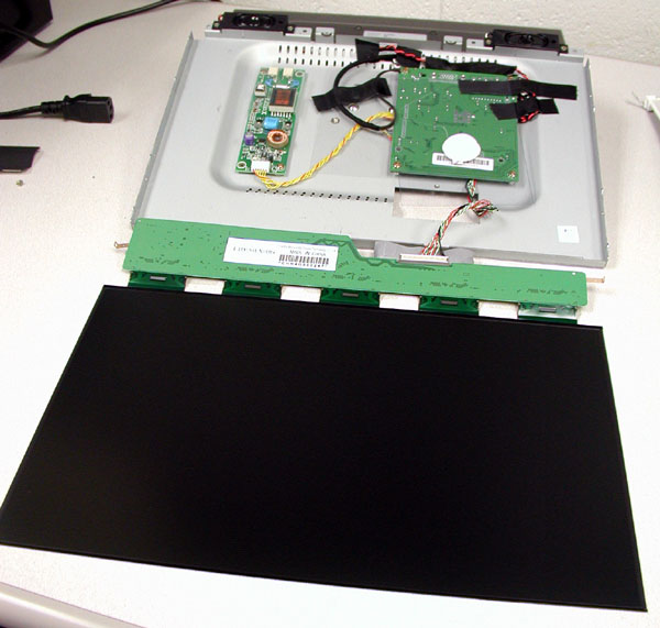

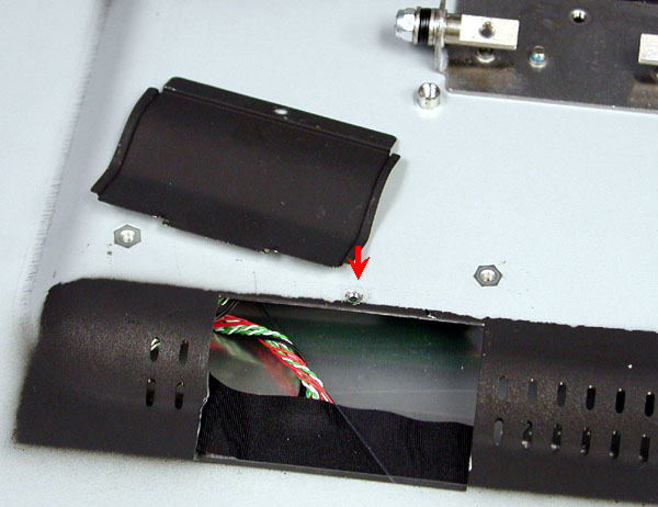

As you can see, this monitor is very easy to strip, and performs well on a medicore OHP. for $229 it is must-have if you want true HD quality.

Not sure if this has been asked yet or not, what are the dimentions of the LCD once stripped?

i allready have a proview PL-576Ws almost a year now and it performs realy well with a HQI-TS 400W D and an 18" beseller with 550mm fresnel.

I thing that after the 1920 X 1200 15.4" tft this one is the next best for diy projection as it strips dead easily and it performs very well.The only thing that i noticed is that by removing the antiglare film it does not become more transparent and it has image reflecting problems even with an antireflect coated projection lens.
