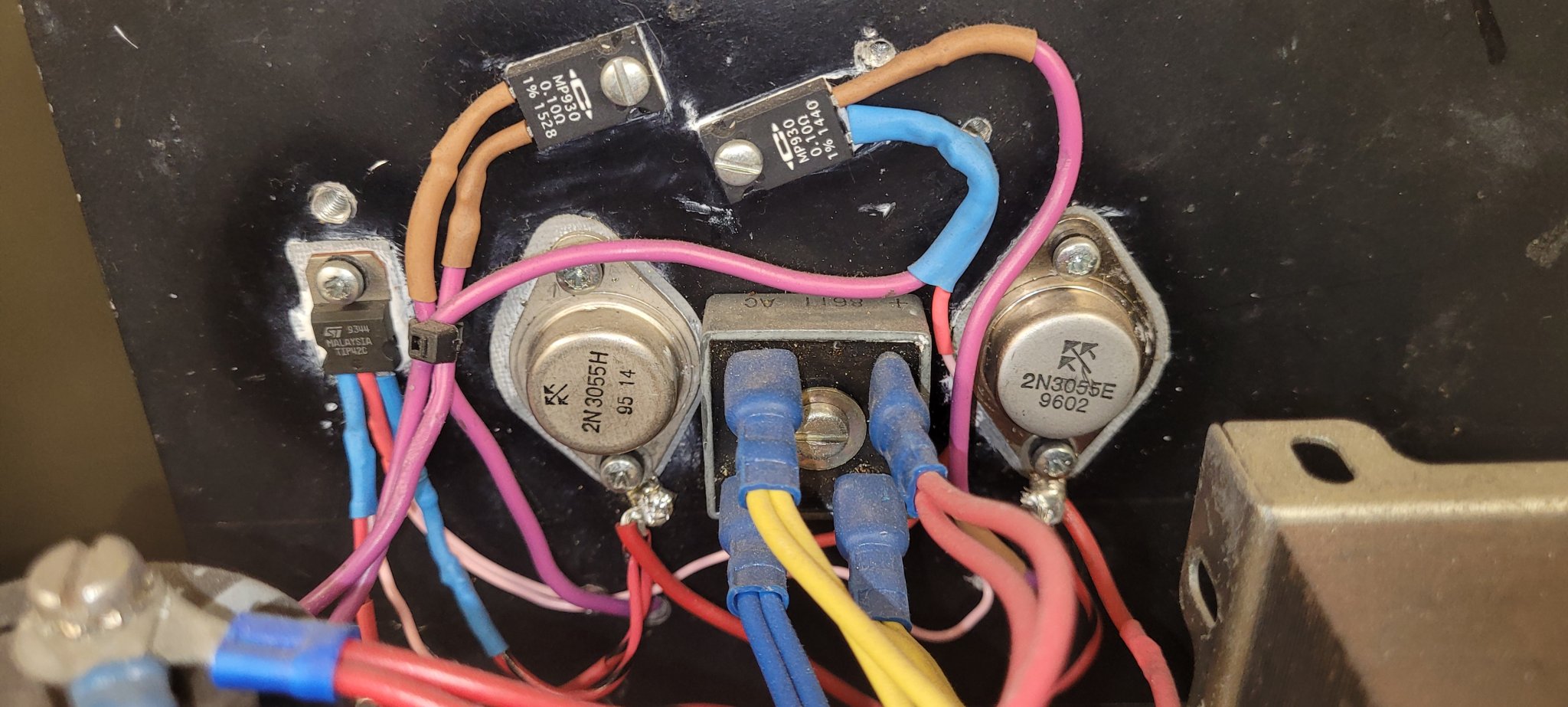

I have a small box full of fake unreliable 2N3055 which I amassed along years , unusable in an amp but perfect for these lowly chores.

Generally it is advised that for measuring 1s, 10s of milliOhms, 10A constant current is applied.
There are very good reasons for this, as detailed in the relevant BS/EN standard (60034.2 if I recall)
100mOhm, and the current should be 1 A

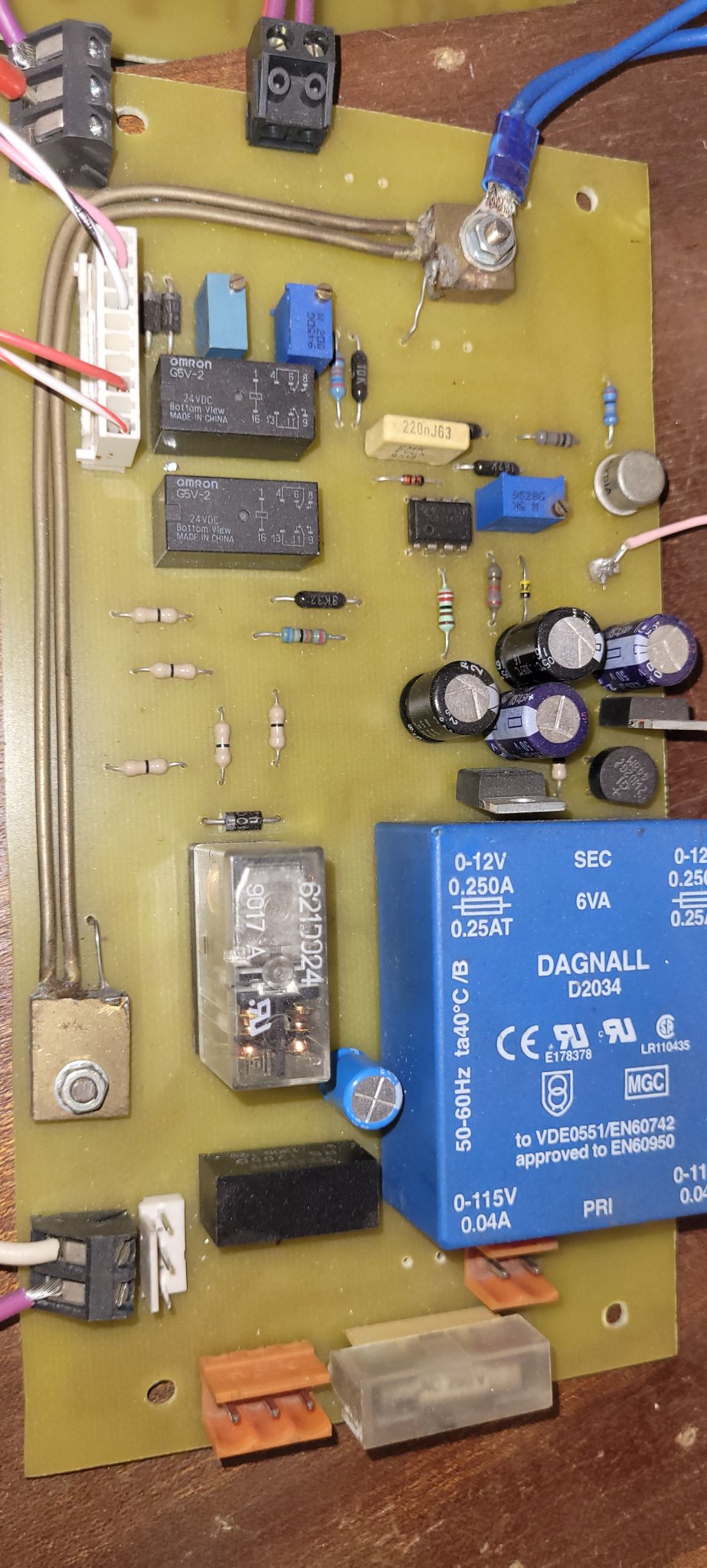

I have both of the HP instruments mentioned above 4328A and 4329A. The 4328 uses AC for the measurement so thermocouple effects won't degrade the measurements. Its quite sophisticated looking only at the resistive part of the impedance. Not simple to make.

In fact, we regularly test the armature reistance of megawatt scale DC machines, at circa 500A or more, in exactly the same way, dictated by BS EN standards 🤔
in that case, there is a real heating that can occur, so speed of measurement is key
