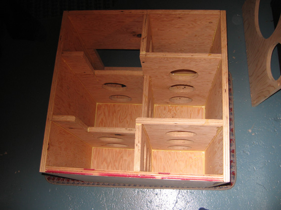

And this is precisely why I thought that the displacement and interior volume would have an effect on how much bracing is required. If you have high displacement in a small volume, the pressures involved should be higher.BassAwdyO said:The interior of the enclosure is a pressure chamber. Flexing in the walls with comprimise some of the pressure.
I'm also at the stage of bracing my box, and it's really difficult to get a handle on how much is needed, without doing more than necessary.
"With vibration analysis (to determine flex, elasticity, rigidity, etc), you could determine the bracing needed to constrain to your individual specifications. Anyone want to volunteer to do some research??"
It's your lucky day

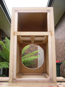

A few months ago I did FEA (finite element analysis) of a 16 cu ft sealed box made from 3/4" plywood, for a pair of Avalanche 18 drivers.
I was thinking along the same lines as BassAwdyO, that there's a lot of overbuilding of sub boxes for the reasons he stated.
I was hoping to satisfy myself that an unbraced box would be fine.
At xmax, the internal air prssure is 0.32 psi (as an interesting aside, this means the driver is exerting 60 lb of force). I applied this pressure load on all the panels, and calculated the panel Vd from the area times the average displacement (fortunately the s/w makes this easy).
This gives panel output of about -25 dB relative to the drivers'.
The max panel displacement was about 0.012". This is easily felt and would no doubt cause people to pronounce it poorly constructed.
I decided to crossbrace for a couple of reasons.
I wanted the first mode to be higher, IIRC it was about 140 Hz.
While well above 80 Hz, XO's are not brickwall, and even an octave above resonance the amplification factor is 2 for the normal range of damping of mechanical systems (meaning the panel deflection is double what it would be for static pressure).
