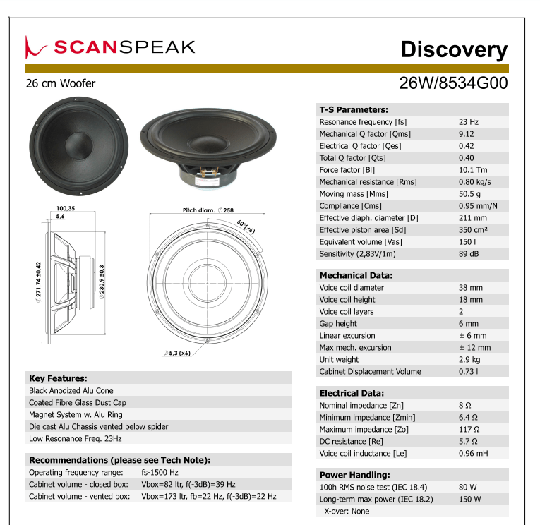

I cross a 10" Scanspeak 26W8534G00 subwoofer at 250Hz in one build and it even can go higher if i want (untill 500Hz). But not all can do that. It really depends on the driver and it's specs.

While these are not hard and fast rules. They are an indicator of what the driver was designed for. With an MMS of 50g and CMS of 0.95. I would say that Scanspeak falls under the hifi woofers category

On the ScanSpeak website the 26W/8534 is listed as a woofer, not a sub. I have a pair of the 4 ohm version, which I use up to 600 Hz. Definitely woofer territory, surely.

the Scanspeak can play both roles, that is true, but saying it's not a subwoofer is ******** i think, it's both a woofer and subwoofer in one driver. And what the marketing talk on their website says is very irrelevant, i look at specs, not at marketing talk. It's a driver made the oldskool way, when the bass driver (like they said it then) covers woofer and subwoofer territory.

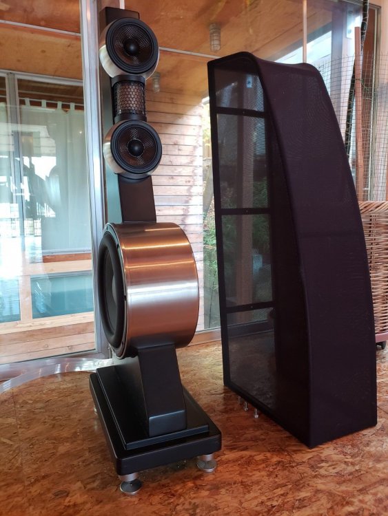

Regarding definitions, surely normal usage is roughly as follows: 'woofer' refers to a driver within a multiway loudspeaker, covering the low frequency range. And 'subwoofer' refers to a separate enclosure, often with its own amplifier and crossover, designed to supplement a multiway or single-driver loudspeaker, covering the lowest frequencies. Whether any particular driver should be described as a woofer or a subwoofer driver is really a question of how it tends to be used - within a multiway speaker, or as a driver in a separate subwoofer unit. Of course, there may be drivers suited to both types of use. (And there may be occasional cases where you might says that a speaker has a built in subwoofer - the Gallo in the photo above could be described that way, I guess.)

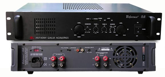

The Gallo comes with a pretty nice separate active low octave amplifier. More or less what I currently use on my two channel subs. At lower volumes only. I would certainly describe all of the above as subwoofers. The vacum cleaner drowns everything out but the subs. My neighbor doesn't like them much either. I try to oblige the nurse her sleep.
