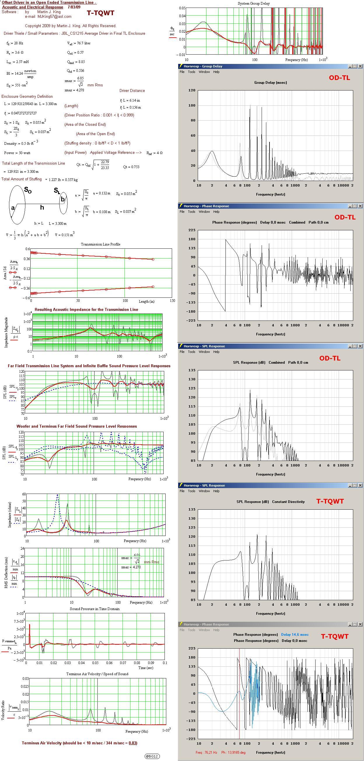

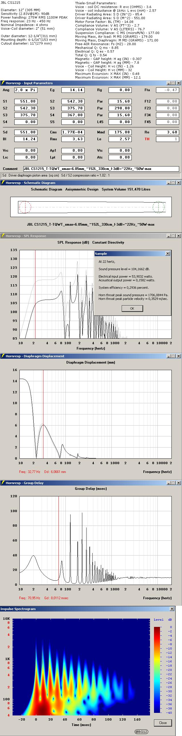

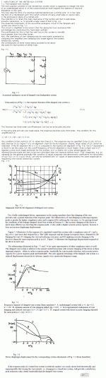

Hi elango87,
When Qts is larger than 0.5 you need to damp the entire box system
if the sub is to perform well and if the port is long you might run into pipe resonances.
Damed vent: The first of pictures:
Pipes:
http://documents.jordan-usa.com/Famous-Articles/Augspurger-Loudspeakers-on-Damped-Pipes.pdf
IMO better designs using the driver: The following pictures:
b🙂

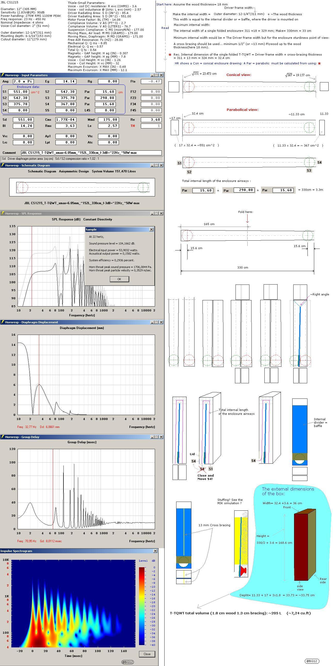

..the technical details you have provided are greek and latin to me. I couldnt understand anything :'(...
Hi elango87,
😕 😱 Are you familiar with home-made Sanskrit-pixel drawings ?
Here is an attempt:
b🙂
